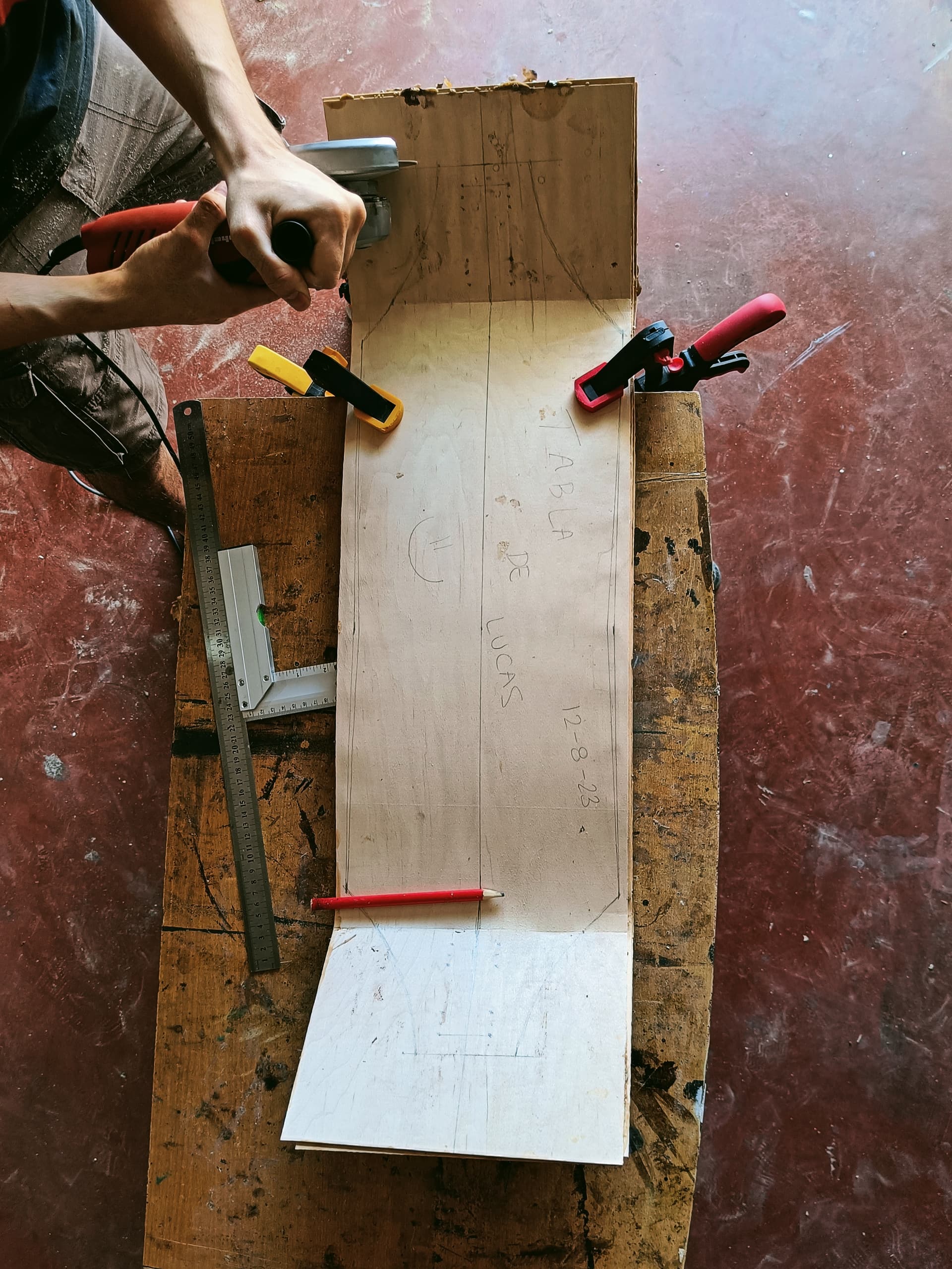

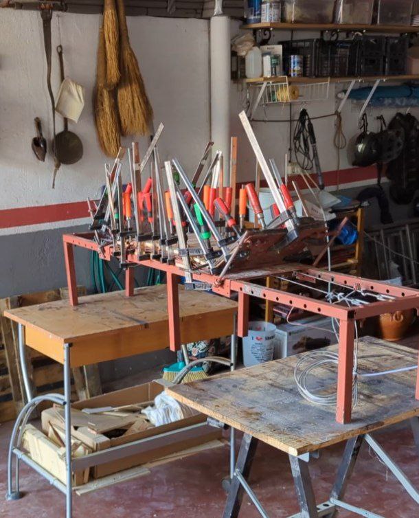

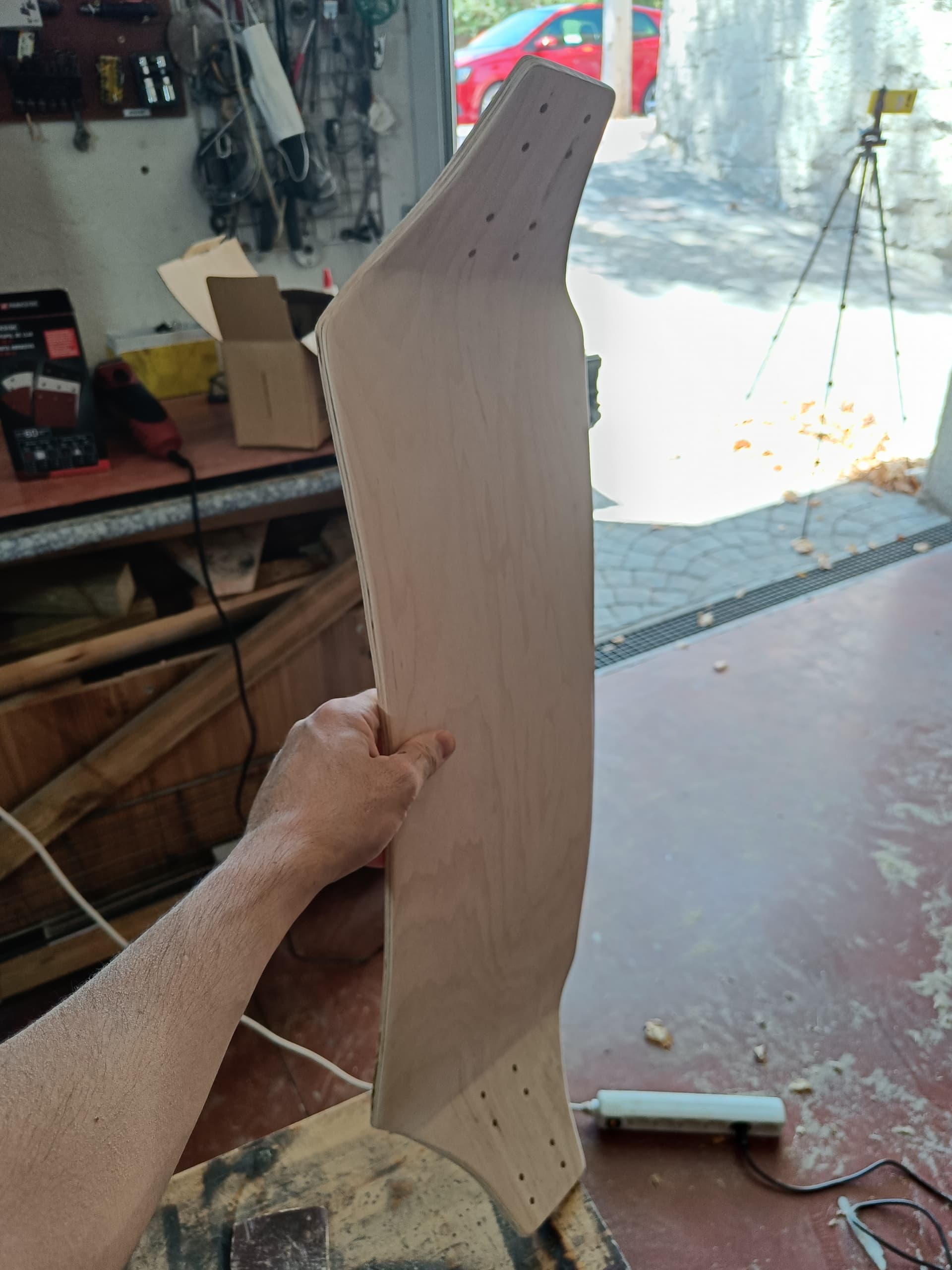

The project started a few months ago, as these things usually go: Roarokit veneers, Titebond III and our modular mold with several sections removed to make it somewhat manageable size-wise:

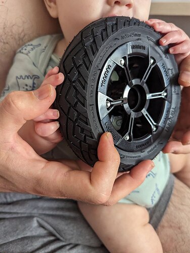

Since he’s a spoiled little baby, he’s getting the good wheels. They even taste good:

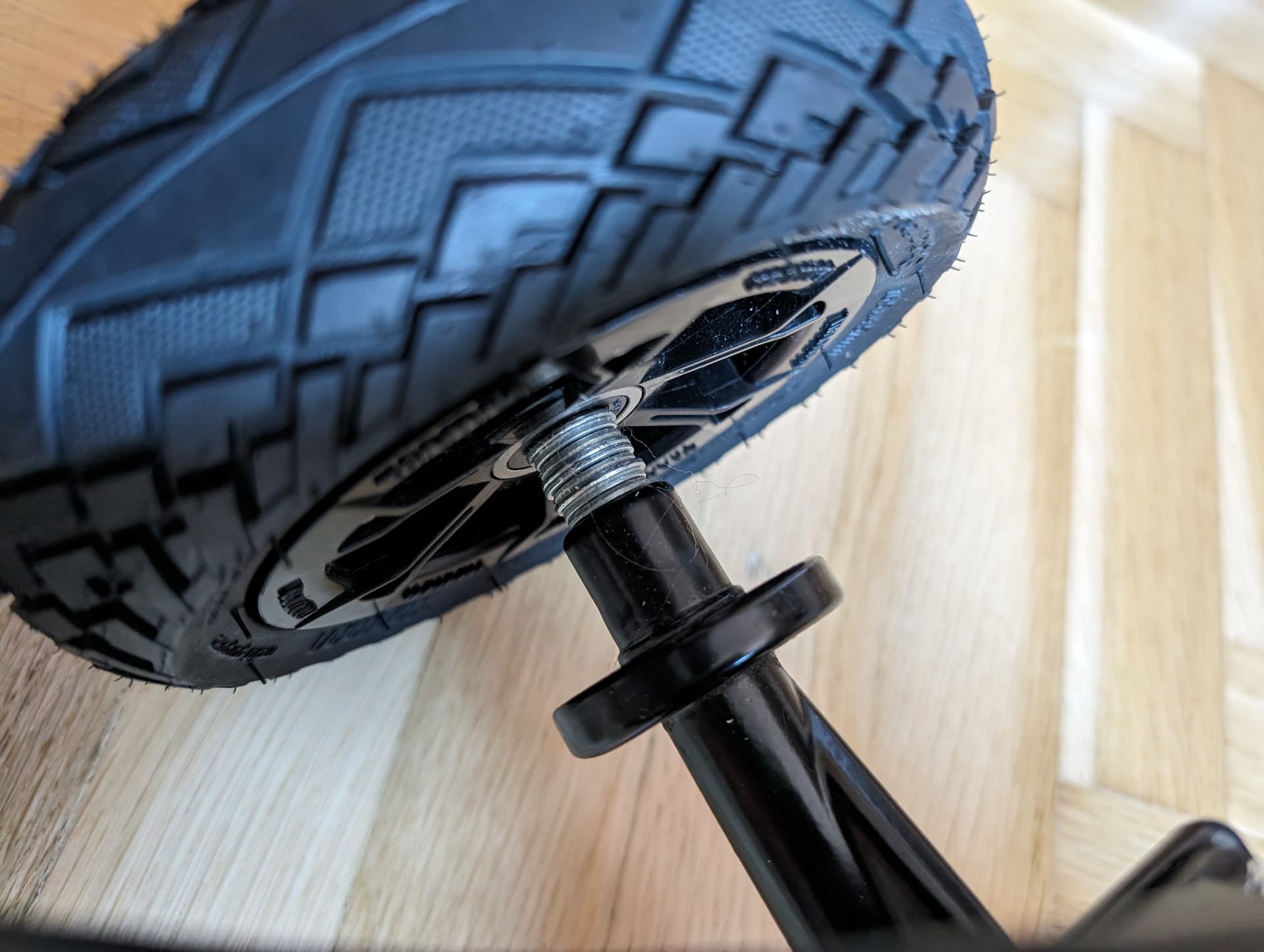

Steering with springs or barrels while weighting around 10kg is pretty hard according to him (he’s whiny like that) so as a first attempt I’m using some old DKP trucks converted to TKP + some risers. In order for the HYPA hubs to fit, dad had to get creative with an angle grinder, two different size of bearings and a bunch of spacers:
I hope that in the future he gets over his skill issue and is able to handle real channel trucks. sigh

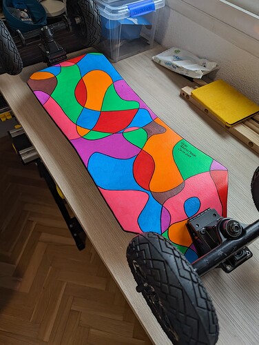

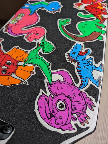

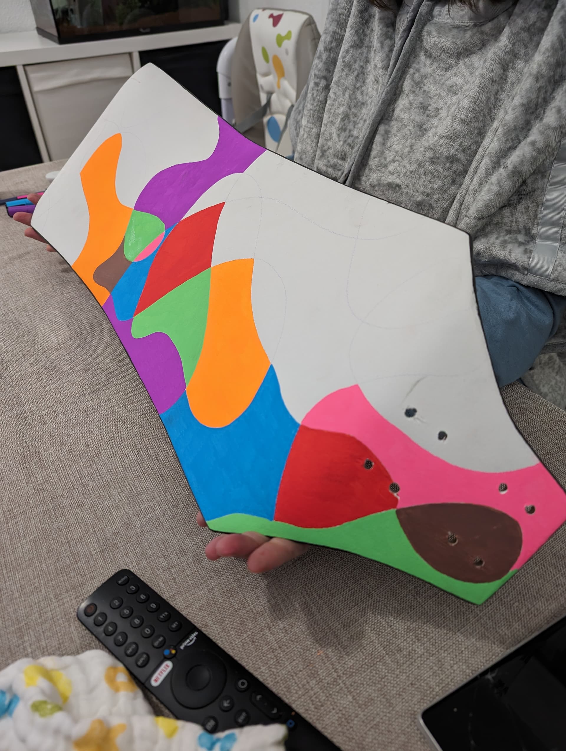

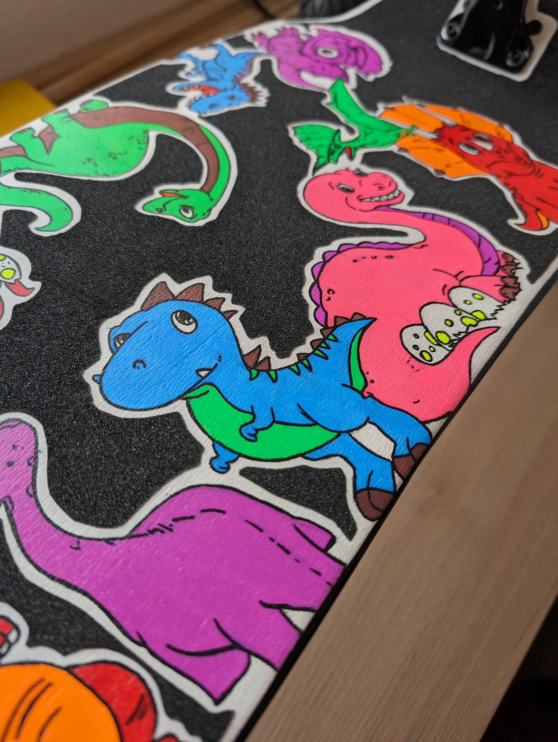

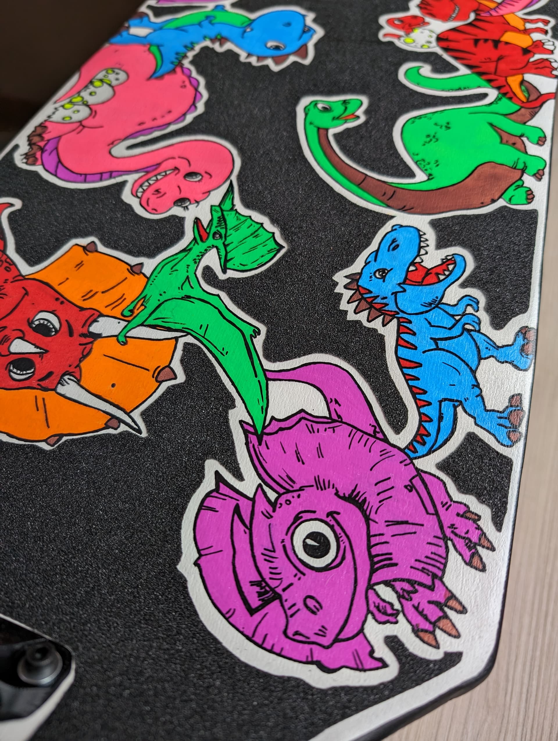

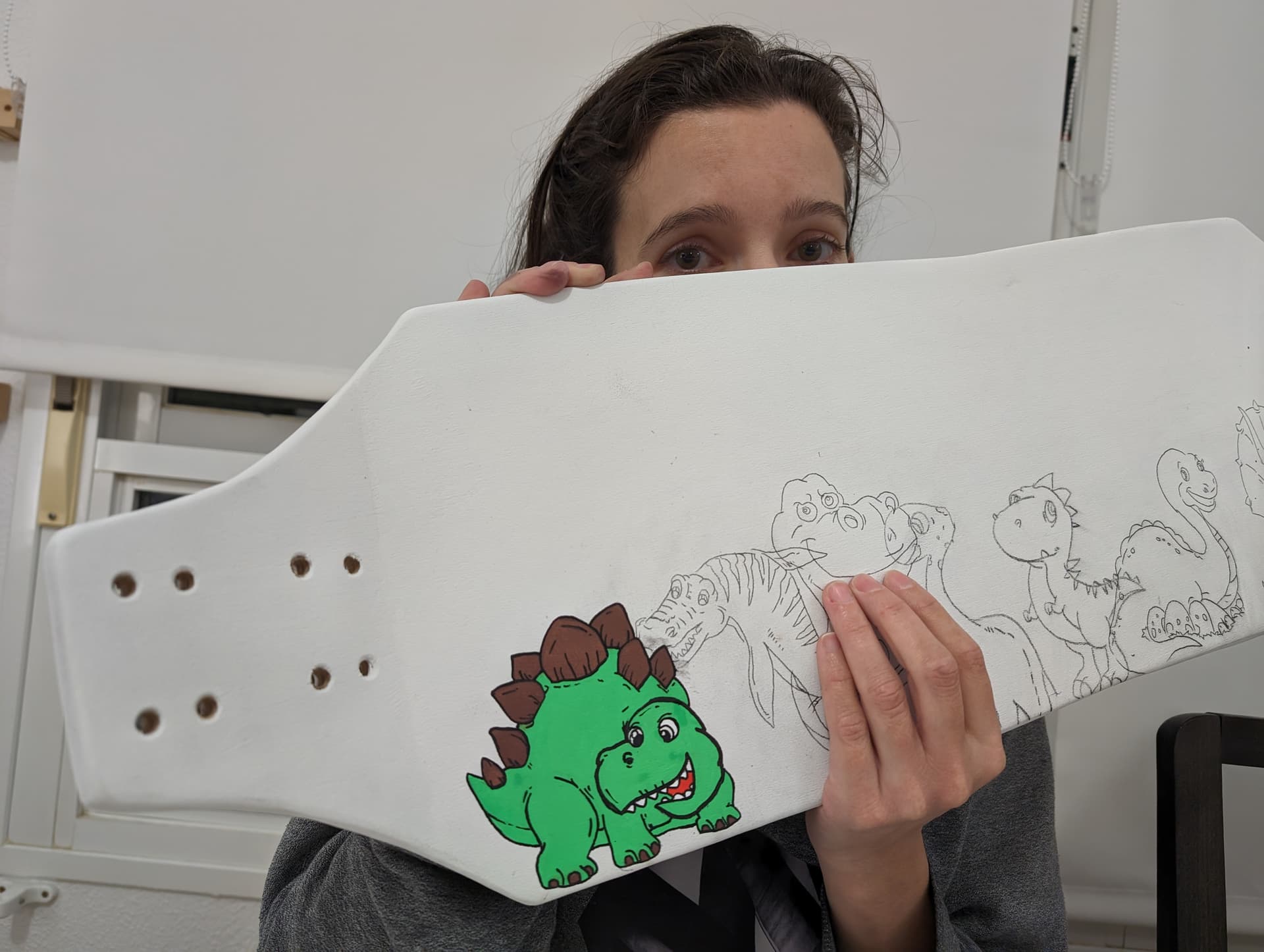

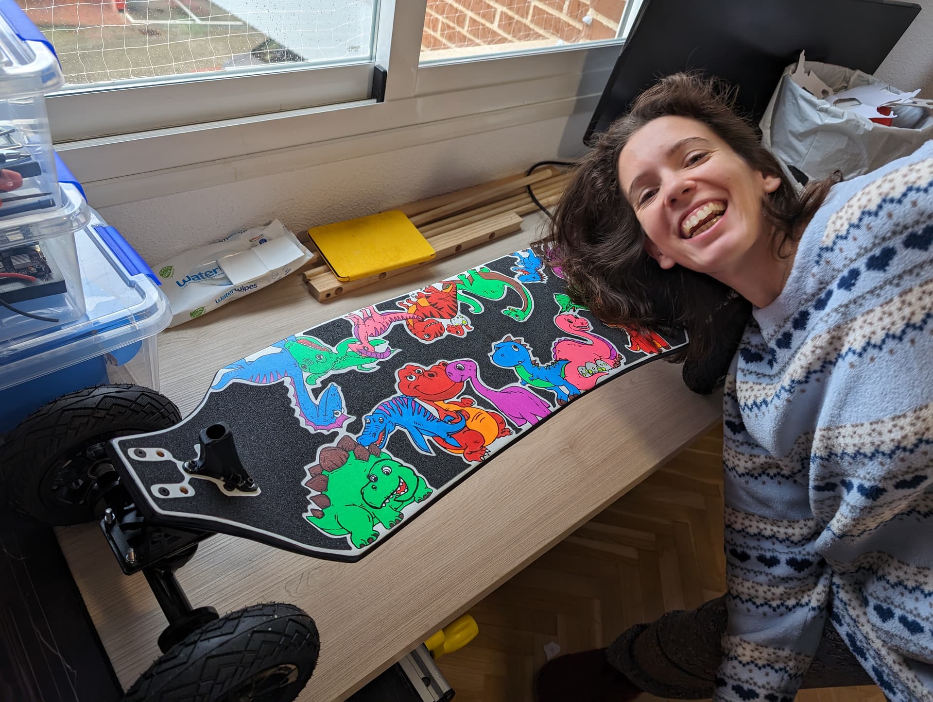

As I am ABSOLUTELY incapable of producing anything remotely artistic, mom to the rescue with the deck art! Spoiler alert: she absolutely NAILED it:

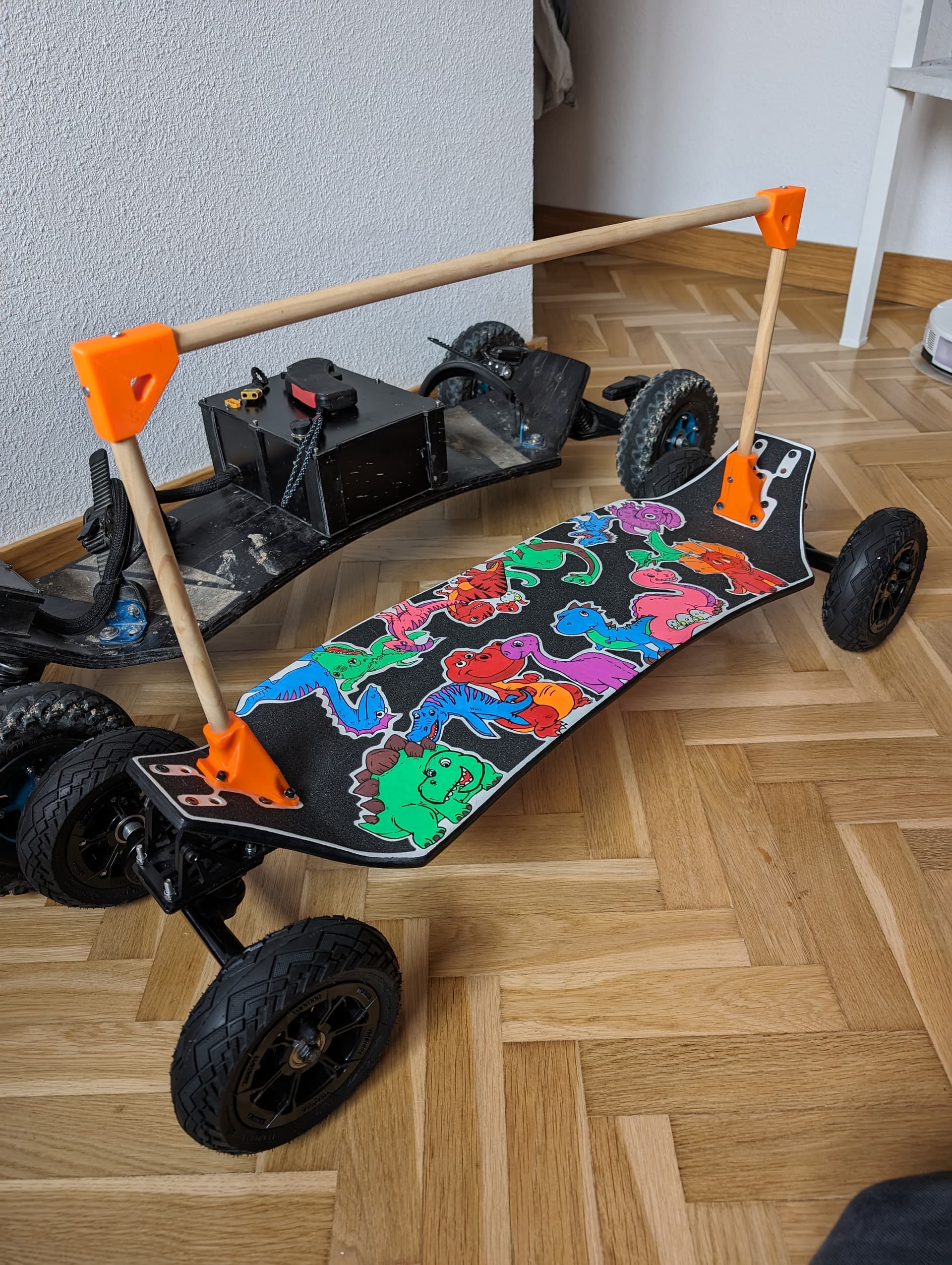

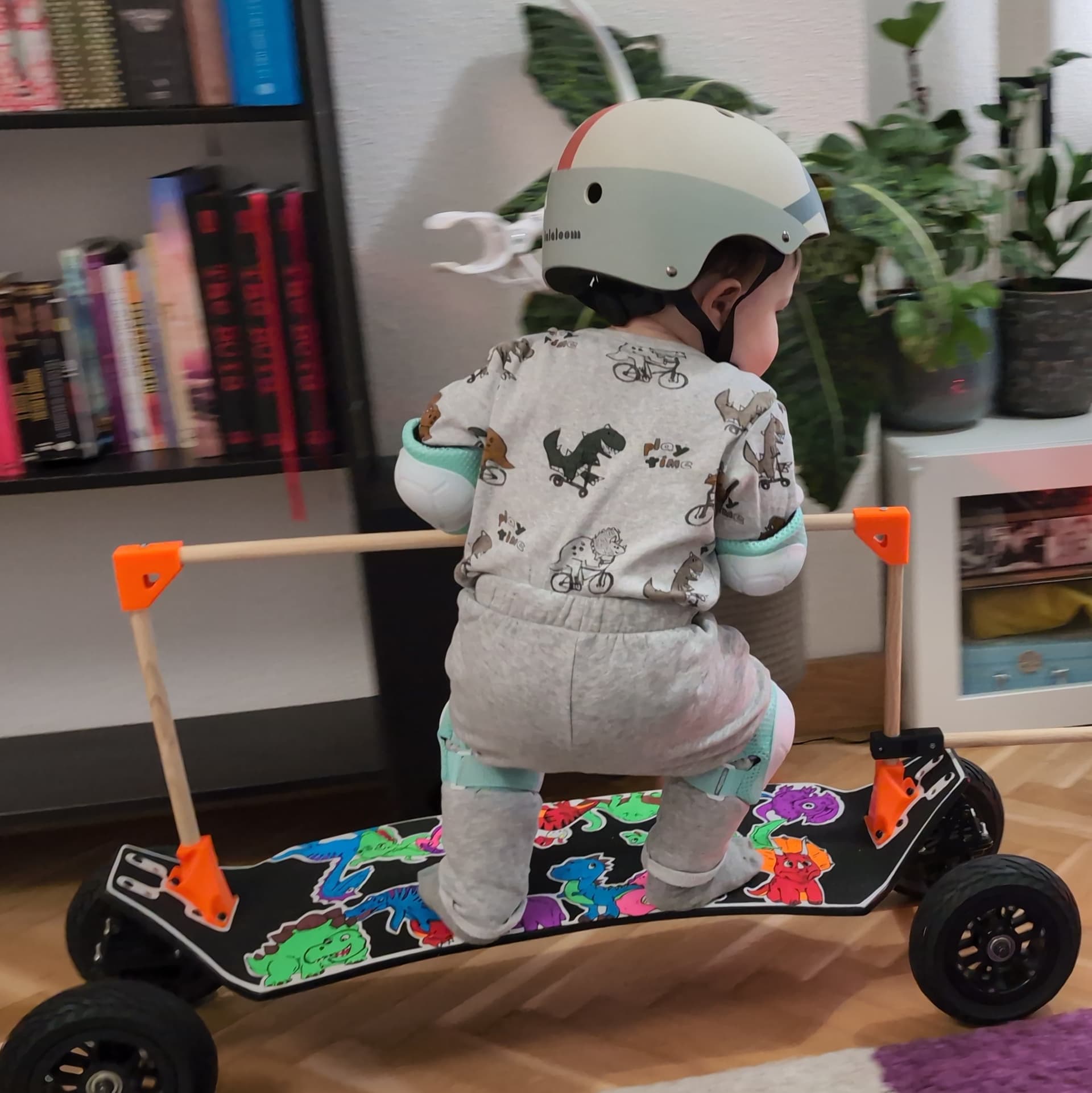

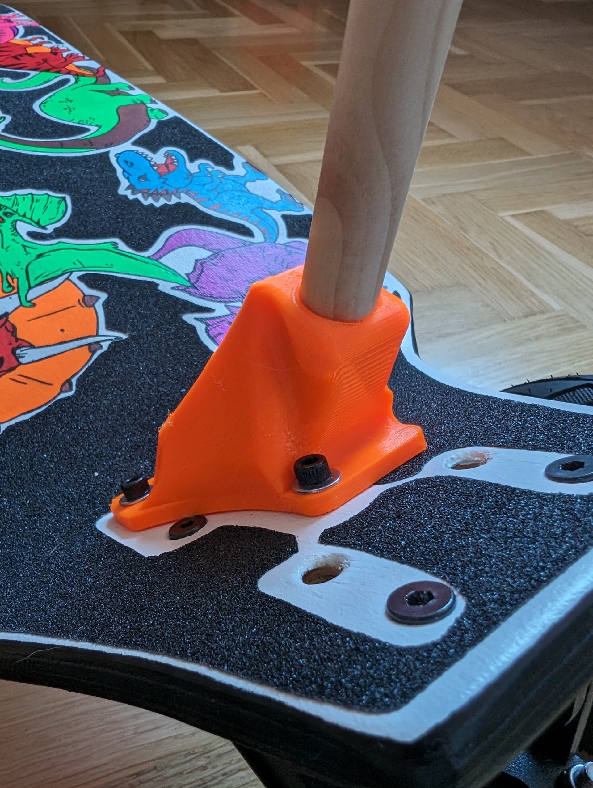

After a lot of eye contact and frowny faces (why won’t he text me like a normal person??), I understood that he had yet another complaint:
“Dear dad, don’t you realize I am unable to stand for more than 3 seconds at a time and I am therefore incapable of riding a board without any support whatsoever?”
OKAY! Jeez
All joking aside, I’m over the moon because…he actually loves it!!!

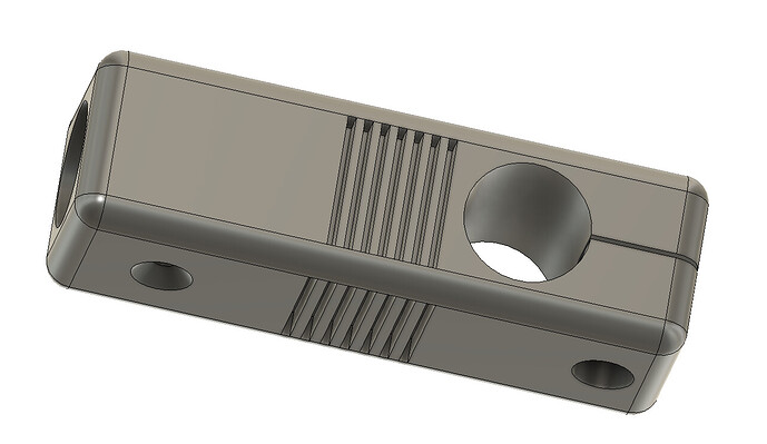

That video is from a prototype version of the barrier. Will update soon…
