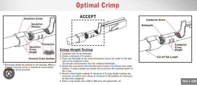

google gave me this, might be bit more descriptive then my doodle

The guy I bought the DieBie from obviously used a pair of pliers to terminate the balance connector. I just want it to work and charge my battery. If I knew it was going to be this big of a pain in the ass, I would have just bought a Lipo charger.
