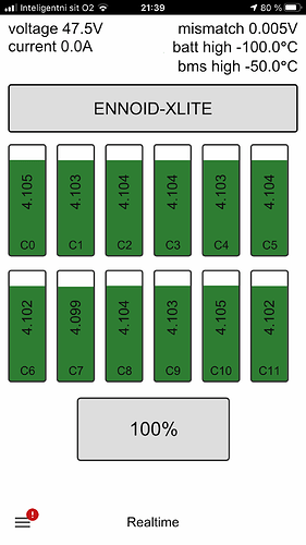

Hi @ENNOID
XLITE12 BMS works fine but not getting anything on the CANBUS.
Do I need the CAN ENABLE connected to a VESC? Doesnā€™t seems to be working either way.
Baud rate is 500k on everything.
CANH & CANL must be connected to the VESC.
The CAN ENABLE+GND pins are necessary for waking up the EBMS with the VESC.
Other parameters on XLITE firmware are normally set properly by default to enable CAN with VESC like on the picture below:
Rebooted everything and it started working somehow :smiley:

So just received my xlite 24s bms and Ennoid vesc. Thanks Kevin @ENNOID After some Startup issues (made a stupid mistake) my 16s setup seems to work :blush:
So Setup bms correctly now. No gaps between the cells in the displays. @janpom
