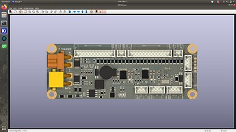

Is the V2 going to have slightly longer mounting holes which is going to mess up existing designs?
Yes V2 is a complete PCB redesign, so the mounting holes wonât fit with the previous V1 Sorry, but I tried to keep them identical in size, but could not. Also, the balance connectors order are different so it is a complete new board. Iâm still planning to keep producing V1 boardsâŚ
âŚbut about separate IC that do not balance to each other, well it does in fact, but it is more related to your settings in EBMS-tool, there is the âcell management->Balancing->cell balance difference thresholdâ and also the âcell management->SOC->mismatch thresholdâ that must be both manually set below 10mV if you want them to balance more evenly.
The small mismatch in cell voltage reading are caused by three things:
The balance cable length/size, in fact balance cable resistance has a small effect on reading. The second balance IC is more sensible to balance cable resistance.
The resistance of the internal traces on the board also create some offset between channels. I tried to lower the trace resistance on V2 by making them wider and shorter, so it has less effect on readings.
Iâm using LTC6804 balance IC due to the part shortage and they are not as good (precision wise) as the original LTC6811 that I was using previously. Traces and balance cables resistance affect more the measurement accuracy with the LTC6804 IC

Hereâs a few comments regarding v2 applications to OneWheel (which this is like the only smart bms that will fit inside the battery box currently):
- âPower button connector for waking up & resetting the BMS with an external ON/OFF button switchâ
This is how the factory BMS works in the OneWheel. i.e. Using a momentary button to bridge ground to a pin that wakes up the BMS which supplies power to the controller. Not sure how useful that is being charge only though.
- âOutput switch connector for controlling an external shield board. The XLITE can now be scaled to a full BMS with external add-on || shield board.â
Interesting. Any specs on space dimensions for the discharge shield board addon? ![]()
- âNow with buzzer, built-in humidity & temperature sensorâ
It would be handy if we could also control the buzzer from the VESC via CAN message to relay other error messages from the VESC.
too bad iâm not software inclined to actually use any of these features,
The new features for V2 are for opening up the XLITE beyond a single use case âcharge BMSâ thus making it more flexible.
It is true that you donât really need a power button for a charge only BMS, but it becomes necessary if you plan to use it as a discharge BMS when using a discharge shield. The extra connectors are all located on the opposite side of the BMS and can be left unpopulated if not needed.
The I2C connector can be used for having an I2C display showing most important datas and having the power button allow to shuffle between the different displayed set of datas. This is an important feature that was missing to XLITE IMO. I really missed that display present on my other discharge BMS.
The discharge shield boards are yet to be defined. Any shape or power is possible for future design.
For the buzzer, it is something that can be done eventually.
