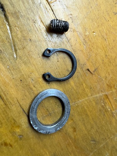

@Tony_Stark Thanks for the reply. So I’m a little stuck. I’m trying to take apart the motor right now, and I successfully got the top part off and some rings unclipped, but I’m not sure how to actually separate the middle from the outside of the motor. Any ideas? The only screws I haven’t taken out are the ones on the sides of the motor.
Ohhh its got a big bearing.
You can try to screw it into a motor mount and then tap the shaft with a hammer. If they used retaining compound on the bearing you may have to take the screws out holding the outer big bearing support in place. Looks like there will be 4 of those screws around the side of the bell.
I’d also suggest putting the screws holding the shaft to the bell back in, otherwise the shaft may start sliding out of the bell.
Before you do this :point_up_2: please unscrew the bolts on the side of the can into the block with the bearing. Else you are never getting it off.
Edit: i misread @Tony_Stark already mentioned this.

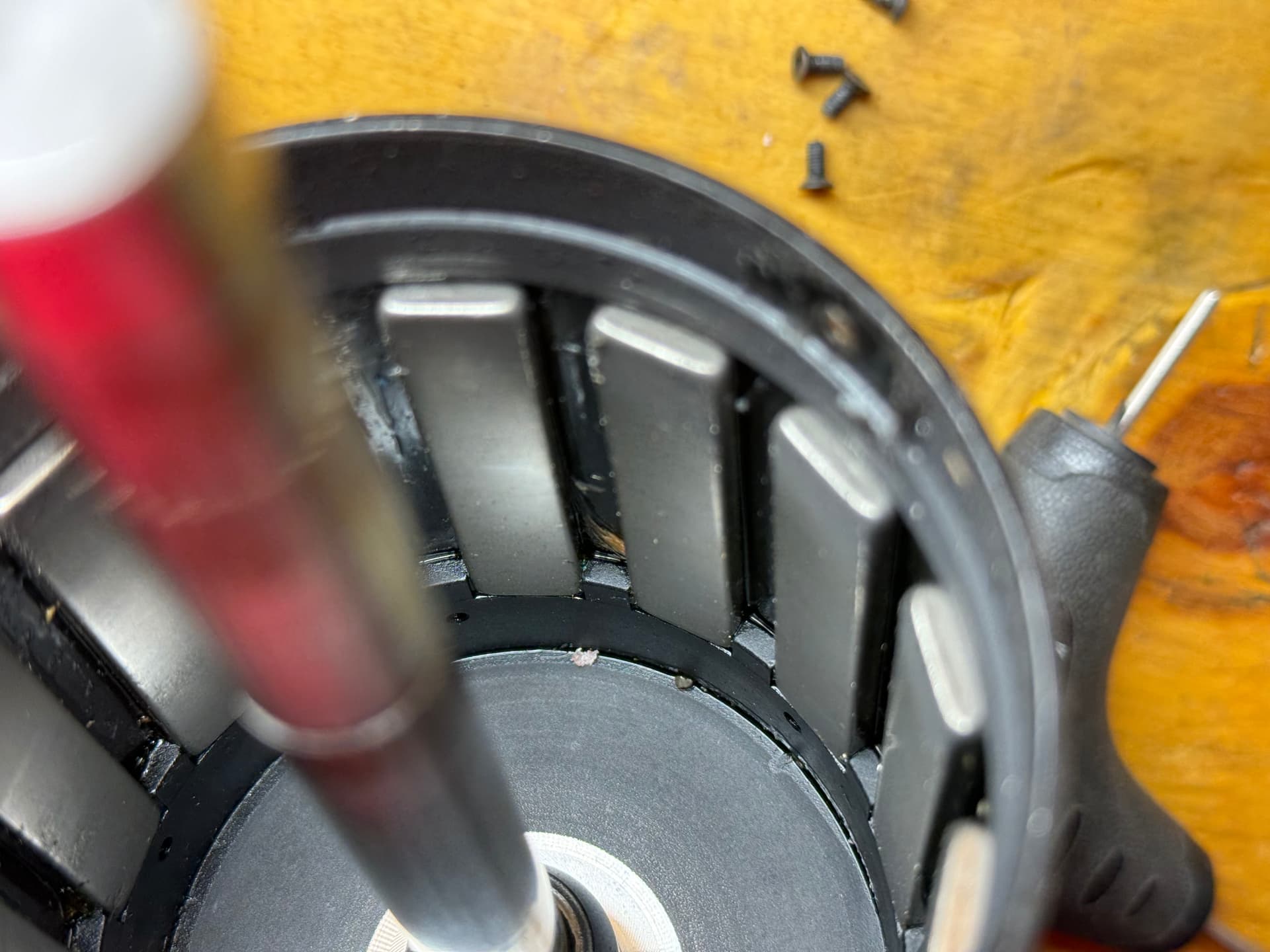

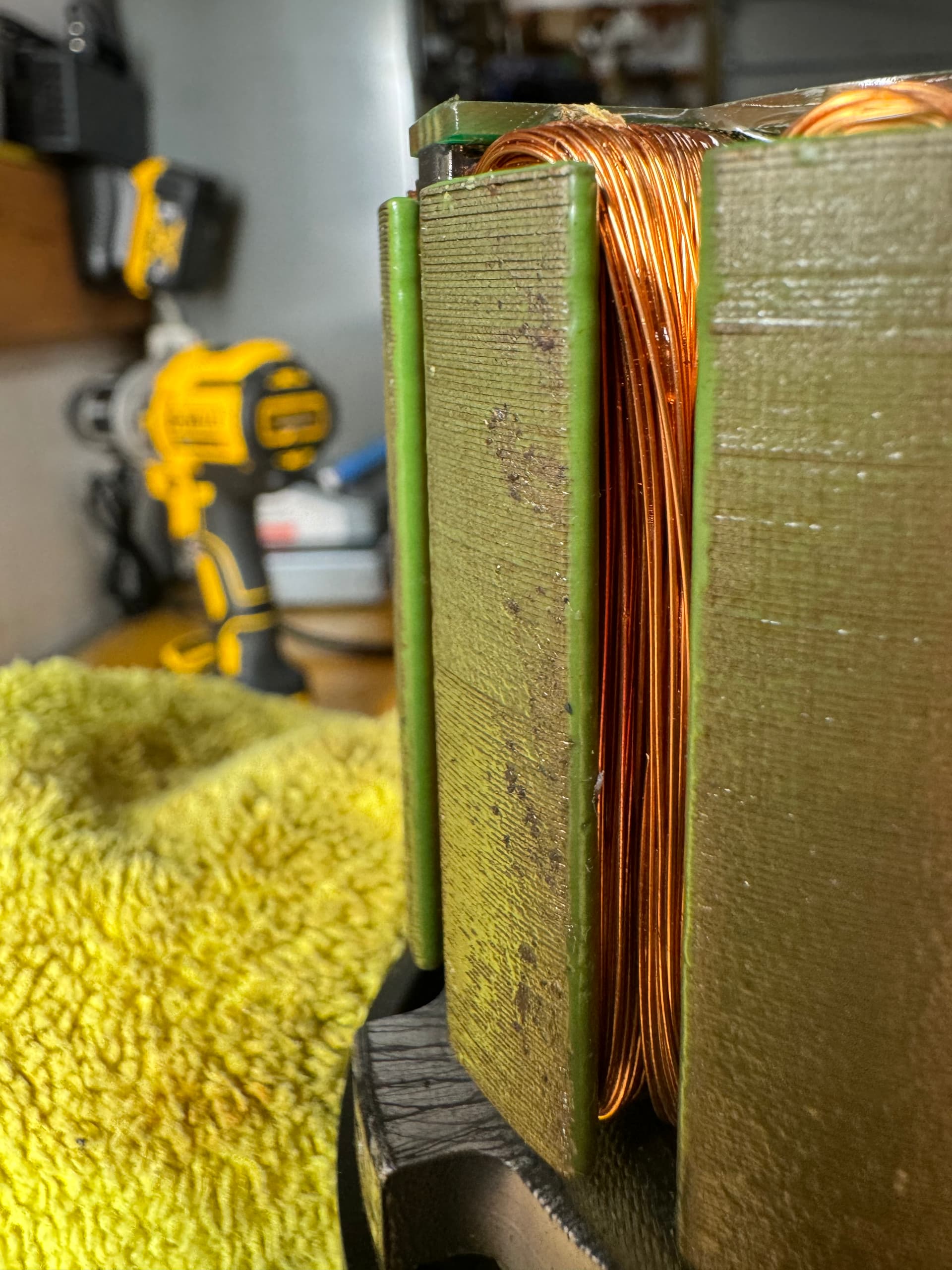

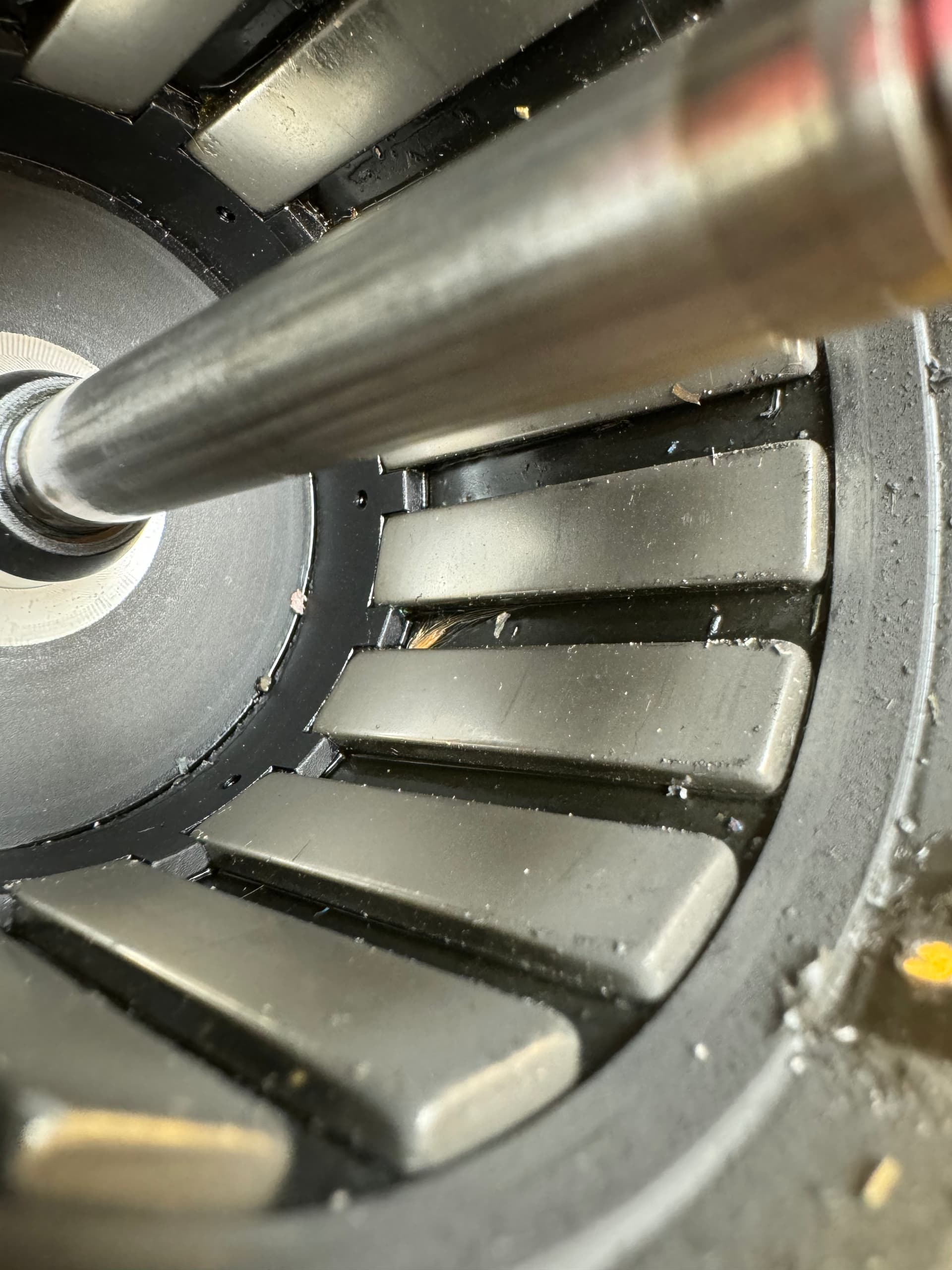

Sorry for the delay everyone. Thanks for the advice to get it open, it worked! So now that I’m inside, I’ve noticed a couple very small things. #1: There is a small piece of field grass wedged in between the magnets. (You can see this in the pictures). Not sure if that would cause much of anything. #2, there is some verrry light scratching on some of the magnets, but it honestly is so light it’s barely noticeable. I also don’t think any of the magnets are loose. So, I’m not really sure if I found the cause of my issue, unless someone sees something I don’t (Please lmk!). So, while I’m in here, what should I do to clean things up? There’s some sort of film over everything, but maybe that’s normal? Should I wipe it off? I’ve already blown it out with compressed air, and got a little debris to come out. @Escoot @Tony_Stark @vap
Upon closer inspection, it appears that there is a very small sharp piece of metal flaring out from the bottom part of the housing. A very small metal shaving came out of the motor as well. Should I just try to smash that flare back into place, or remove it?
