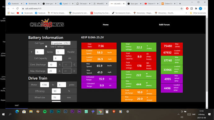

Did anybody successfully run a inrunner on a vesc?
How you figure that?
75k unloaded according to my calc :open_mouth:
Its only a 4 pole motor. 12.6v x 1700 = 21420 x 2 pole pairs = 42000 erpm .
At 6s 1700kv, the max erpm would be 85000.
ah your right though it was 7 pole pairs my bad

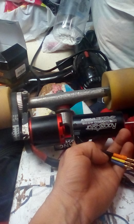

Sorry man that was a bad attempt at a joke, i mean that the inrunners are more powerful sizewise so for instance my 380kv 5055 is rated at 1850w, my 1700kv inrunner is a 4076 and its rated at 2800w :slight_smile:
But as i have stated im all new to this and just curious :slight_smile:
@Halbj613 and whoever else might be interested here’s a size comparison between my 380kv outrunner5055 and the 4076 1700kv inrunner :slight_smile:
