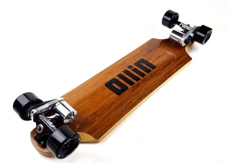

Most iconic split mount board i can remember was the old Ollinboard setup. I think the main issue was always that it was just needlessly complicated compared to a side by side design these days.

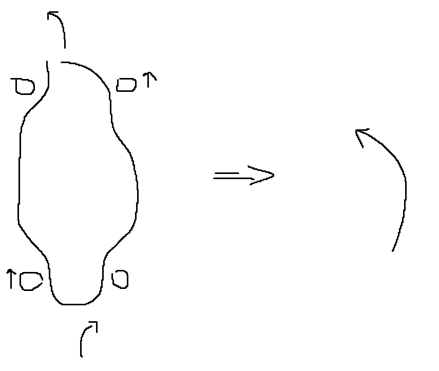

Doesn’t having the motors diagonally create a turn bias in the same direction?

Dual diagonal also allows for narrow trucks which can be a lot more responsive and stable than wide trucks. The BN145 truck hangers would be ideal. Or those Ronins above.

Would make it worse actually.
Yea that’s what I meant.
Maybe going front and back on the same side makes more sense?
That would eliminate the torque-veer, but then you’d be giving up one of the big advantages of diagonal: Having at least one drive wheel with weight on it, no matter which way you turn. Let’s say you have both motors on the left. If you turn right, both your drive wheels are unloaded because all the weight is on the other wheels (the direction you’re leaning). This means you’ll have weird inconsistent traction for acceleration or braking while you’re turning one way or the other.
Instead of veering left or right, it would tend to “crab” sideways. (remain pointed forward, but not move quite the same direction it’s pointing).
It does, until you lean hard into a turn and both drive wheels start slipping which causes a wipeout.
