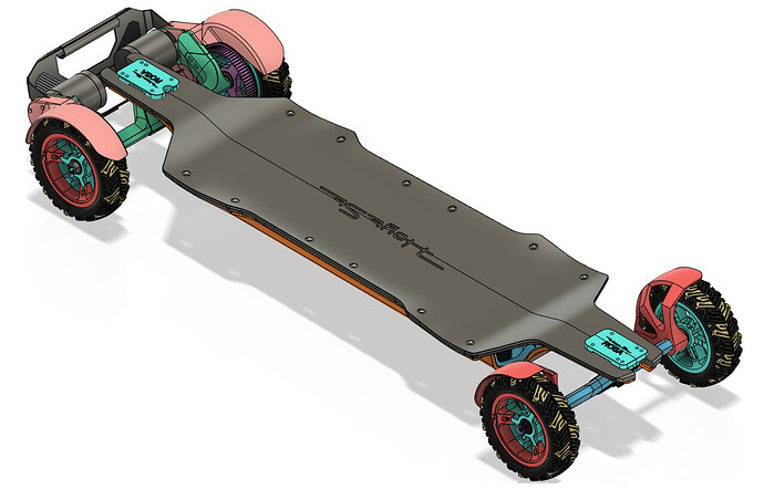

What if the Cascade had a bigger and badder battery. Also, what if I mounted the trucks drop-through.
CAD Screenshots
I like using fusion 360 to fully plan out my builds. I think it’s important to fully think out your design before starting. This thing will be ridden very quickly and it’s important that it’s built properly and neatly. I’m glad I learned CAD as I think it’s absolutely critical for a board builder to do their own design work to really call it their own. Even if it’s just basic assembly of parts in CAD.

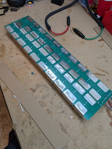

With the help of some juicy blackmail, I got @BenjaminF to design a PCB for my 20s5p pack.

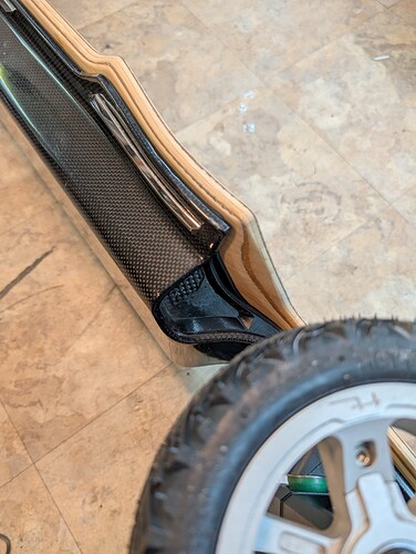

My initial plan is to reinforce the bottom and top deck with fiberglass before milling out the shape needed to allow for drop-through mounted ROSA trucks. I will be getting my hands on two decks just in case this doesn’t work.

The battery PCBs are here! I have 3 unclaimed PCBs left.
This is gonna be such a nice battery build :smile: thank you endlessly @BenjaminF

I’d be a little worried about routing that much material out of the deck to do drop through with RKP.
Has anyone done drop through on a UAV/Dadbod/Cascade before?
SRB 3 links would be a good path to the ride height you’re after, as you could just drop the heim through the deck, but I’m assuming you aren’t interested in that path.
I will be adding some carbon fiber and will be switching back and forth between ROSA trucks and the Newbee 3links
You’re very welcome, it was a fun PCB to design!
Dont forget to apply some kind of insulation (fishpaper, FR4, etc) between the cells and the PCB! There’s PCB copper on that top surface, so you dont want the cell wraps rubbing up against it and causing a short.
More battery build pics in the original post. Been picking away at this pack while other projects print/glue dries
What’s left is adding solder and heat shrink

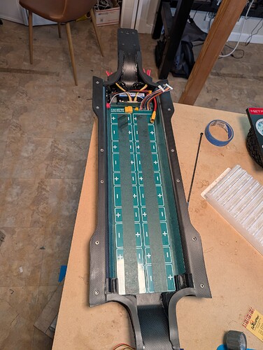

Battery is done
Had to stay late at work today, but I couldn’t stop myself from staying up past my bed time to close this up. My job is having a car show and all types of vehicles are welcome. I’ll be bringing my whole fleet hopefully including Denali. It’s on Wednesday :face_with_peeking_eye:
She’s rideable!
Holy fuck it rips. I haven’t found a way to do a real full throttle pull. Standing up is a skill issue on my end; sitting down the thing did a wheelie out from under me.
