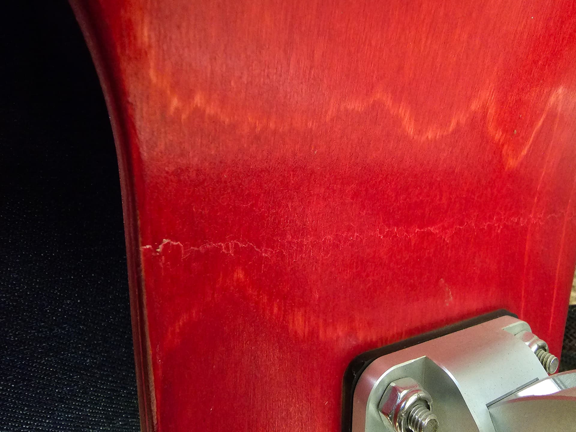

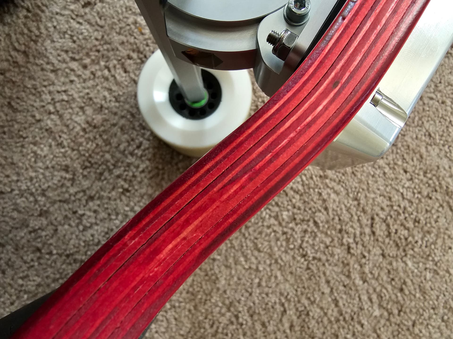

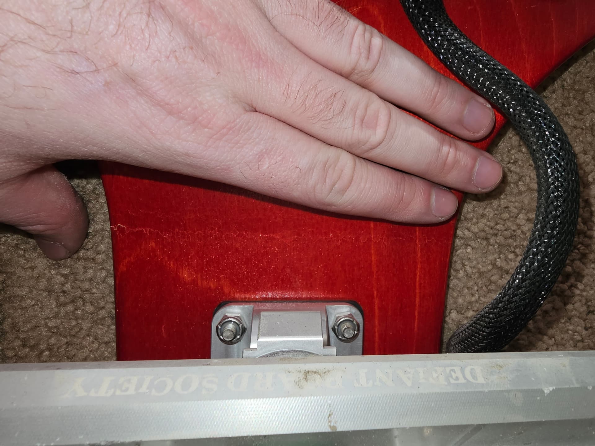

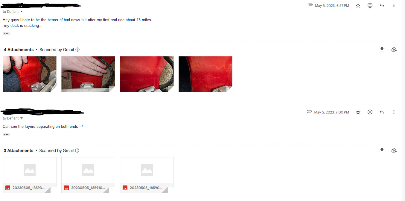

5/5/23. Got the new bushing from Riptide and finally had some good weather to ride. Went on my first ride for about 13 miles everything felt good, and board performed well. Did some general inspection after the first real ride and I immediately noticed the drop down was cracking on both ends and de-laminating. Emailed Defiant.

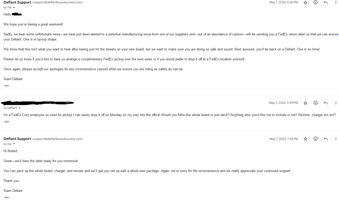

5/7/23. Damon emails back stating based of the photos I sent the board isn’t safe to ride. Set it aside and wait until they have a plan for me.
5/7/23. Defiant support emails stating they’ve been informed of Manufacturing defect from one of their suppliers and wants the board returned to them to replace the deck. They would provide a label for me to ship it back.
5/8/23. Shipping label provided and I dropped the board off.

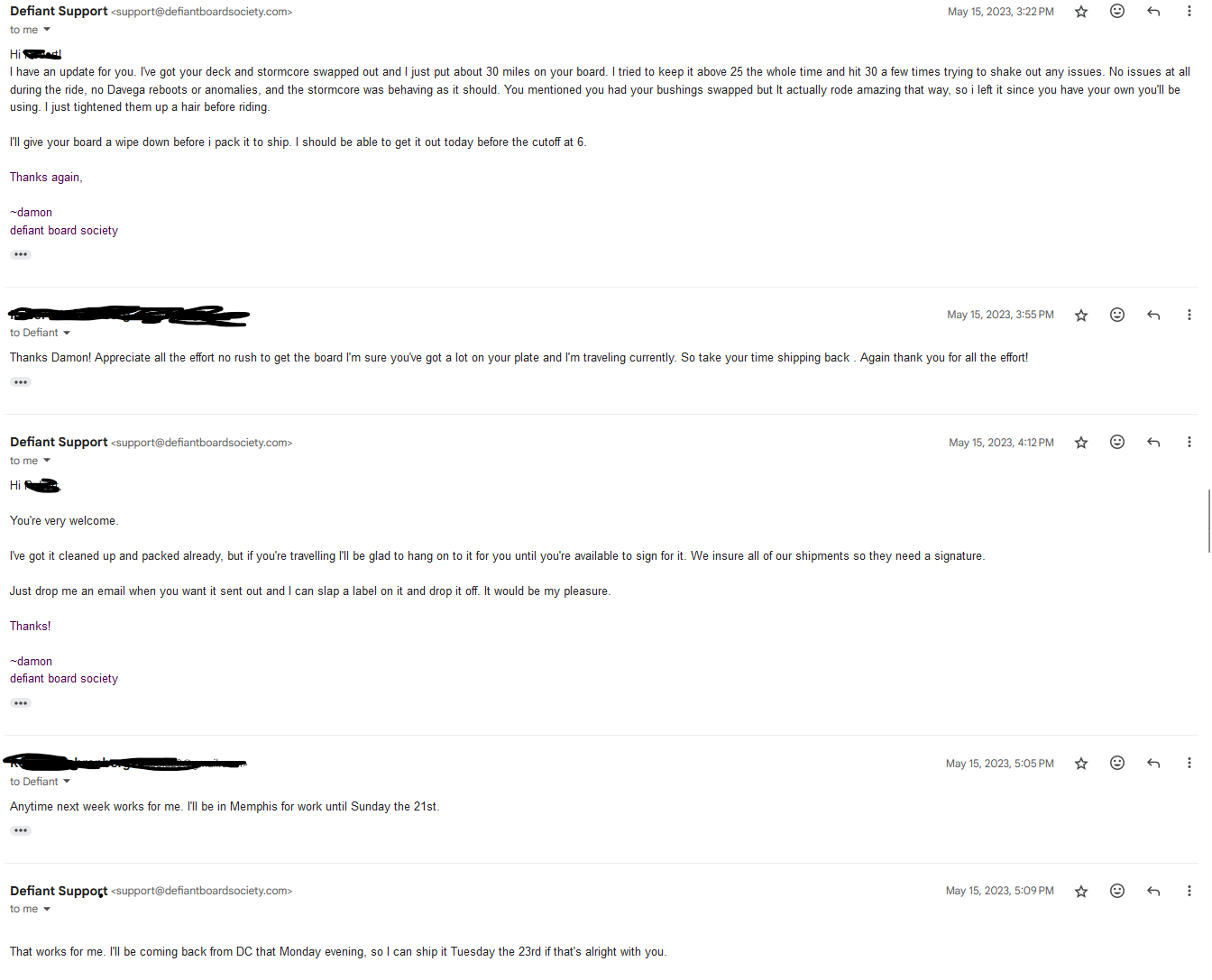

5/15/23. Board is ready to come back I asked them to hold on shipping because I was out of town.
5/23/23. Board Shipped back.
5/25/23. Board arrived back to me with the deck replaced.

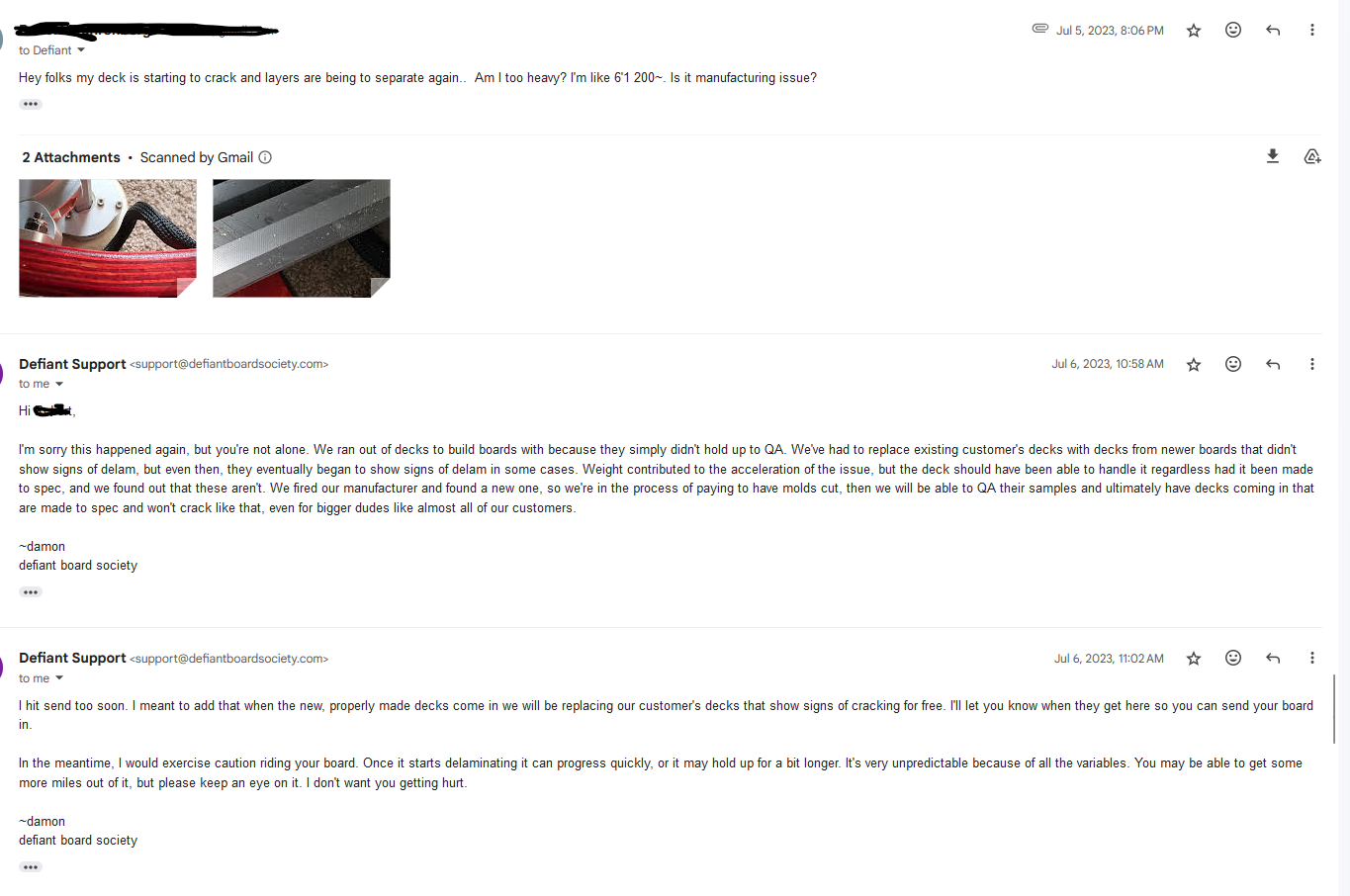

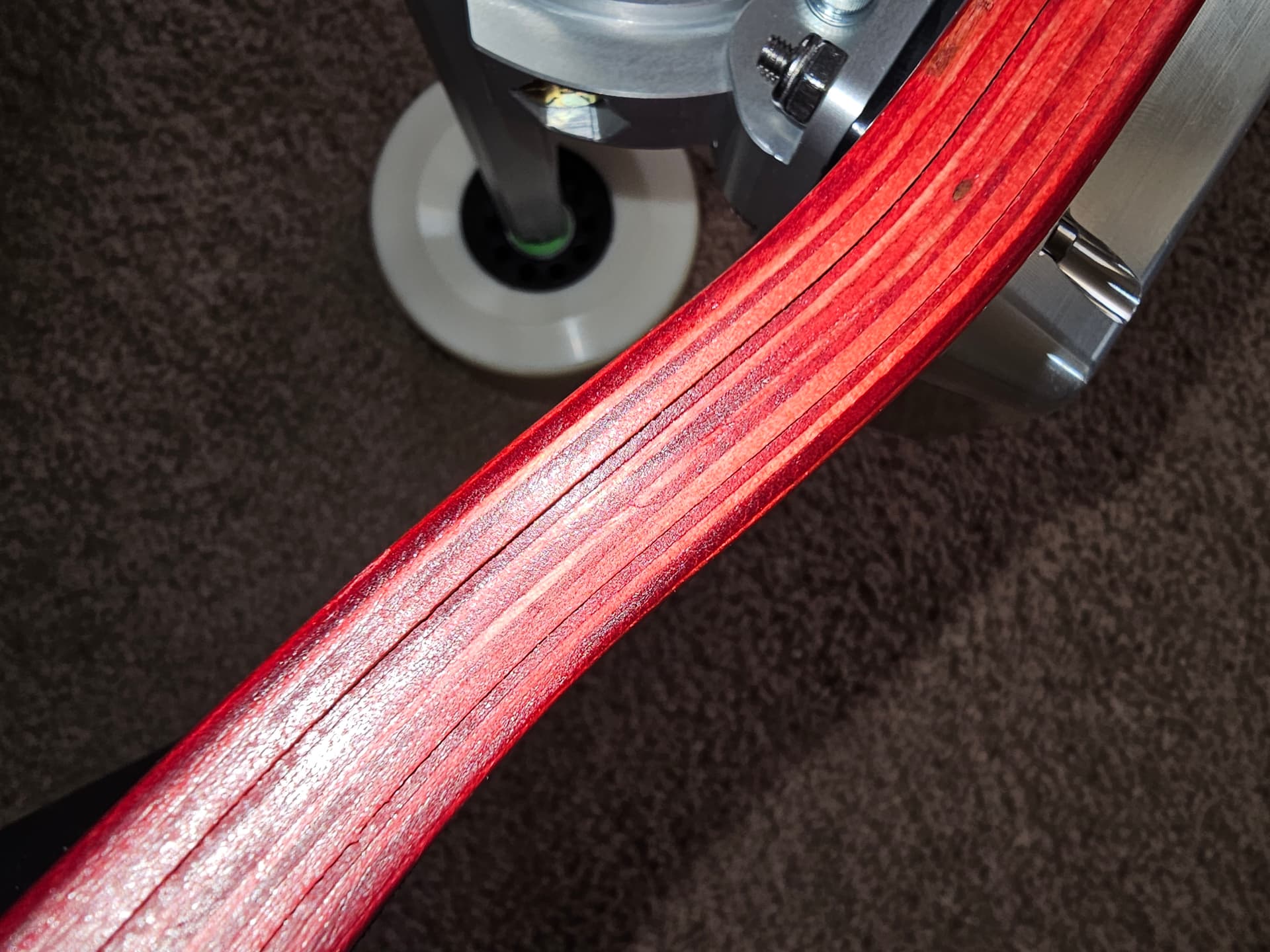

7/5/23. Getting ready to go for my first ride back from vacation and I step on the board and immediately I hear cracking. Flip the board more layer’s delaminating and cracks in both drop downs again. So I email @longhairedboy
7/6/23 @longhairedboy responds saying their manufacturer basically didn’t build the decks to spec and they’ve fired that one and have another and are working to get new decks ready. They’d be replacing all decks free of charge. No biggy earlier adopter tax I’m not too worried. I offer to hold on to my board and when they get the new decks let me know and just ship me a replacement and I’ll do the swap.

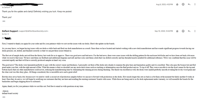

8/8/23 Send a follow up email asking for an update. I’m told they are getting production samples “next week” and they might move to production in a few weeks.
No more updates for for another month So I email.
9/10/23 I get a response @longhairedboy with some good and bad news on production of the decks and they are expecting production samples “Soon”
Another month goes and shockingly @longhairedboy reached out to me first.
10/12/23 LHB emails an update stating they’ve gotten 2 different samples of production decks and are happy with the quality and will be moving forward with full orders of replacements. ETA is “Early November”

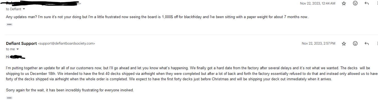

11/22/23 November is basically over with no news so I reach out asking for any updates. At this point i’m pretty much done and kinda pissed off. @longhairedboy responds stating he’s working on an update for customers. The decks would be shipped to Defiant on December 18th.

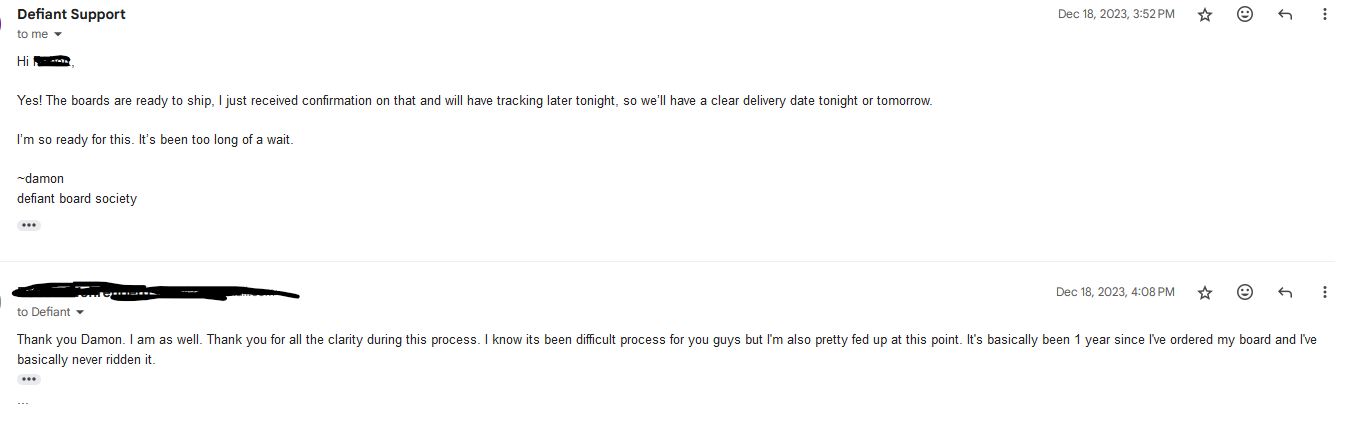

12/18/23 Last email i’ve gotten and sent.
