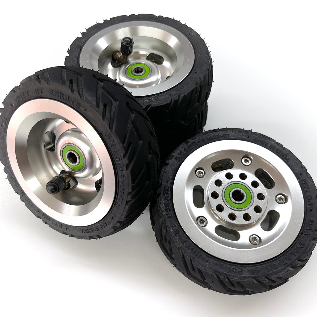

Did they ever finish manufacturing the 5” pneumatic hubs? :man_shrugging:t2:
That’s Hoyt
defiant toooooooo
:point_down::frowning: @longhairedboy
This is a preorder. Items will be shipped out as soon as we get them. Feel free to contact support with any questions.
i saw them at the expo, so i hotta assume they’ve alreadygotsomemadetheverylast
ooohhhh damn these look even better than the hoyt ones! I hope the 5" hype catches on more.
Better than both versions of the Hoyt 5in? :pleading_face:
I like the rim style, it’s my personal preference. I wish the Retro Rollers were obtanium.
They remind me of my old Borbet A’s I used to have on my Van
@longhairedboy I’m curious why you guys chose this instead of bearing seats in each side of the hub? In my experience this only leads to headaches, that are easily solved if you have the core split into two pieces. Is there an advantage that I’m not thinking about?
Change tires without having to take the rim off the axle
wow, think this’ll fit my exway flex?
yeah but you’ll lose at least 1/3 of your range versus stock wheels
Fair point. Doesn’t seem like a good trade off to me.
In theory, better balancing and bearing alignment. Having bearings in each half means the bearing alignment is dependant on how well the two halves locate to each other when assembling. Having the bearing seats both in one solid piece eliminates that potential for misalignment.
What are the issues you see with both bearing seats in one half of the wheel?
