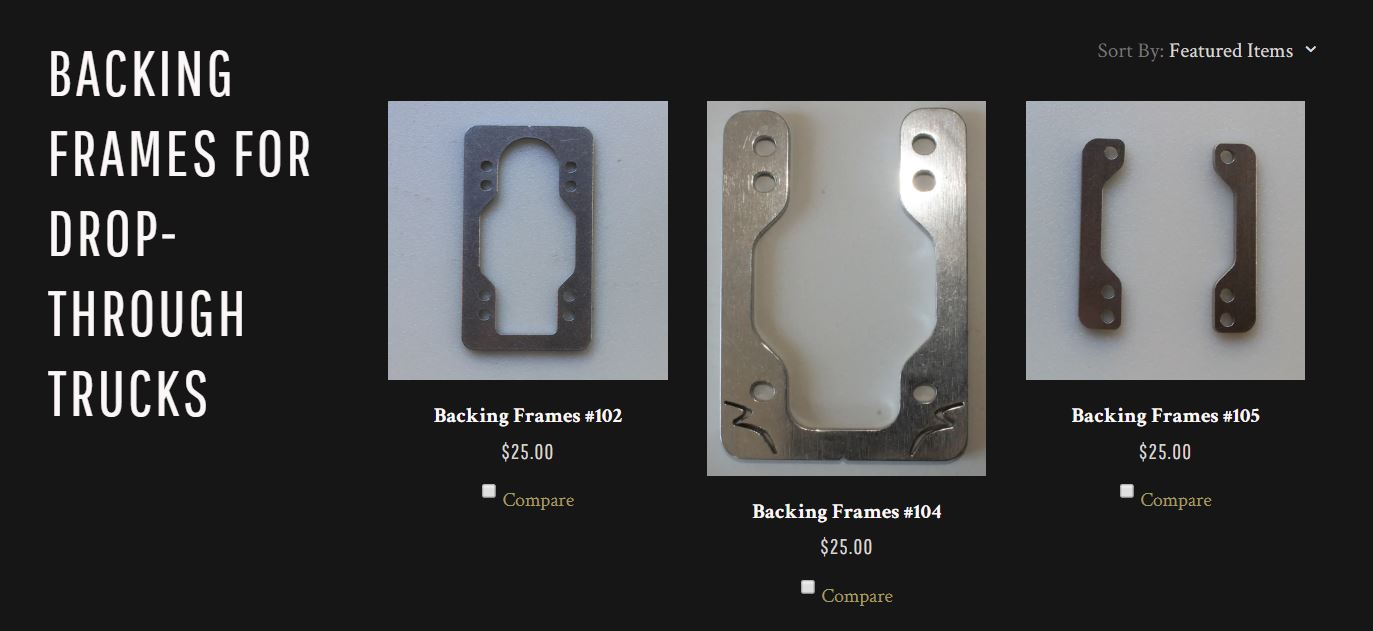

I think in your case, something like what @A13XR3 mentioned from @RipTideSports would help prevent the wear on the wood
Years ago when my son and I started making drop through decks, we started making frames to reinforce the deck. We did not like the idea of our lives resting on such a weak structure, so we made these that mount to the bottom of the deck: https://www.riptidesports.com/backing-frames-for-drop-through-trucks/

those look ****ing exquisite :clap:
As I stated above, I already had the backing frames for the drop through deck installed for the entire duration of the board. They probably helped in delaying the inevitable failure of a budget deck being pushed to 30mph for 1000 miles.

Wooden decks should be reinforced with X-Things, I-Things, metal frames, etc. Bolts will hold onto them sandwiching the decks in between, taking the stress out of the mounting holes and preventing cracks across the wood.

imo, the main take away here has been said many times. X things, I don’t like so much. if you are using an x thing to reenforce a drop through deck just cause you have it on hand, fine. otherwise if you aren’t running drop through, don’t buy or build on a drop through deck! and if you do, at least use some metal re-enforcement opposite the baseplate… this is absolutely essential. even if I had CF or FG reenforced bamboo or whatever I wouldn’t think about mounting directly to wood any side on drop through without re-enforcement brackets or something. Even straight topmount 13 ply maple no cutouts will eventually stress fracture/crack, crash, and burn.
