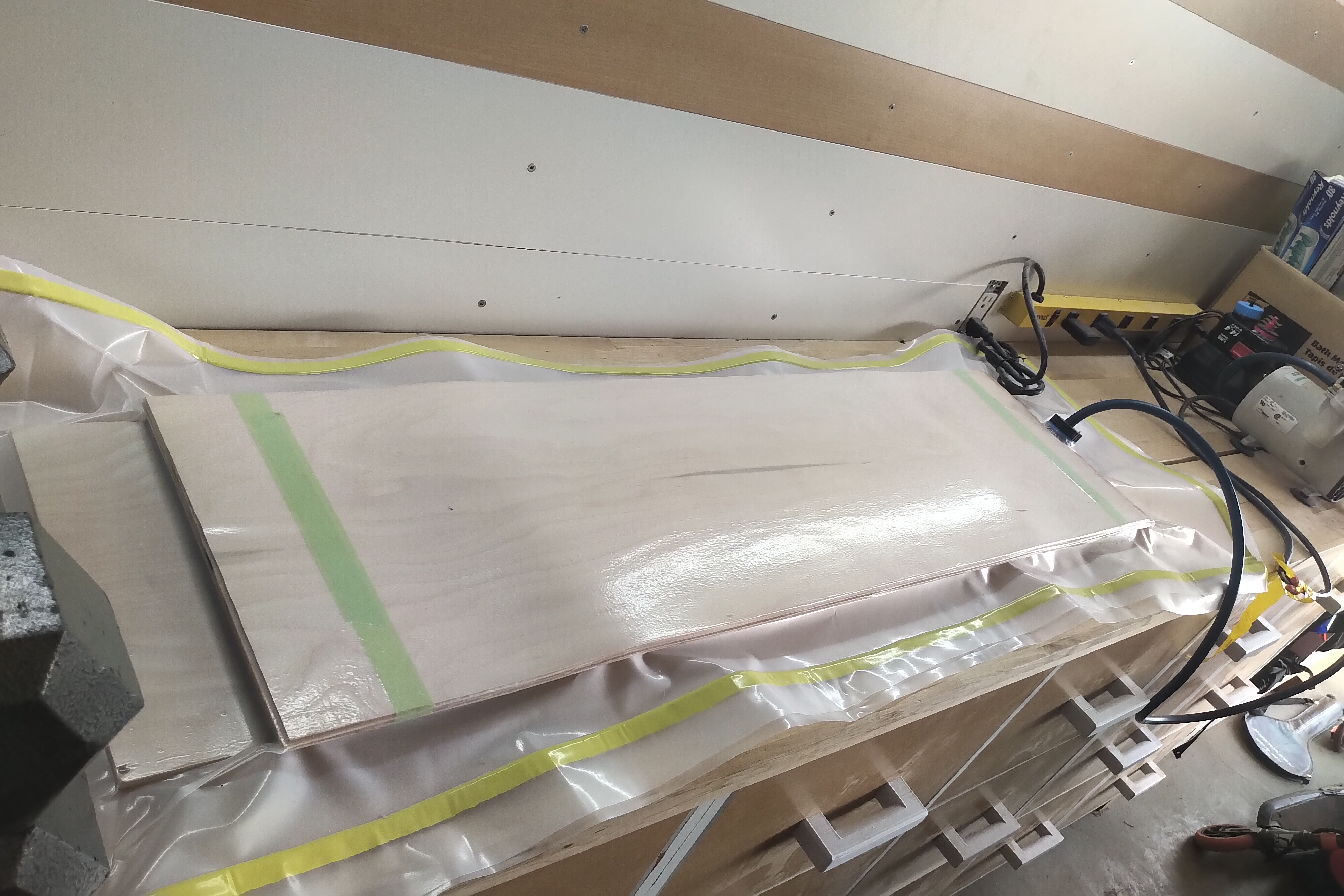

7-10 layers of Maple veneer depending on flex requirements (Usually 7-8 for a good amount of flex)
2 cross grain cores per board.
Titebond III wood glue
3D Printed mold with pre located truck holes in the mold. Also 3D printed templates for the cut out and nose/tail profiles that lock into the truck holes.
For a Vacuum bag I usually just use some vapor barrier and Butyl tape to seal it. Running a small vacuum pump through a 3D printed valve into the bag.
Let it sit for 8-12hrs usually.

Also will be using a 3d printed mold and a vacuum bag, although not sure if I try a simple press with wood cauls instead.
Still need to figure out a good finishing lacquer. Really liked the look on @tomiboi hornet deck.
The first set of boards I made for my kids a couple years back I used the press and wood caul method. In the end I think I can get a more accurate shapes and such with the 3D molds and vacuum.
