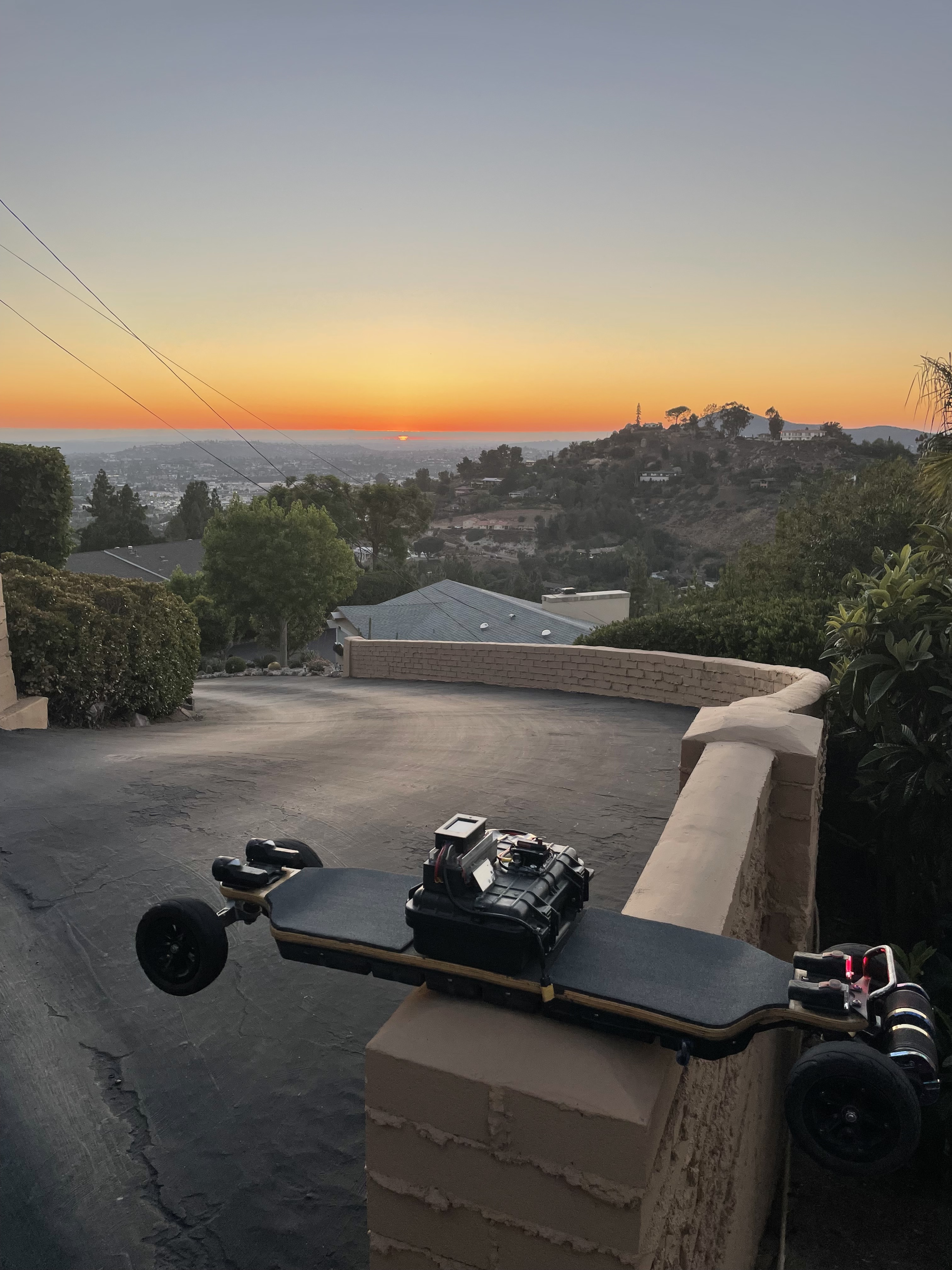

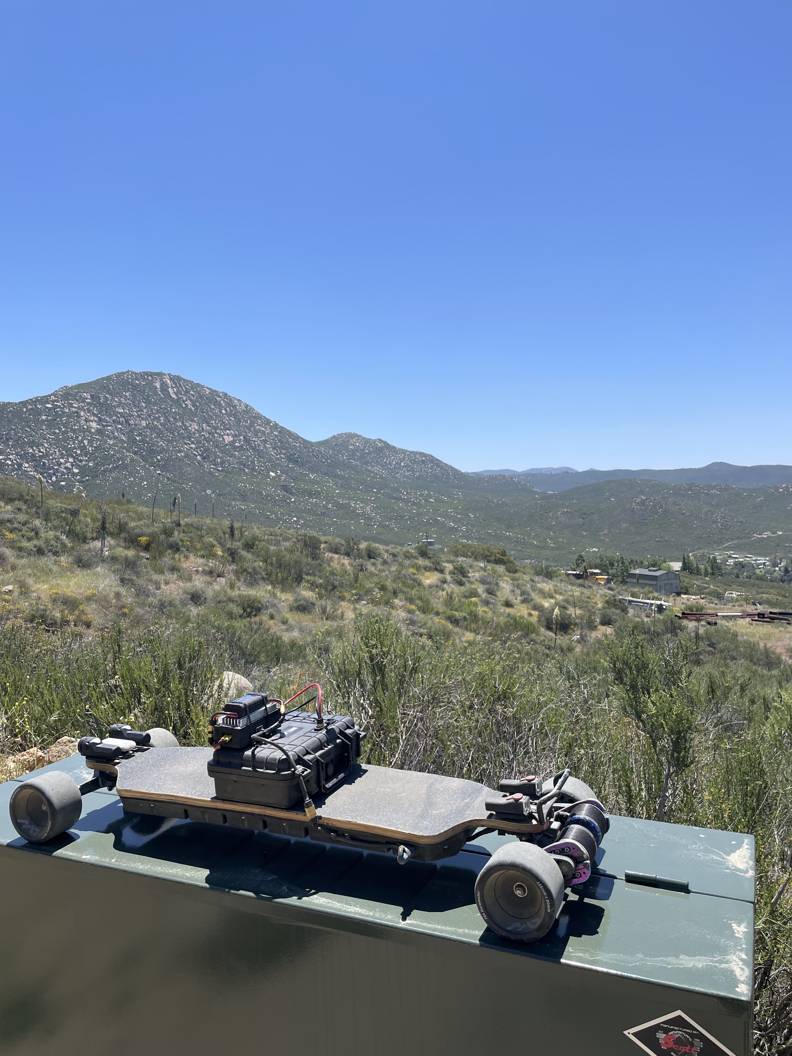

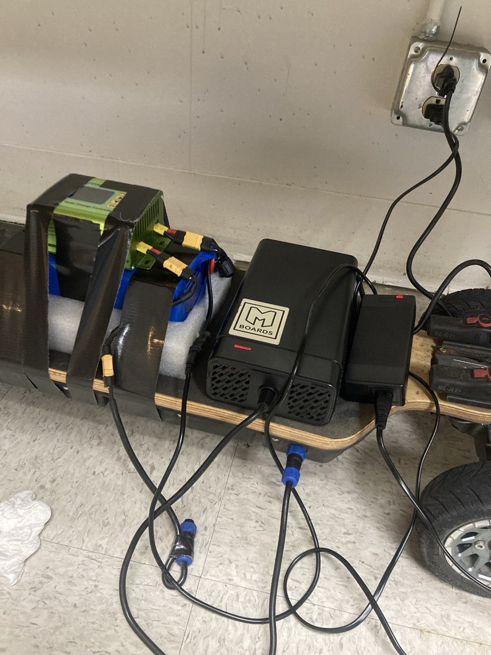

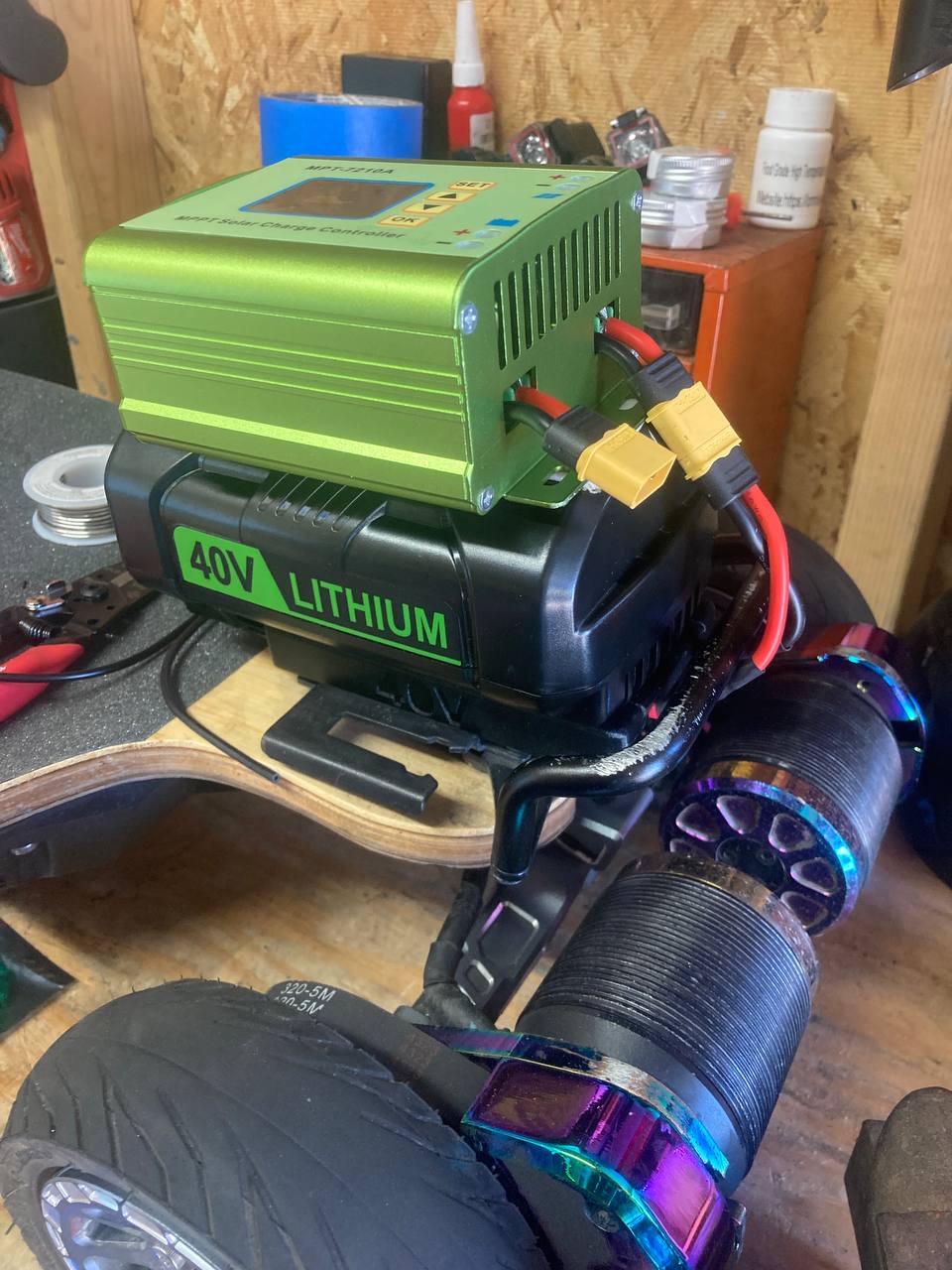

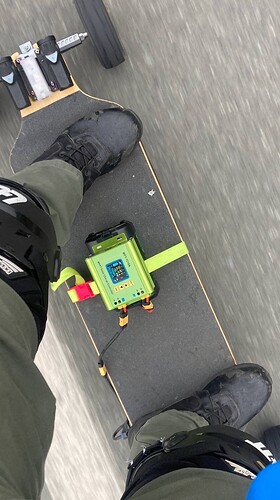

I’ve been building charge and ride systems for my Ownboard Zeus in different variations for the last year and a half or so. I figured I’d share my trials and errors maybe someone can benefit.

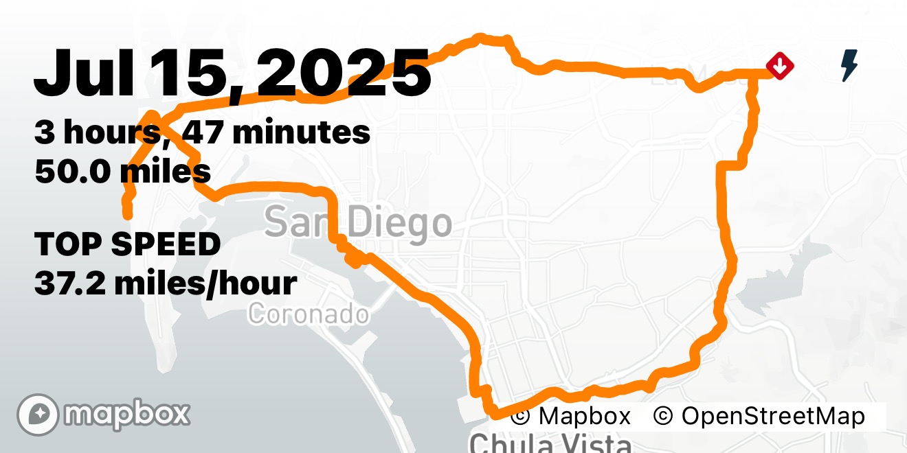

This whole project started out of the need for more range. It’s crazy how conditioned our feet and bodies can become for longer and longer rides. I ride hard and fast for this board so typically only get 25 miles out of the 25ah boards pack.
Old versions
Summary

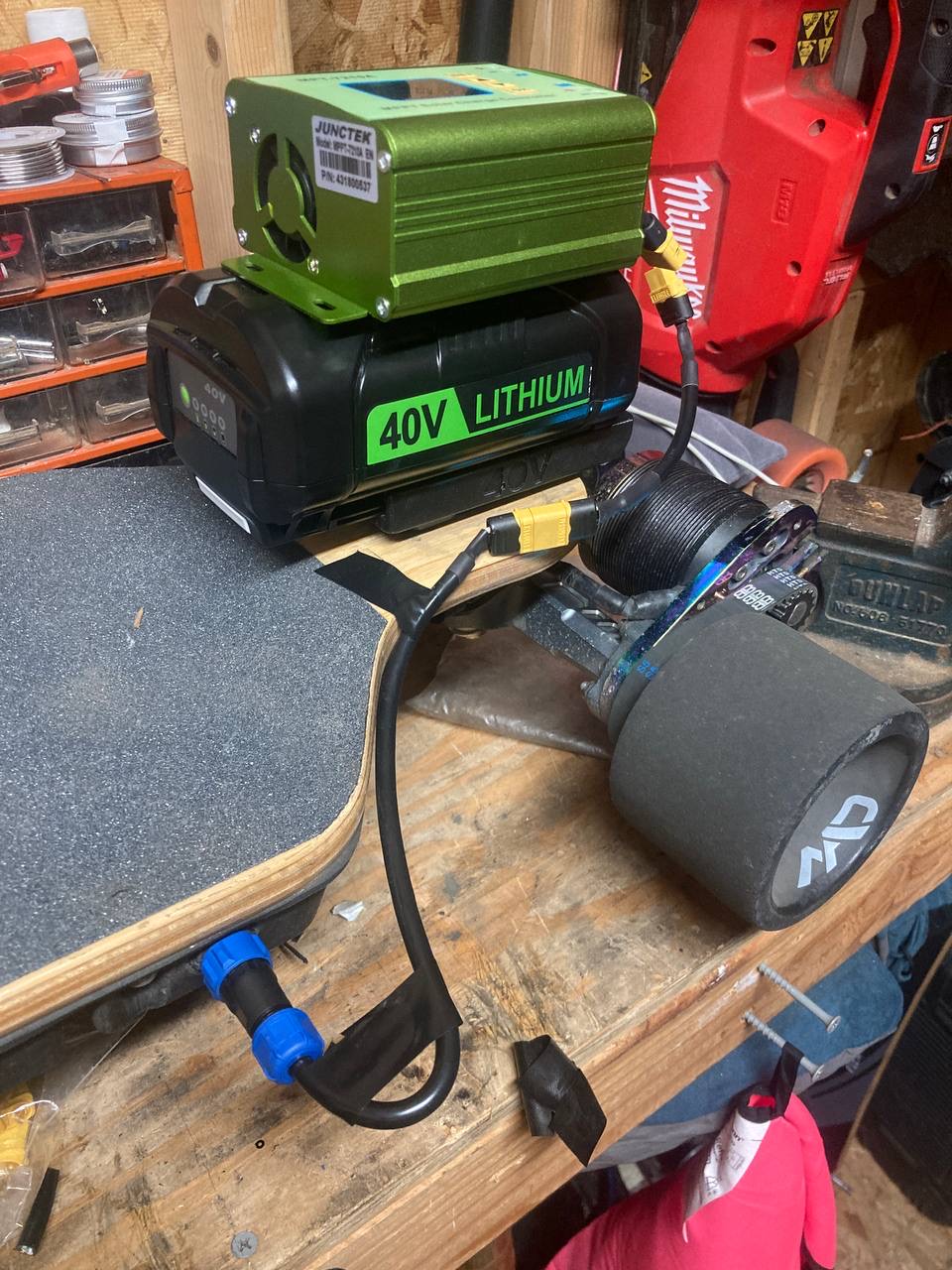

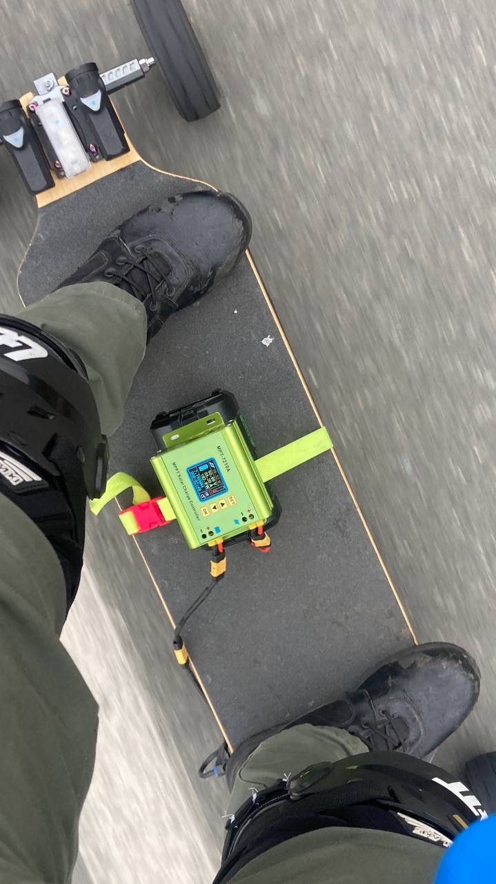

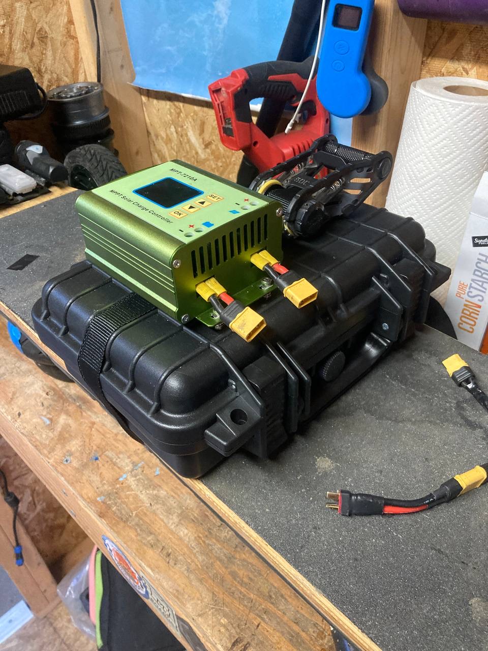

I started using the 7210 MPPT solar charge controllers you find on Amazon. The functionality and screen is so cool, but I got the least amount of energy “transferred” from battery to board due to losses in efficiency (350watts same battery I got 430 from with dc dc controller). I blew traces on two units and deemed them not appropriate for onboard charge and ride systems due to road vibrations and unreliability.
This version worked well as proof of concept but not much capacity in these batteries and the 3d printed base broke due to road vibrations :stuck_out_tongue_winking_eye:

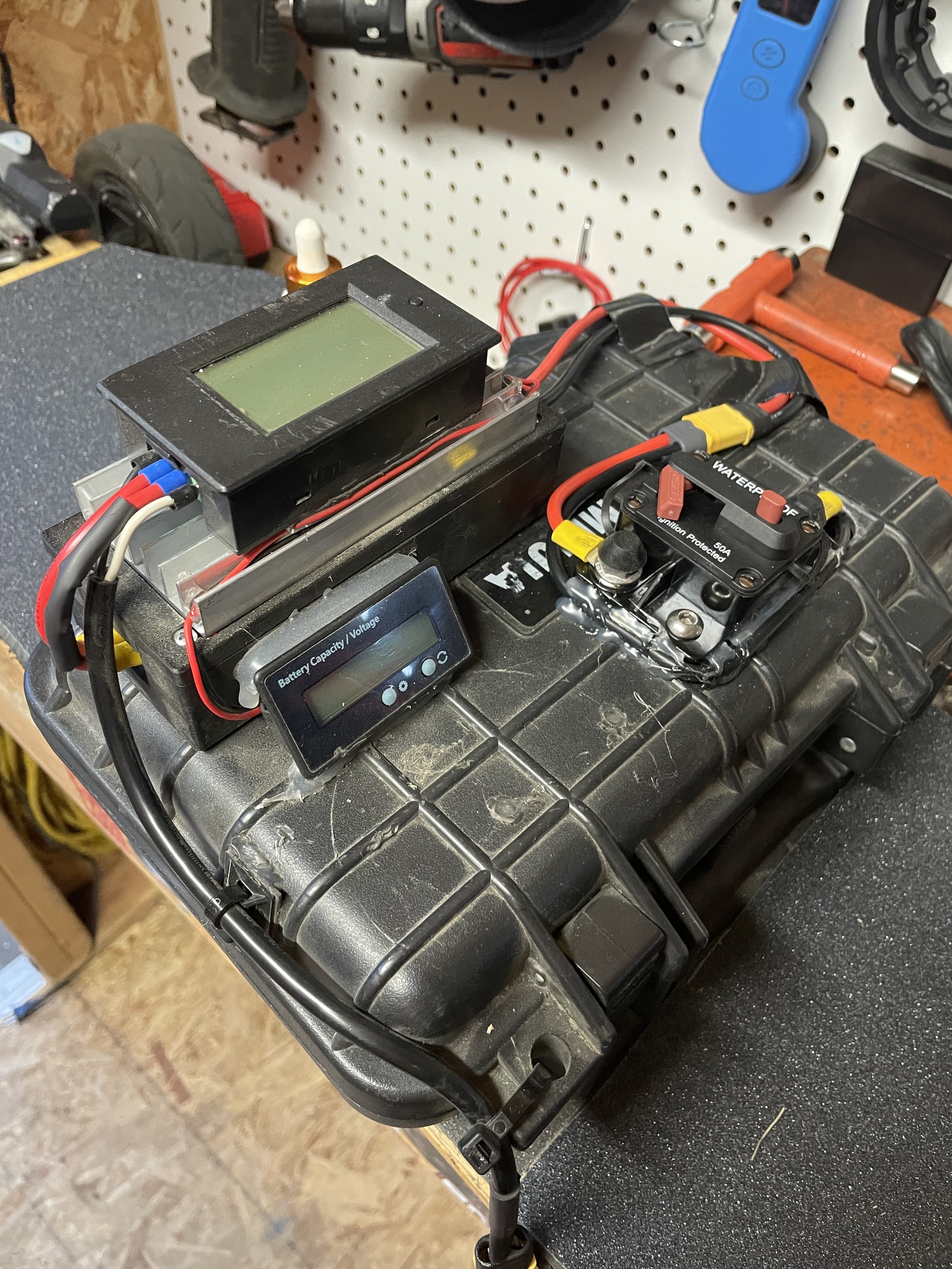

After blowing traces on two 7210 MPPT I chose to move on to DC DC boost converters. These things are cheap, and work incredibly well. Very reliable.
I’ve chosen 10s batteries (42v) for my system because you need to step up the voltage from low to high. In my case I’m usually charging 13s boards so the voltages never cross by going 10s to 13s.

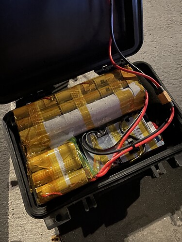

My initial versions used Amazon e-bike battery 10s 14ah pack. I could typically get 430watts out of the pack and get an extra 20 miles range, sweet!

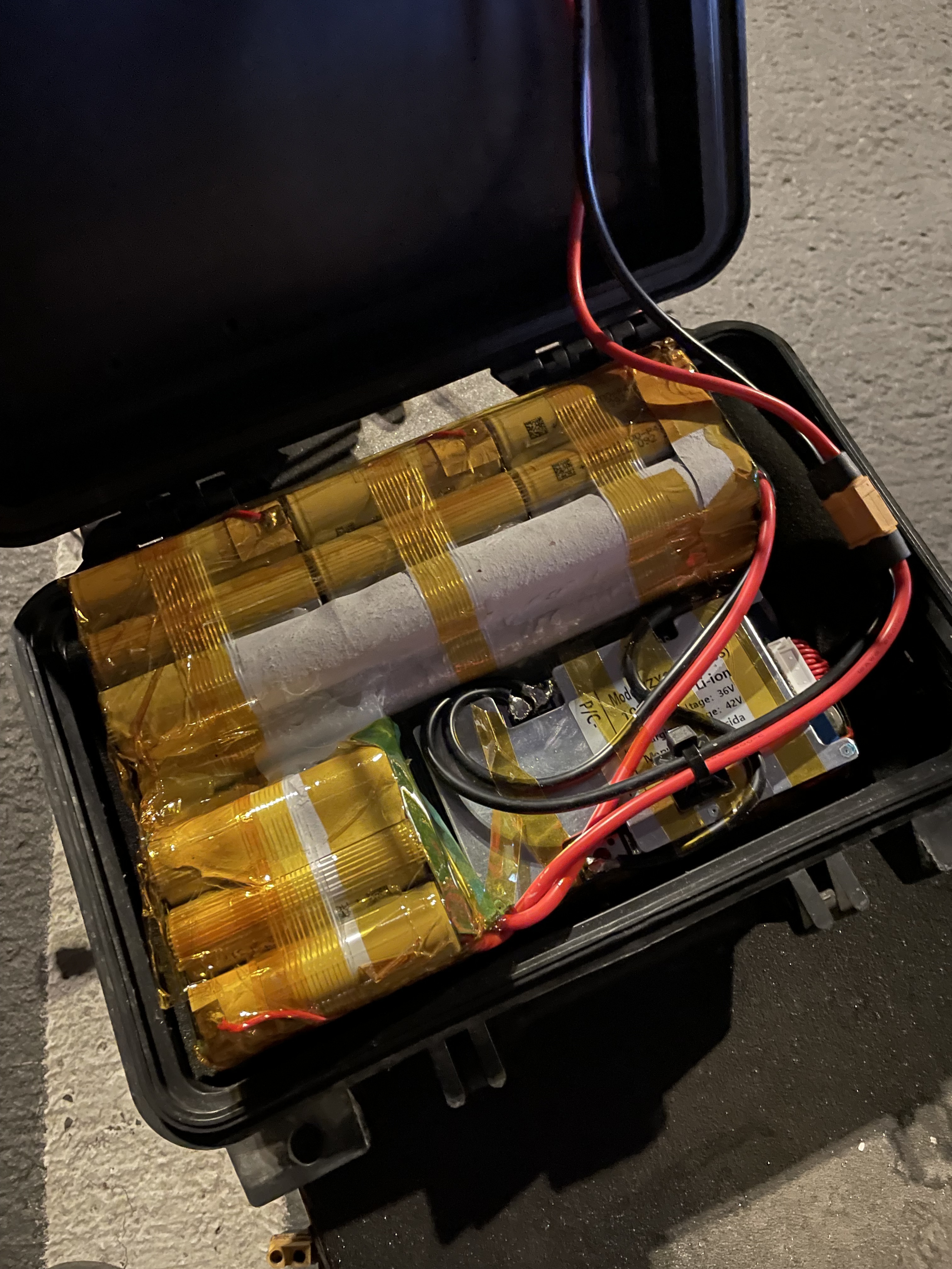

After sharing my success and failures with @tuckjohn and sharing I wanted a larger 10s battery he offered to help me Frankenstein an old 12s 6p pack down to 10s.
So now I carry 10s6p Molicel p42a 25.2ah in the top box and have been able to get extra 630 watts out of it. Yes, it’s a heavy board but I can put down some miles.
In conclusion, these little dc dc controllers are nifty. I’ve built adapters to charge all my boards off them (Onewheel, exway flex, stooge v5, and the Zeus) anyone on the fence who needs pointers should reach out to me. I’m self taught and still learning about this crazy world of electronics!
