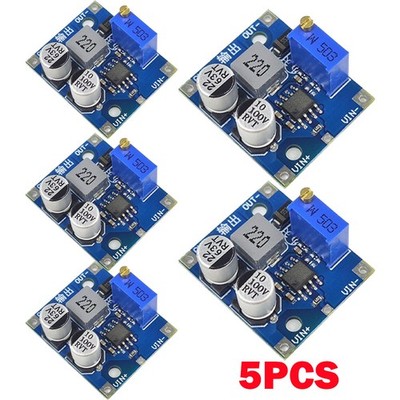

Just saw this little Converter with a useful input voltage and adjustable output voltage range.
This looks like an unadjustable version
Then there is this potted one.
Them sanding off the part numbers really inspires confidence.
