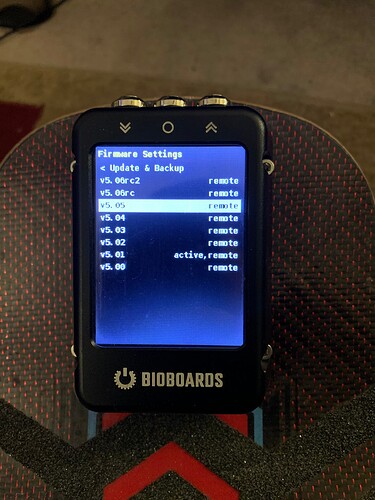

Hi @janpom - are 5.06rc and 5.06rc2 beta firmwares?
RC stands for release candidate, so yes.
I have my Davega on a battery box with the screen horizontal. There was a slight issue with not enough space when trying to view two different options example: speed & motor t. This latest version fixed it.
Yes, the v5.06rc2 actually only contains this specific bug fix.

What does the new v5.06rc3 come with?
I just updated the CHANGELOG. There’s nothing ground breaking.

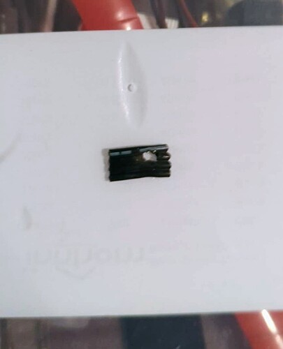

Just tried the latest rc against a llt 18s bms manufactured in 2020, while it scans it does momentarily communiate and lights up the ble in doing so but fails to interface. Metr pro on the other uart does manage to talk to it & render cell balancing.
@janpom If I can help with logging lmk
Np, I ended up doing the estimate visually like you said.
Metr module actually doesn’t talk to the BMS. The connection is established directly from the mobile app.
Can you please describe in more detail what exactly happens on DAVEGA? Do you get any BMS data at all, at least momentarily? Do you get any errors on the DAVEGA display?
Maybe this helps(sorry for lack of quality, hitting road for a trip & not back till NY)
Makes a connx then reboots & doesn’t find it?
Maker-X D75 f/w:5.3
DaveGA X V1.0 (5.06rc3)
LLT BMS manufactured Jul 2020 (f/w 25 according to XiaoxangBMS app)
  • default PIN : 000000
    MAC: F7:42:C9:38:C1:A4
I don;t see the BMS MAC listed but it definitely causes the LED on the BLE adapter to light up just before DaveGA reboots
fug it here is a closeup
