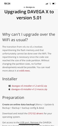

you have to update it by plugging it in to a computer
I see. Why is that? I can get the other versions just fine via Wi-Fi.
Edit: nvm, found it

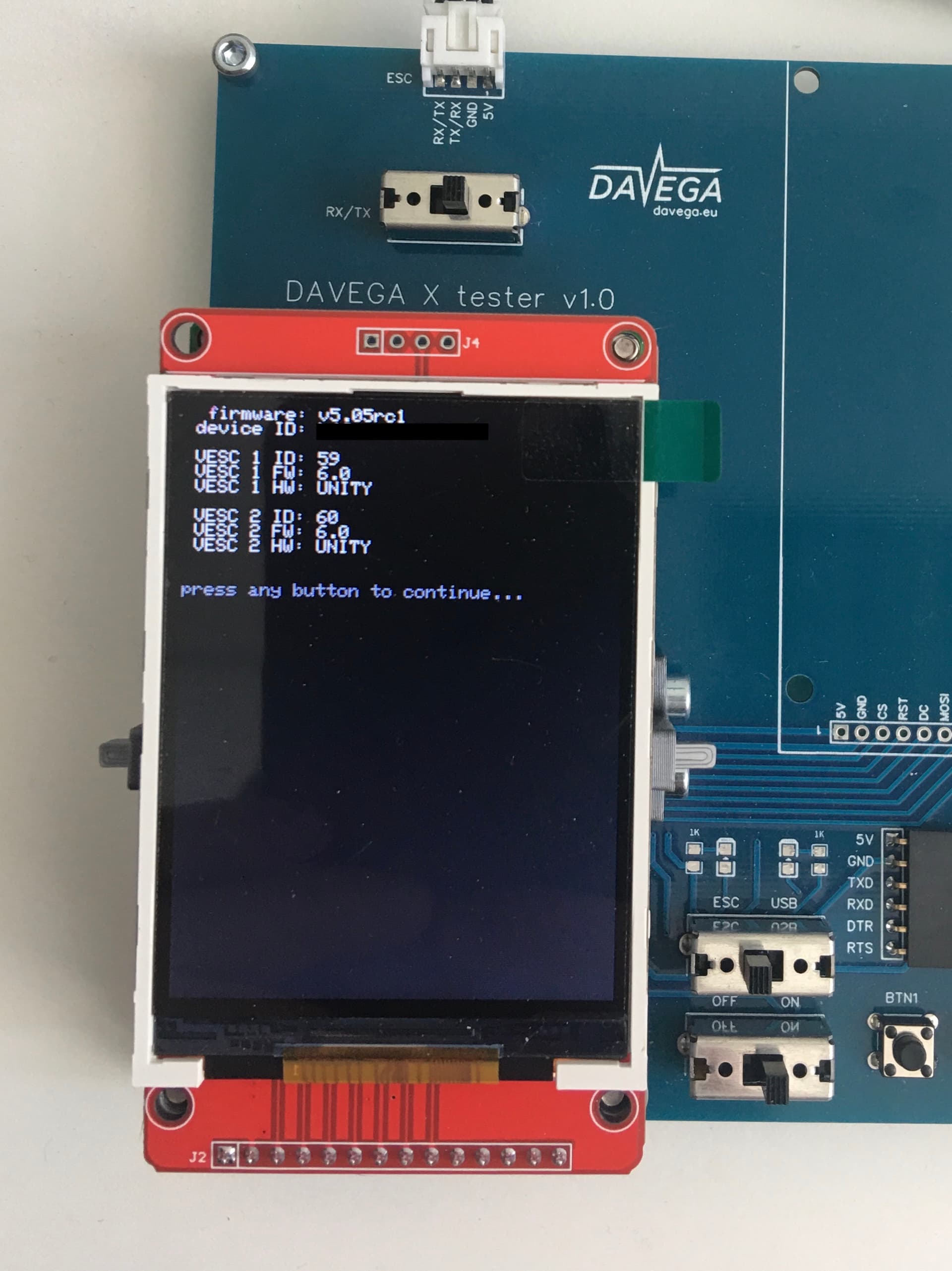

This is pretty neat, I’ll have to install this on mine while you continue working on the other part of the board config thing
Version 5.04 is not working with vesc 6.0 error msg says that only 3.x - 5.x version of vesc fw are supported, or something…
That’s expected. VESC FW 6.0 hasn’t been around for long. I’ll try to spend some time on it this week.
VESC FW v6.0 is now supported by DAVEGA FW v5.05 (currently available as a release candidate).

Hard to tell. Please see if you can reinstall the firmware. Follow the same steps as if updating to v5:
https://davega.eu/install-v5
Was able to update to v5 but the screen will still not turn on :confused: anything else I can try?

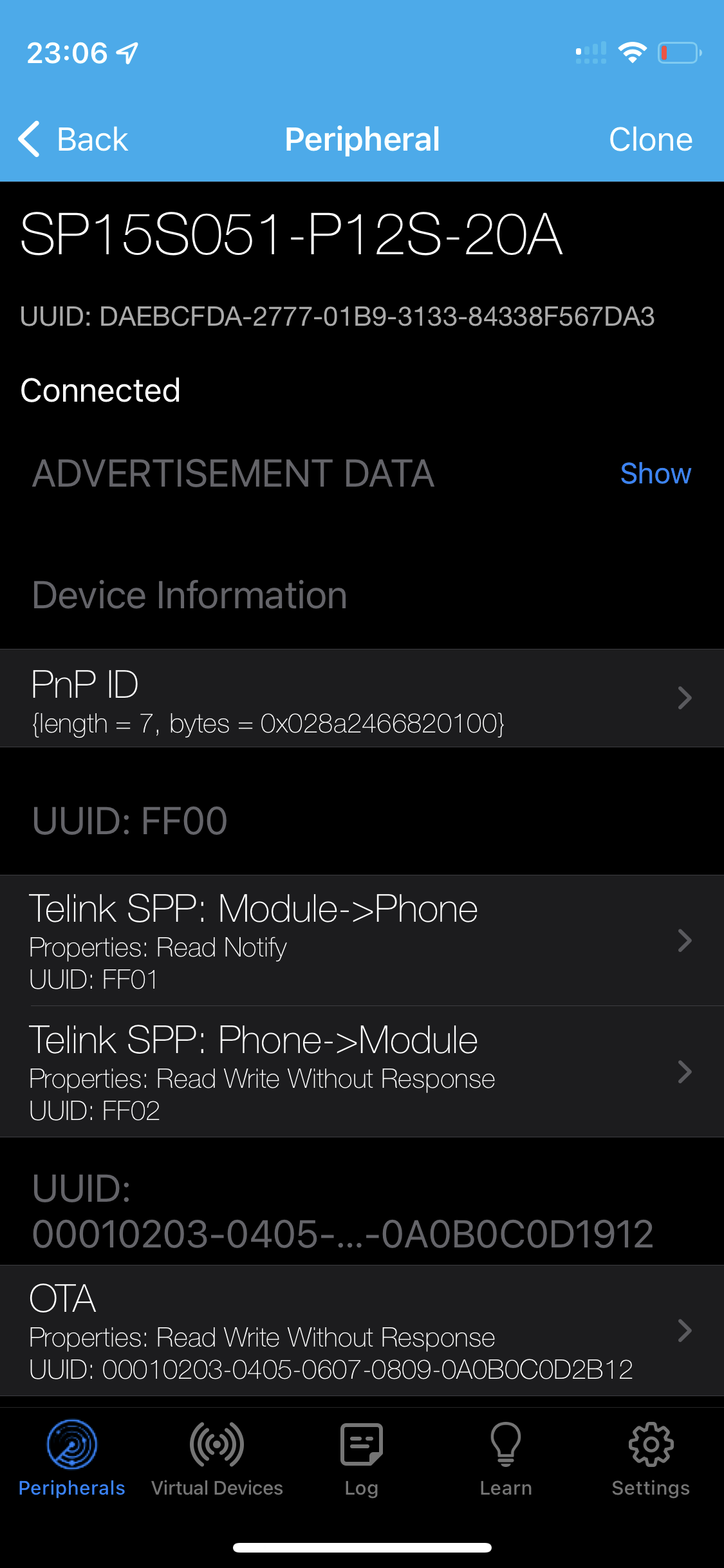

Is there a default Pin associated with the Davega to get it to connect to an LLT BMS? Its seems like it connects on boot then fails because of wrong pin. I’ve tried several generic and its must be at lest 6 digits. Any help is appreciated, thanks!
There’s no pin. It connects over bluetooth. However, the functionality is experimental and may not work correctly with all types of LLT BMSes. If you’re getting an error please send the error screen to me and I’ll see if there’s anything I can do to fix it.
It goes through about 6 boot cycles typically trying and once it connects reboots and tries again until that “failed to connect”. Then boots up without bms connection
I see. Is the mac address it’s trying to connect to (70:3e:97:07:ee:85) actually the address of the BMS?
I’m not sure how to find the address
Maybe this can help?
Just open the Xiaoxiang app. It should list the BMS along with its mac address.
