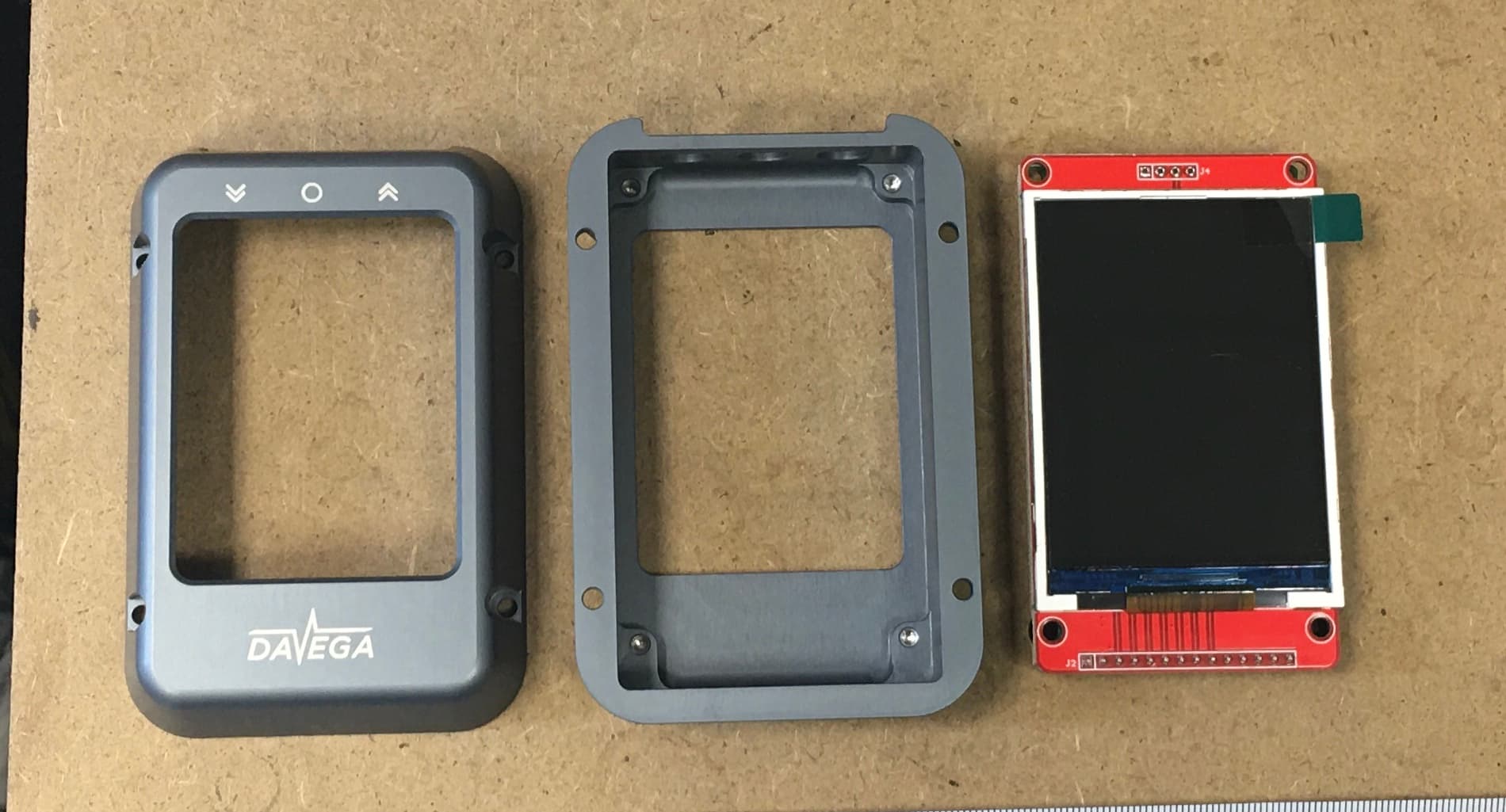

Bigger screen! Yeeeeees! Or smaller davega? Would it be possible to make the aluminum housing measure the same on all sides? This way in landscape it wouldn’t look like it prolly belongs in vertical orientation

For the most part, the housing shape is driven by the display PCB and I’m not in control of that one.
With the current display the symmetry could only be achieved by making the top part wider. I don’t think people would appreciate bulkier design though.

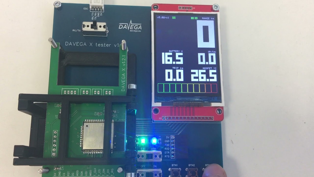

I improved the support for LLT Power Smart BMS in FW v5.02 (not to be confused with VESC FW v5.02). Here’s a quick demo:
