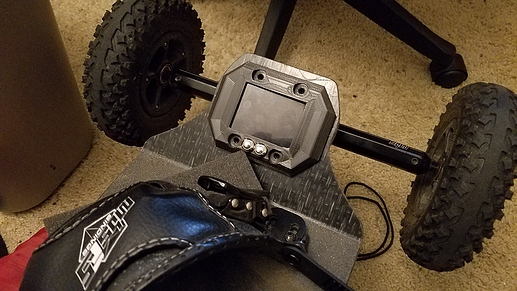

I’ve been working lately on re-writing the display drivers of DAVEga to work with the ili9341 touch screen display driver, and I now have the whole thing ported over to a level of feature parity with the original DAVEga found here.
I was never quite satisfied with the 177x220px display of the original, and I didn’t really want to have any mechanical buttons either, so I’ve been busy making this!!
This is a 2.8", 240 x 320px touch screen display showcasing the ever-popular DAVEga with scaled up UI components and a few buttons for touch interface on the screen towards the bottom (wip on either look/feel). Below it is the original display that DAVEga currently runs on for a size comparison.
I’ve also made and printed a custom holder for this that I plan to put on my mountainboard:
Link to the STL file for the screen holder
This version has the mechanical buttons as well, but I’m considering removing them and sticking only to touch input.
There’s basically no more new code changes that need to be made, but I think I understand better now by Janpom is opting to use a more powerful microcontroller than the Arduino Nano. With twice as many pixels to drive, there’s a lot more time taken on the SPI bus and it definitely feels much slower than the original resolution. I have an ESP32 coming in today to see if I can get it ported to that, but I have some concerns with touch screen library compatibility. If all else fails, I know for a fact that it will work without any issues on a Teensy 3.6. I’ve done several projects with the ili9341 touch screens using Teensies and the only reason I didn’t go to that from the beginning is I think if this is going to (hopefully) be used by others, I’d like to keep the overall cost as low as possible and the Teensy costs twice as much as the ESP32.
I’ll be updating this thread as it gets closer to posting the Github link and will also post about any new features/improvements to it here.

wow, did see any need for a screen untill now… :wave:
It’s great that you’re contributing to the open source version. I like the improved color gradient for the battery SoC. I will steal the idea for the new davega. :innocent: I’m not sure how much the touch screen features are worth pursuing. IMO the hardware buttons are more appropriate for controlling the davega since you don’t really need to interact with it that much and unlike the touch screen you can use the buttons while wearing gloves. Anyway, great job so far. I’m looking forward to more updates.
What if the hardware buttons were combined with a touchscreen?
Any realtime data you want to show has to be big and easy to process. Otherwise it’s useless since you won’t be able to follow it while riding. Once above 25-30 km/h, all I can do is take a quick glance at the speed time to time. I’m very skeptical about any kind of realtime charts. I can’t see how that would be any good except for testing things on a bench… at which point you can simply use the vesc tool.

Hmm… Yeah gloves might definitely make it a harder to press smaller buttons. The touch screens I"m using are resistive touch, so you don’t need finger-to-screen for it to register, just the force alone like the oldschool Palm Pilots is fine. Tradeoff is lack of multi-touch.
So far I’ve added the ability for each screen to run a ‘processTouchInput’ function alongside the normal update() calls, and you can pass into it the button states of the existing physical buttons. That way each screen can know if the physical buttons are pressed and use those inputs as well. Haven’t put any effort yet into a ‘settings’ screen but I think enabling/disabling physical buttons could be an option on there.
Also, you did a phenomenal job structuring the project. Very high code quality to work with :ok_hand:
Edit: Except for this one line!! lol I ended up spending a few hours trying to figure out why numbers weren’t showing up on the screen if they were too far to the right and it’s because uint8_t has a max value of 127 so any coordinate passed that will integer overflow/wrap
In theory yes. In practice, I’m not sure if you’d want to. I’ll see if I can get a gif or video of the lag to show it, but it’s definitely much slower to the point where it was pretty unsatisfactory for me. There may be some steps that can be taken to optimize how the big numbers are drawn, but that’s a non-trivial effort.
The other thing is that in order to use touch features, there’s 5 more pins from the touch display that need to be connected to in order to process touch commands. It’s still possible to use the existing physical buttons though.
tldr: Yes, but the experience is currently sub-optimal. Don’t bother unless some improvements can be made to optimize display rendering.
I haven’t stripped out any of the button functionality so they should still work the same.
Thanks for the compliments. I have done some coding before. :slight_smile:
uint8_t is an unsigned 8 bit integer so the max value is 255. This was enough for 176x220 pixels. Not a bug there. Obviously, with 240x320 you have a problem. :slight_smile:
