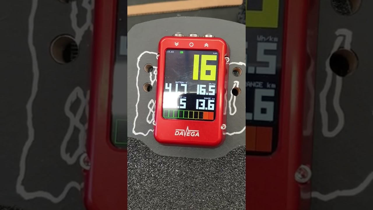

@janpom i have recently installed a couple of davegas (the latest hw) on maker x d75s with fw 5.3.
The refresh rate between the esc and the davega is incredibly slow and inconsistent on both boards. Is there anything I can check to see why this might be happening?
Hard to really see in the video but the little packet indicators at the top are just red most of the time while the board is actually moving
I see. Thanks for the vid. Do you have any other UART device that you could connect and test? Metr, Robogotchi?
@Oliver recently reported a similar kind of issue and he’s using the Trampa 75/300 VESC. I wonder if there’s something about these high voltage VESCs that’s causing issues in the UART communication.
The d75 and the d100 both use 100/250 FW, not sure about the d60.
I really don’t want to open these boards again but they both have bluetooth modules… i will watch the RT data in vesc tool while doing some zoomies and report back.
You could connect something to the DAVEGA cable (with a little adapter that I’m sure would be easy for you to make).
I just quickly checked with @rpasichnyk and he also had issue reports on Metr Pro (UART) with 75/300 VESCs so maybe there’s something wrong with the UART there. No reports for Metr Pro CAN so it sounds like a UART-only issue, but the evidence is still limited for being certain.
This is exactly the behavior ive been getting for a few months with my DV6. Tried almost everything and i couldn’t fix it. After a long enough ride, this behavior led to complete freeze of the Davega screen.
@Oliver just PM-ed me that his DAVEGA is not working well with VESC 75/300 when under throttle but when he switched to 100/250, all is well, so this indeed looks as a problem with some VESC types.
We also discovered that DAVEGA FW v5.04 has a nasty bug that causes an infinite loop (freeze) when you press a button while riding. (While it’s rare that anyone would try to press buttons while riding, a button press may also be triggered when you hit a bump.) So if anybody is having freezing issues on FW v5.04 please update to the latest FW where it’s already fixed.
