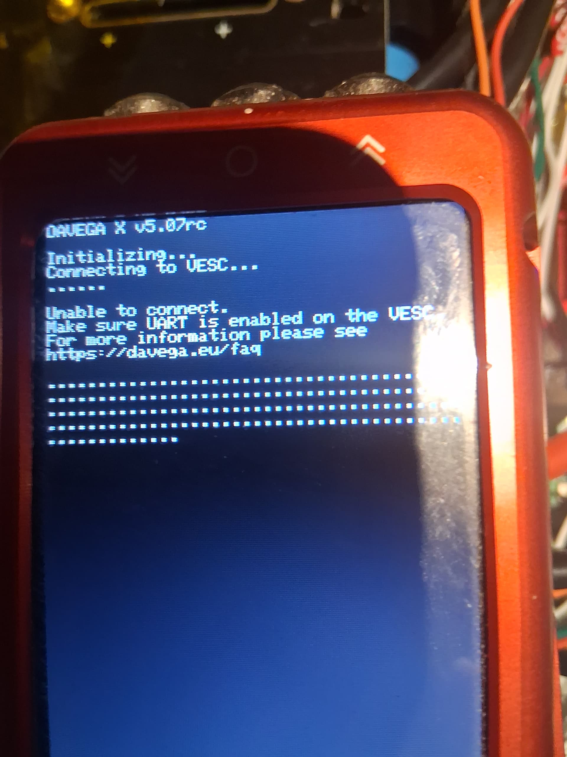

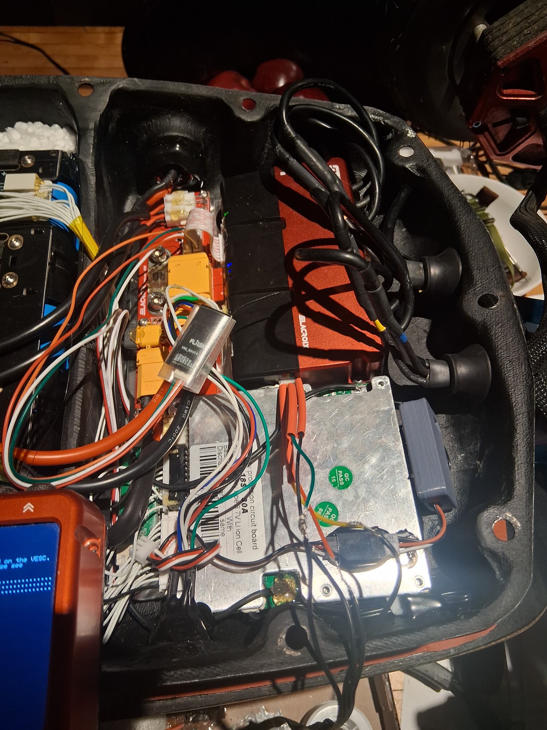

Thank you for the responses. I read the other strings on UART3 and I’m still a bit confused. The ESC is a Stormcore 100D in a Lacroix Lonestar Supersport. The VX2 remote is working great and it is connected to the Lacroix Sentinel via the 8-Pin UART Port (see pictures)
Here are my questions:
  1. Is it even possible to hook-up the Davega to the UART3 4-Pin Port on the side of the Stormcore and use the 8-Pin UART for a VX2 remote at the same time?
If it is possible, then:
  1. What am I doing wrong?

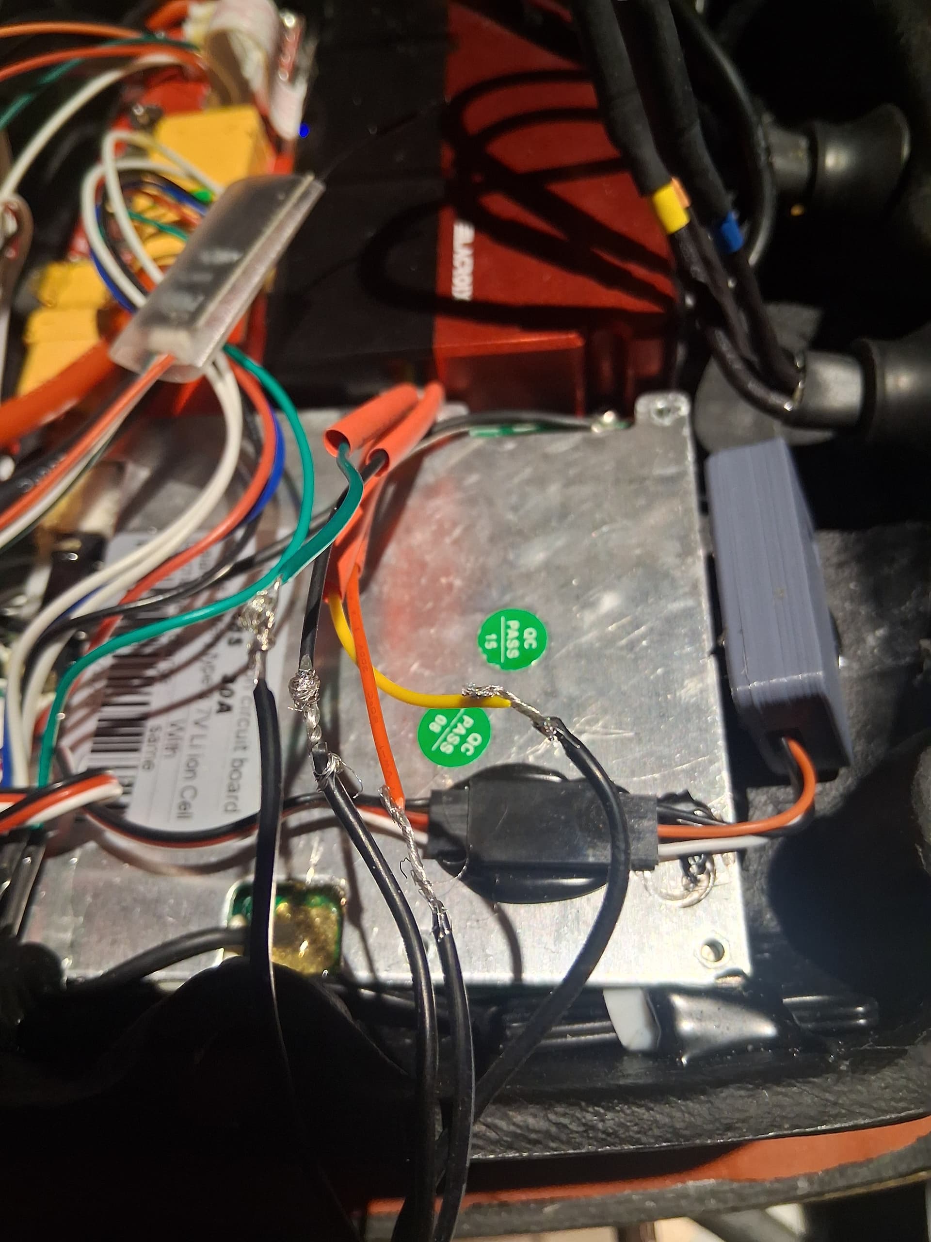

The Davega is getting power from the 5V UART3 4-Pin Port, and I double checked the RX3, TX3, and Ground wires to make sure they match the diagram on the back of the Davega.
The Davega powers up fine. But I get a message that it is not connected to the ESC.
I just twisted the wires together for now to get the Davega working and I will solder them once it works.
Please see pictures below.
i think the answer is no.
I think you could test for continuity between the tx pins on the two ports, (and/or rx pins). if they are connected then they have the early hardware bug, and only one is usuable at a time.
