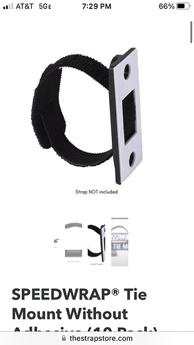

Mountain bike “clipless” pedals, which ironically you clip into, are pretty good in the dirt but something like this looks more appropriate
