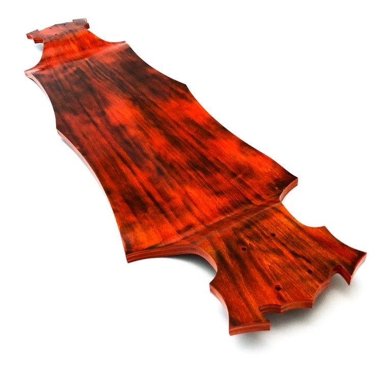

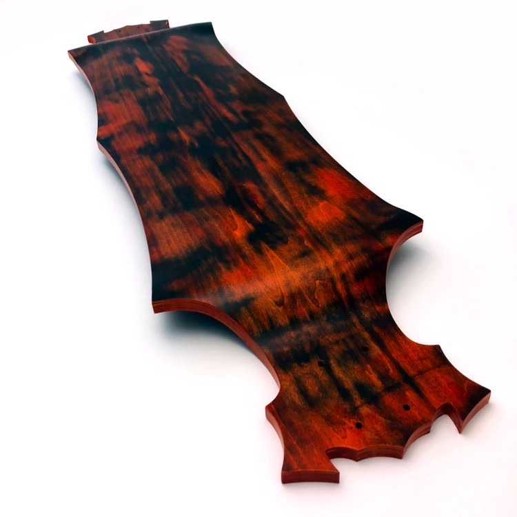

I have an unused set of super rare ( I believe there were only 2 sets made?) six shooters w/ tires and pulleys that I intended to use with this matching Red Ember Xapham
Let me know your thoughts on whether I should put these up for sale!?
I’d be down possibly, depending on the cost of this unobtanium.
dude that board oh my :scream:
That xapham is a work of art. If I owned it I’d probably make a wall mount and display it in my house. All though it would be a shame not to shred it on the street
