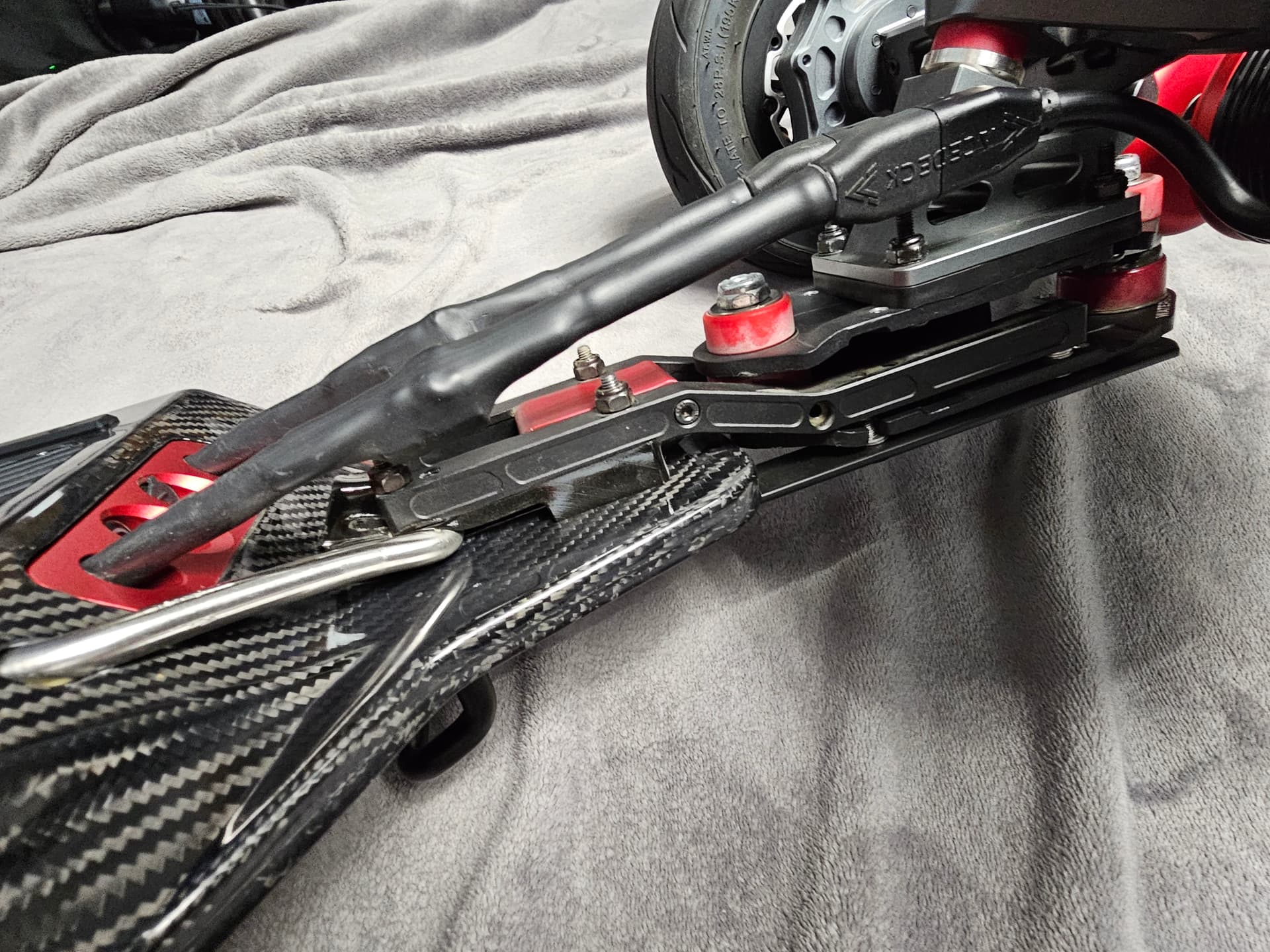

Hey folks, long time lurker here. I figured I’d finally share my first ever esk8 build. It’s a total Frankenstein project built around a 14S10P Molicel P28A pack, dual 6890 150kv 6500W motors, and Acedeck 4.0 gear drives with helical hardened steel gears.
The deck is a modified Omni carbon fiber deck with a custom full carbon lid, dual Waterborne surf adapters, and custom machined LDP brackets to double drop the whole thing. It carves like a dream but can still push over 68 km/h with 180mm wheels no problem. ESC is Acedeck 120A with a 140A smart BMS.
I’ve done a ton of custom machining and tweaks to fit everything together — it’s sealed, super rigid, and was built for both speed and deep surfy carving. First build I’ve ever done, and I think I am finally confident enough to post about it.

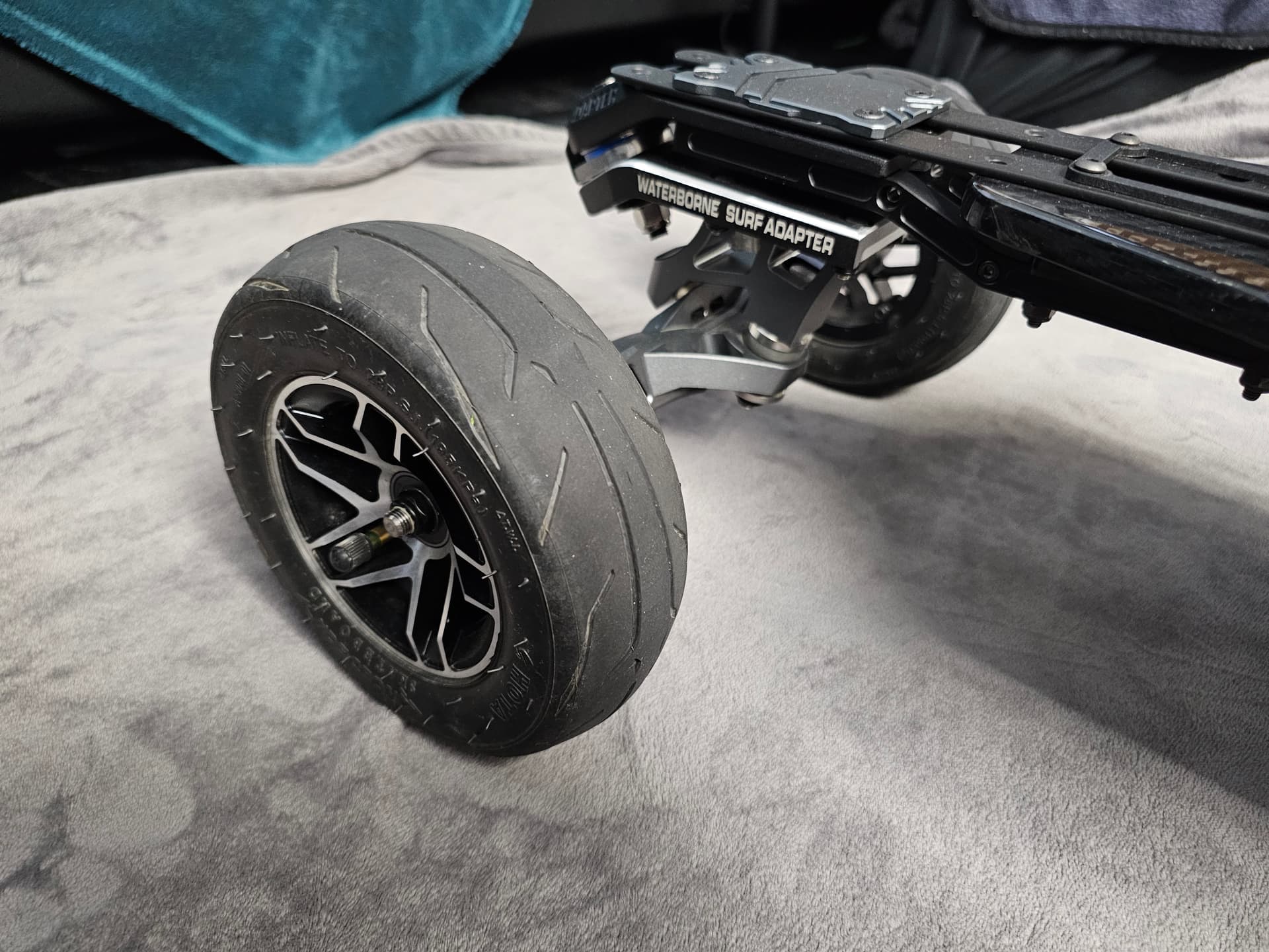

I have only used my waterborne adapter on short boards.
I do struggle to understand how the waterborne plays in the back of the deck?!?
Edit: nevermind . Looks like you have the regular waterborne rear adapter on there.
I thought for a second you had the surf adapter on both ends.

The CNC’d aluminum LDP brackets are pretty slim, so I was actually able to undermount the front. and rear surf adaptors, I just had to use taller bushings on the rear adapter. The dive is insane, and it give the rear truck kind of an eerily calm vibe through turns, even at high speed. It really makes it feel like snowboarding.

I am using the 97.5A durometer square bushing for the front adapter, and 96A duro KranK barrel bushings for the front TKP. It makes it stable to stand on, but has so much yield to dive into a turn.
The rear TKP has 95A APS barrel bushings, so it does not want to turn much, and the rear adapter has 93A WFB chubby barrels, since they are so fat they want to stay upright, but because they are prelubed WFB you can get super deep into a carve and feel really locked in.
Since the board is so long, you get a super stable divey turn on a time at low speeds, and at high speeds, the front adapter starts to self level since it is so far in front of the board, so you really have to get into the carve at higher speeds, but it feels so stable, like you are planted and buckled in.

There are multiple generations of Waterborne adapters, and I have heard of gen 1 ones breaking, but this is technically gen 3, and Gen 2 and up have been reinforced pretty dramatically. I test drone the adapter quite aggressively for a year before starting the project, because at 260 lbs, I didn’t want to crush it and die at speed.
Past Gen 2, if anyone broke one, that was definitely user error. The adapter has less flex than the entire deck, which I reinforced with stainless steel.
