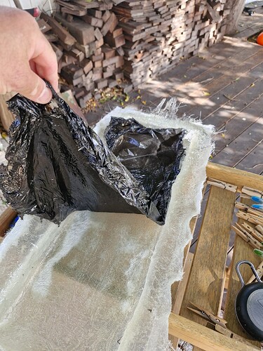

Just pulled the fibreglass off the mould and it came of surprisingly easy! This may not be news to anyone, but this plastic film stuff worked a treat for creating a non adhesive layer to the mould. I didnt use any grease or anything, just wrapped the deck and mould before applying the fibreglass.
The enclosure will definitely need some scrubbing up, but overall has a decent and symmetrical(ish) shape
Grab some qcel dude. It’ll make sanding a nice finish a bit easier.
Nic one! Now to get itchy!
I find when glassing, you need to plan how you are gonna do it first, cut all the pieces and place them in order of laying down.
As @sugandese said I use cheap Bunnings clothes vac bags with 4 layers then just paint a few layers of resin over to get a smooth finished surface. I use epoxy resin though… Found it easier to work with on xps foam.
