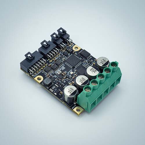

I’m currently working on a project where I want to build a stationary bike that uses a BLDC motor as a braking mechanism. The idea is to press the motor against the rear wheel and use a VESC to control the resistance. The resistance should simulate terrain conditions like uphill gradients or slopes.
The concept is that when the user pedals the bike, the BLDC motor will act as a resistive load, providing torque that opposes the pedaling force, as if the rider were going uphill. The harder the simulated slope, the more the motor will resist. I’m not using the motor to drive the wheel, only to actively resist the rider’s pedaling, based on terrain data.
To do this, I plan to use an ESP32 to process slope and elevation data from a virtual ride, and then send appropriate commands to the VESC to adjust the braking torque in real-time.
My main question is: what’s the best method or control mode in the VESC to achieve this kind of dynamic braking behavior? I’m considering FOC current control, but I’m not sure if that’s the most suitable approach. Is there a way to control regenerative braking torque directly from the ESP32? Also, are there any similar projects or references that might help guide my implementation?

I dont think you’re gonna want a setup that uses regen. You’re going to have to put it into a battery, then drain that battery.
You’re going to want to run it in duty cycle mode. You won’t need a throttle because you are trying to achieve an RPM of zero. Then what you need to do is have your computer talk to the vesc and change the motor current limit according to the amount of resistance want. I know this because I recently just built a roller Dyno using a vesc and a bldc motor as the load

Maybe could set the max erpm limit to almost zero so it’s pretty much stationary from its own power but could manually pedal in the opposite direction and use the throttle to increase resistance
@Evwan brings up a great point. You’re going to be generating energy by your pedaling, so you’ll need to decide what to do with it.
If you’re set on using vesc, you could use a wall power supply, then have something like an odrive regen clamp to dump the vesc braking current into some power resistors. It’s a hacky solution, but it’d work.
Just using an odrive might fit what you’re trying to do a bit better, though. It supports brake resistors out of the box.
You could also use a battery and have it be far from fully charged. Regen is very inefficient, a 1kwh pack should let you do a lot of testing before it fills.
:arrow_up: this. Just start with an almost- dead pack. Plug it in to discharge between uses.
