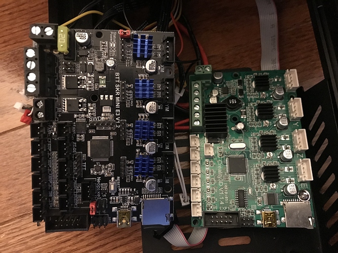

There are a lot of replacement boards out there for the ender 3. Lots of them claim they’re silent. Which do you recommend?
The big tree board seems mentioned most and looks like an easy switch.

I just put in the 1.1.5 board and it’s like night and day. I modded my venting system with silent ones and these are what I still hear :sunglasses:
So far just moving my printer around, it’s dead silent.

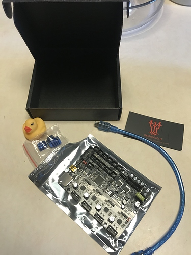

For everyone else, I just got the skr mini E3.
It’s a plug and play board for the ender 3.
If you use a BL touch, the wiring harness needs to be swapped around.
I just put a petsfang on as well, will drop the new firmware and try out a few calibration prints with the new board tomorrow!
The SKR Mini E3

Made a huge difference with the new SKR board. I’ll post some pictures of the prints tomorrow.

If you’re buying a boars, your best bet is likely the SKR mink which is a drop in replacement and $35. That will make adding bed leveling sensors, software controlled leds etc etc much easier
