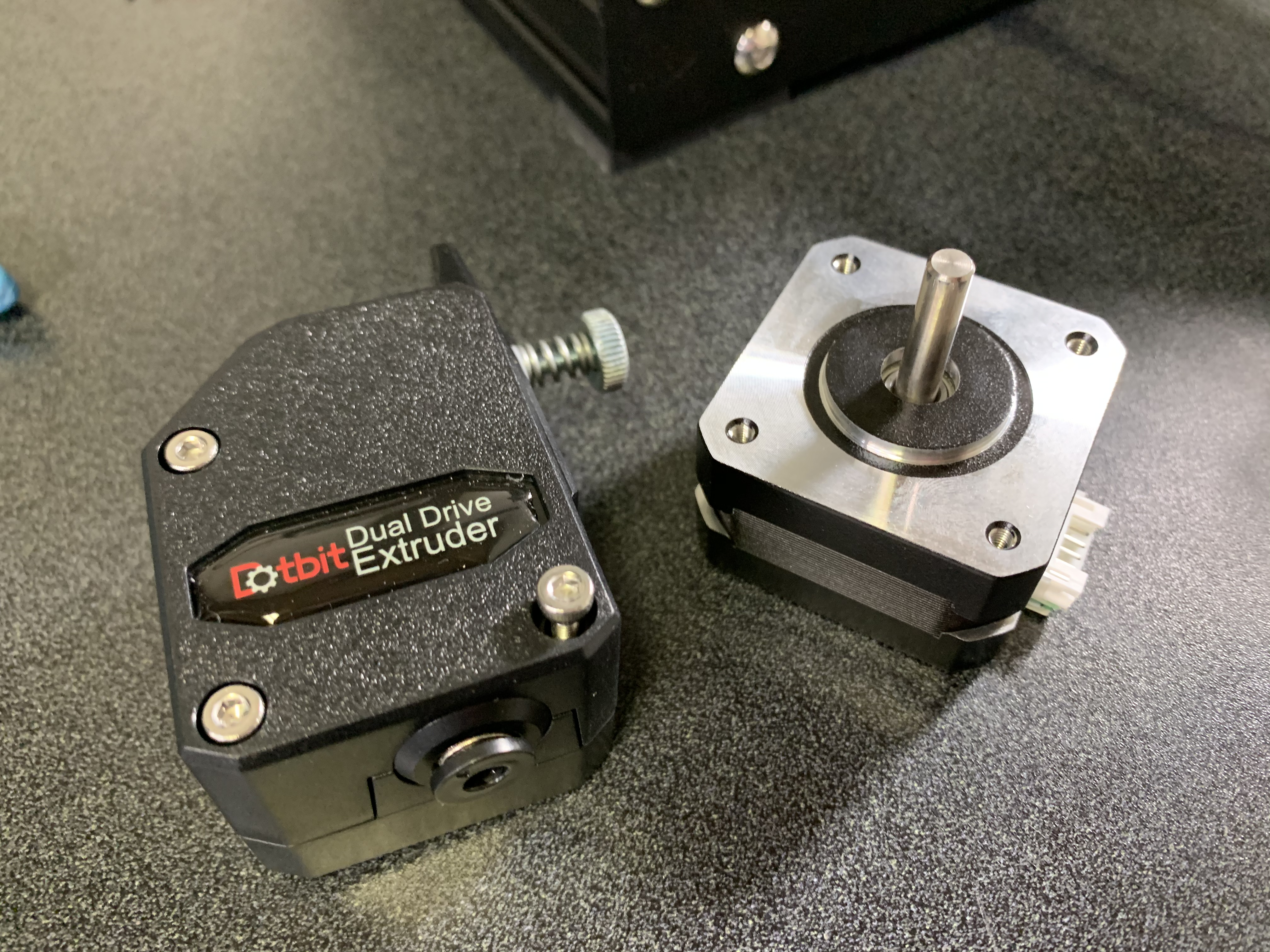

I finally appreciate the impact of good cooling (where appropriate) along with a direct drive extruder. The stock motor works great, but I definitely see the affects of the extra moving mass. Time for gear reduction and a smaller motor!

Fun day… I ordered the wrong motor (too thick). :joy: I’ll use a sideways mount with the BMG style extruder… it will still reduce the moving weight compared to the stock motor.
