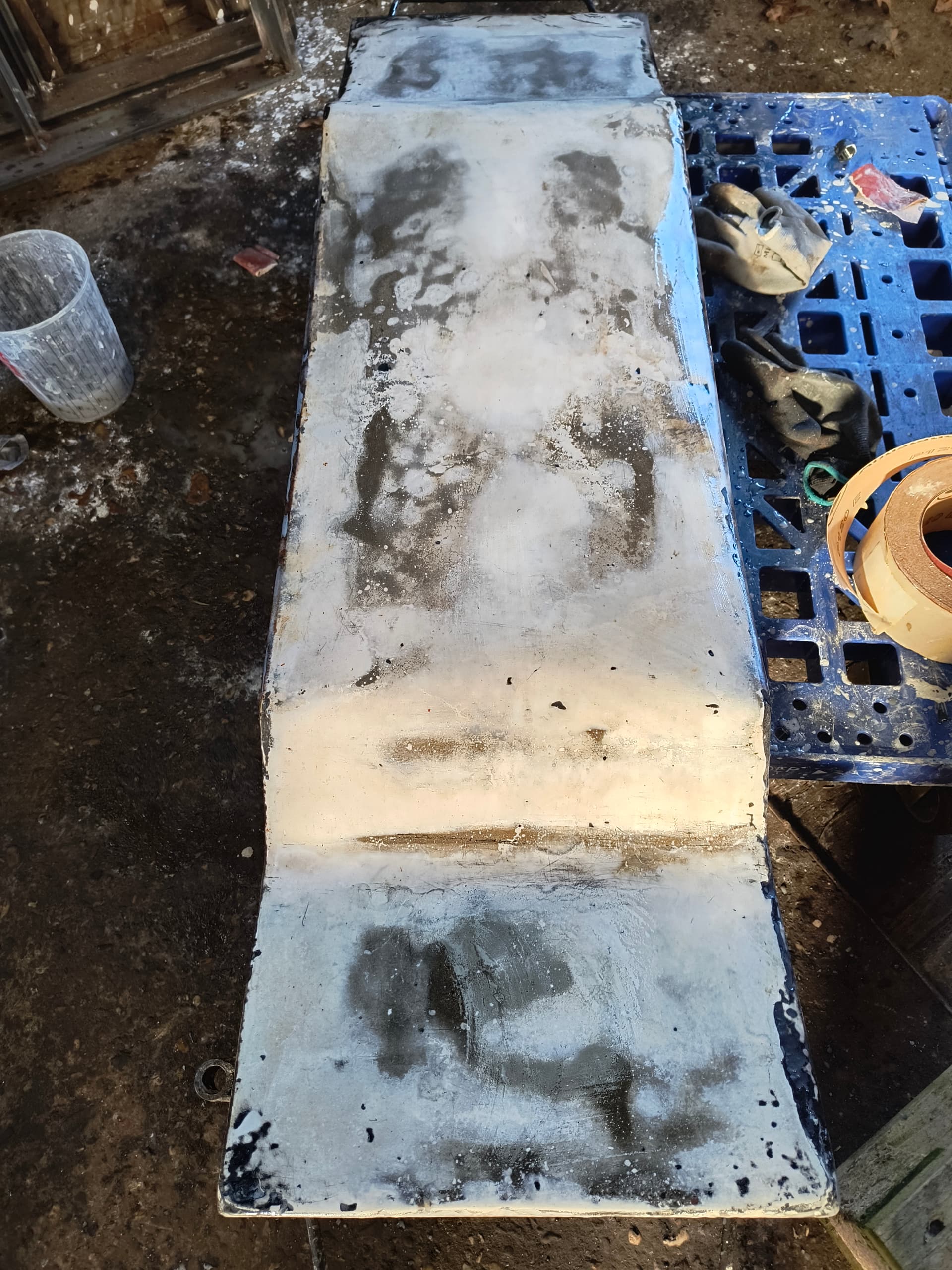

The pictures i sent are not the end result btw, i havent taken pics, will do in a sec.
Keep at it man you’re so close. How are you testing the twists are you just eyeballing it?
No im adjusting the nose/ tail with a level. The dents in the concave go by feel/look. I scraped the nose/tail with a plate so there are minimal dents in that. The small level differences will be polished out when the epoxy goes on.

So, this is STILL alive and kicking even. Apparently its a lot of work, who would have guessed :melting_face:.
Last testing press was good.
Still some imperfections but im happy enough to go through. Bottom half of the mould is epoxied, once with glass beads, then an overcoat. Its been polished, now to finish the top half! First coat of glass bead epoxy has been applied. So close!
Next time i make a press, it will be a fully glass fibre variant.

So, because i also want to press composites i was not happy enough with the smoothness of the mould, i coated it a few times with epoxy and sanded it. Then to see pits etc, i painted everything black and sanded everything back to paintless, this way i can see some dents in my epoxy and patch it. All in all its a lot of work, but im getting there.
Its winter here with a lot of rain and even some floods, so its complete ass to do anything. Because of the moist, a corner of the plaster swelled up and broke my epoxy coat so now i have to fix that too, but that goes with the filling of the cavities.
Excuse me for the poor quality pictures.
The mould is a smooooth boy though.
