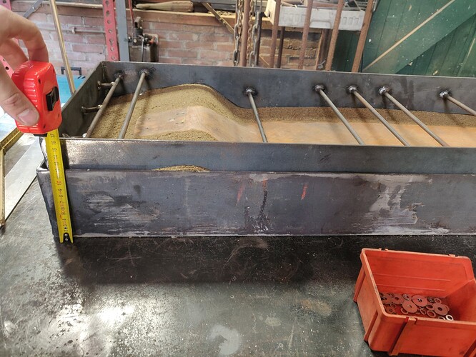

Checking if fitting sheet is possible.
Placing deck in mould and filling empty spaces with setting sand. We used this:
Make sure to extend the curves of the deck as shown in pictures, this will take some time but make sure to do it in a timely manner, the sand dries up and is not good to work with anymore.
Place plastic sheet on top.
Filled with concrete.

now that I think about it, does this method conserve the concave on the y direction ? looks like you get only a xz profile ?
If you look at it it does, the sand is modeled so it extends the curves of the deck. We only modeled the sand flat where the mounting points of the trucks are.

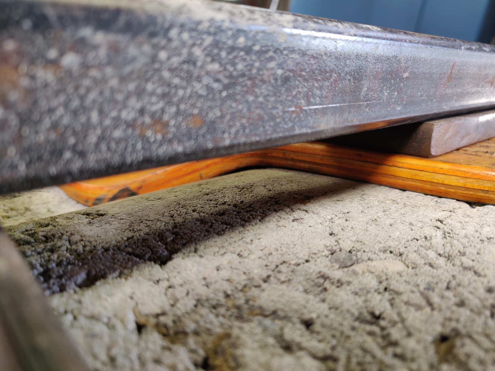

Then it came to notice that the deck all of a sudden didnt match the curves on the mould exactly anymore in some places. There could be some reasons for it.
  1. The deck works with the weather, its currently hot and dry.
  2. The concrete shrunk when it was drying causing it to not fit exactly
  3. We didnt press the concrete hard enough, however since this previously didnt show this is unlikely.
So,since the deck was standing off a little bit it has to be ankered to the mould for the second phase.

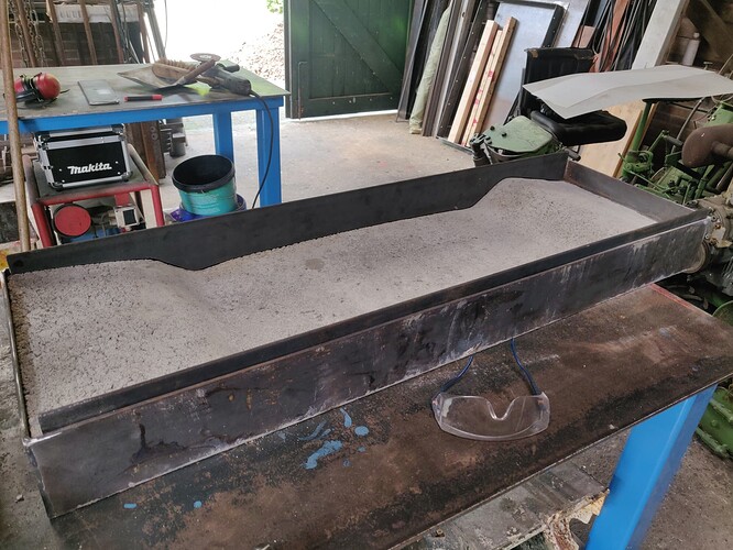

Filled with sand and made nice.
Put in second part of mould and made sure all the corners are the same height.

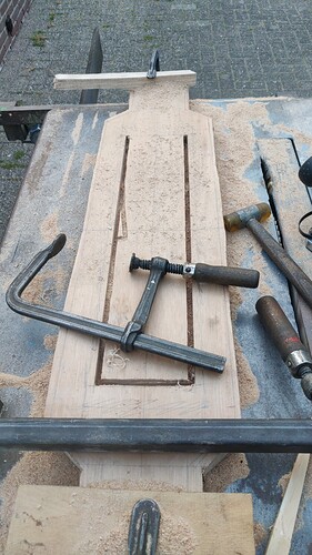

In the meantime i was helping my friend with his personal deck project. We made a mould out of MDF and pressed his deck, he wanted it mostly flat (there are concave pockets to it though). Hes still a rooky diy-er and kinda clumsy so im proud of him!
Still a WIP ofcourse but i can see it going well.

Also the sand might seem curved weird in the pictures, however thats due to the shadows.
