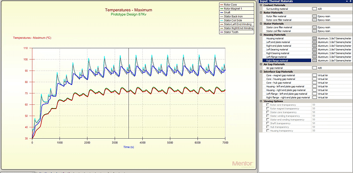

I did some simulations a while back trying to see if I could use a 5055 motor as direct drive, and one of the studies was to replace the air in the airgap with oil, the difference was considerable, in trying to find it but I don’t think I saved the graphs

I’ve found the simulations using the oil vs air in the air gap, both have the same loading conditions, the only variable is changing the air gap material, with Statorade the results should be a little worse since it is does not fill the slot completely. The first one is with air, windings temperature peak at approximately 104 ºC. The second with oil, we get a peak of just 65°C, meaning we could for example as others said, use N52 magnets for better torque and efficiency or keep the high temp ones and push much more current into the motor
AIR:
OIL
These are the tests from Justin with the Inboard motors, the main takeaway I get from him is that a sealed motor with Statorade has better heat conduction than a vented one, and that is with a hub that is thermally isolated in most of its surface, with our direct drives the diference should be even greater
