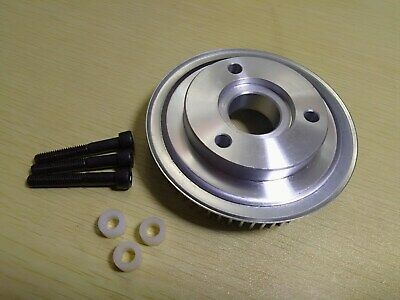

I am not sure what eMTB pulleys fit the “tri spoke hub” but I’m fairly sure something exists. If not it seems possible to attach a standard HTD pulley to it.
Curious if this fits the bill from dickyho
Good eye! I have a set of tri spokes at home that I’ll measure and see if they match.
Tagging @Fosterqc because he might be interested as well.
Ok that pulley doesn’t match up with the tri spoke hub.
On that same listing, you can select an option for pulley and wheel though. Then you would only need belts and the motor pulleys. Much cheaper going that route but his wheels are 6". IMO that’s good for you wanting an all terrain board and not strictly an offroad board.
