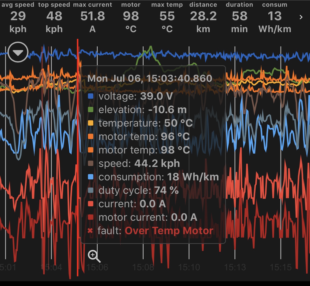

Constantly overheating motors in dual setup

Check if the motor is actually hot as others said

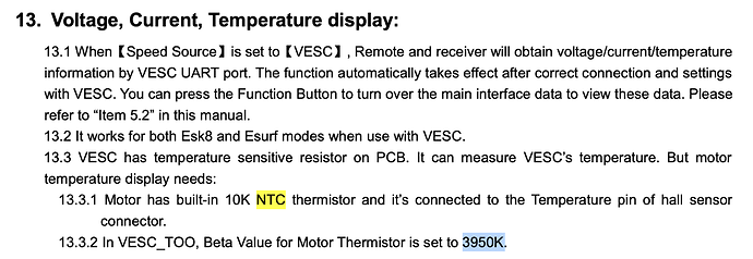

The beta factor of the temp sensor has to be right for the displayed temperature be correct
@esk8manbabes what beta factor do you have in your VESC? lets compare to what he has

I haven’t touched the beta value so it should be at its default value of 3380.0 K from the tool 0.94 that has the 3.37, 3.38 firmware support.

Have you solved this? I have the same Maytech 6374 190kV sealed motors and they get way too hot, up to 100 degrees. You cannot touch them, you’ll burn your fingers, it’s not a misreading.
Metr:
I did actually change the beta value just now. Only because I read this in the Maytech remote manual and I figured Maytech knows its own values best:
But changing the beta value doesn’t change the actual overheating and upping it from 3380 to 3950 has barely any impact on the reading.
Apart from that, I’m testing it with the motors unloaded, no wheels, no gears, just up in the air and freewheeling. They get over 50 degrees within 2 minutes. I used a calibrated thermometer to check, I was measuring 49 degrees on the can while the sensor read 52 degrees in the can, checks out to be correct. I have no clue what I can do about it, this is just weird.
Seized bearing or something like that? Theres a crazy loss somewhere, probably new motor time unless you got a good bearing puller, shoulder bolts and patience.
