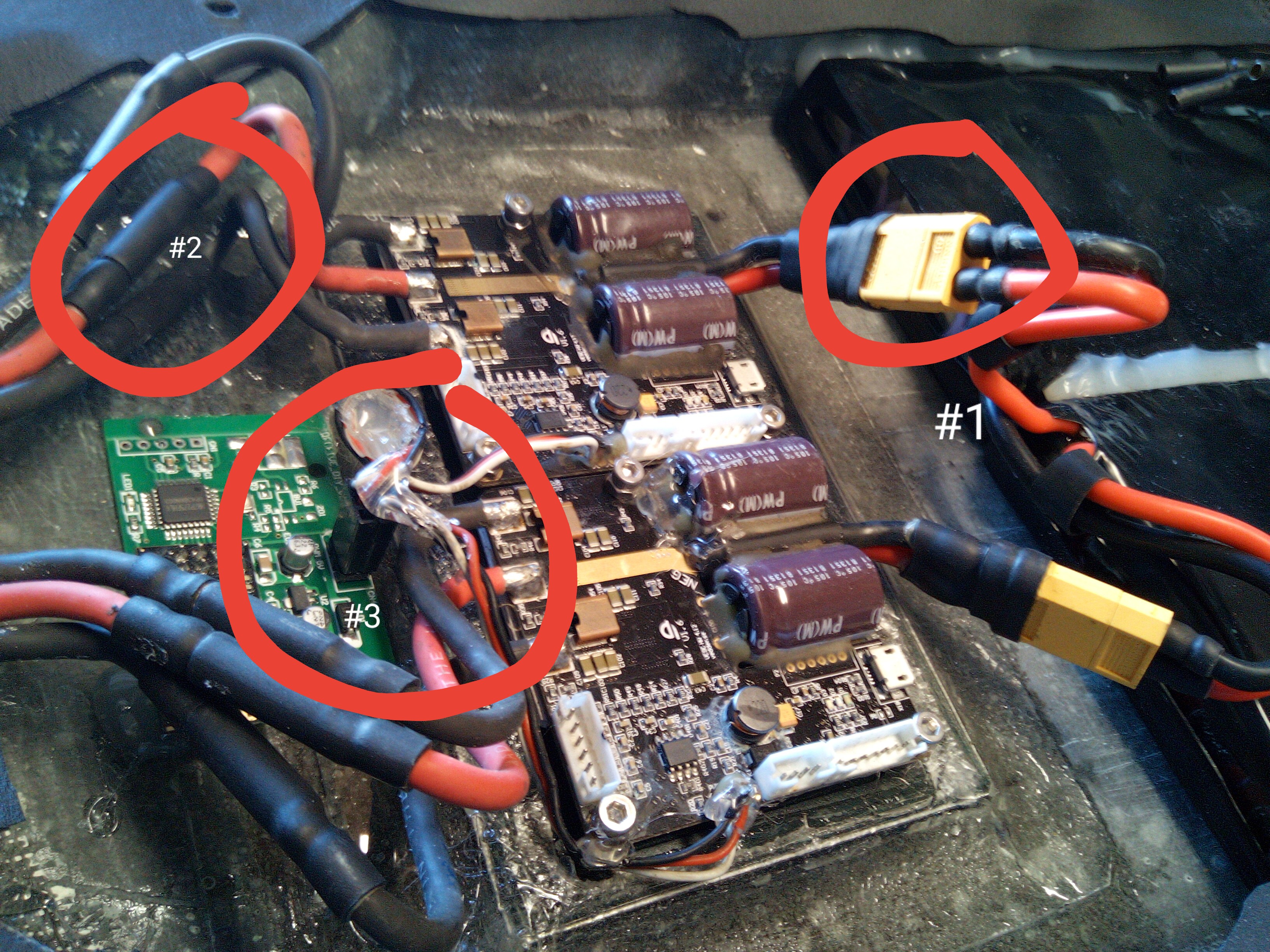

I stole this image off google.

Photos of your setups would be amazing, as it helps the words make so much more sense.
