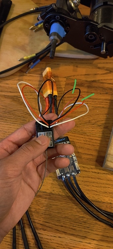

Would I do something like this:
Cut the ground/neg and +5 so one vesc has all 3 connections and the other only has signal?
No; you want both ESCs connected to the same channel on the receiver.
Hmm so would I have one ESC connected to a single channel with the second ESC’s signal wire spliced onto the first esc signal wire and the +5 and ground snipped from the second esc?
Yes
Just run the white wire to the second ESC
