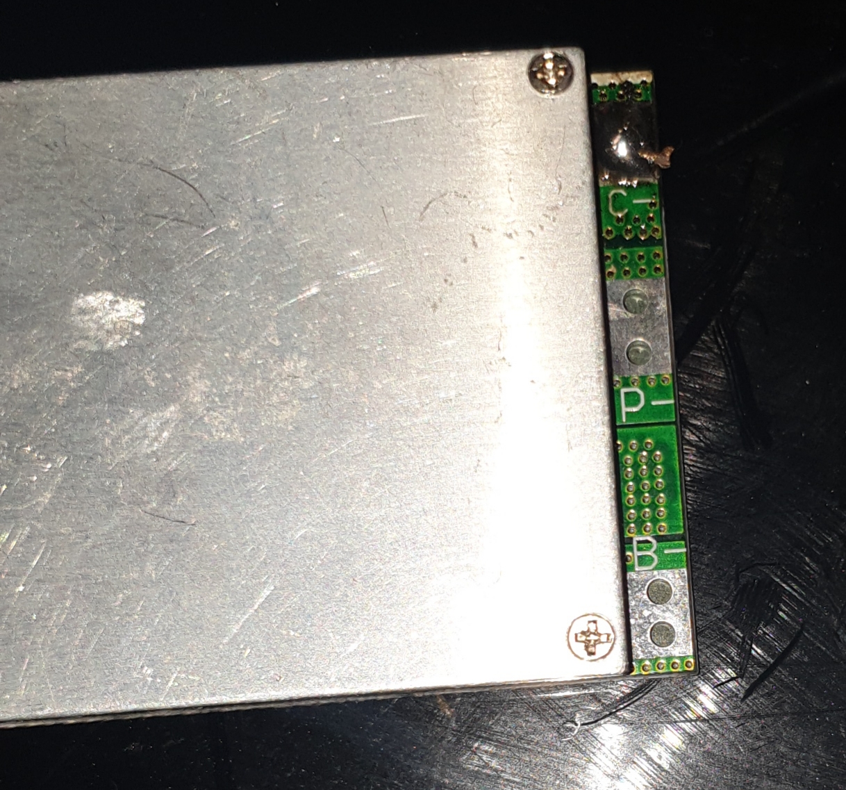

This is the BMS there is no where to connect to B+ but an obvious spot to connect B-

@Mainflow unfortunately no, I got i t from ebay last year and checked back today on the listing as well as similar ones to find a data sheet but it just has pictures in the listing no actual information. It does have B0-B10 as per the diagram above.
