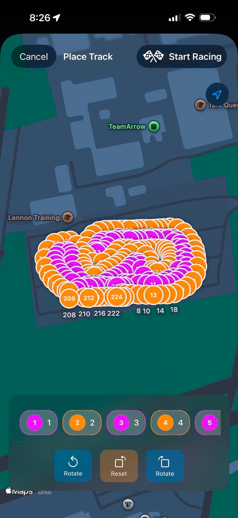

What about augmented reality? AR over a live camera feed should mean that even if it has unexpected deviations it could accurately place the cones.
Thats what I was thinking, having the app first to ā€œhuman botā€ might be a great start :smiley: Actually if the app uses external GPS like Racechrono it might be pretty accurate.
The app just needs to show you if you are close enough to the zone where to place the cone. For example with starting/selected point of the track layout being at your current location.
I think it is 5x less convenient than charging and setting up a cone bot but 50x easier to implement.
It looks like this.
What Tuckjohn said about parking spaces is genius since you can’t really compare where you are to the lines enough but you can compare the lines to the terrain.

I had an idea of manually making pin coordinates on google maps for precise localization and then stringing those coordinated pins together for a bot to move to
Super basic but some sort of manual path needs to be made for the robot to follow
Manually making a trackmap also seems reasonable for anyone else to do, the annoying part is just spending the time hashing that out, so its really up to user to make the most of it
