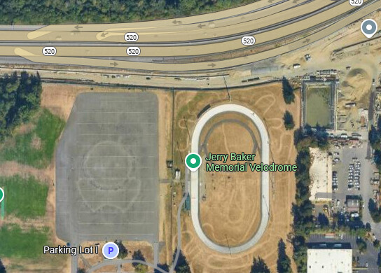

One of the local parks has this massive paved lot
and I have a ton of cones in my carport, so I might just tag along/help out on this project :slight_smile:
