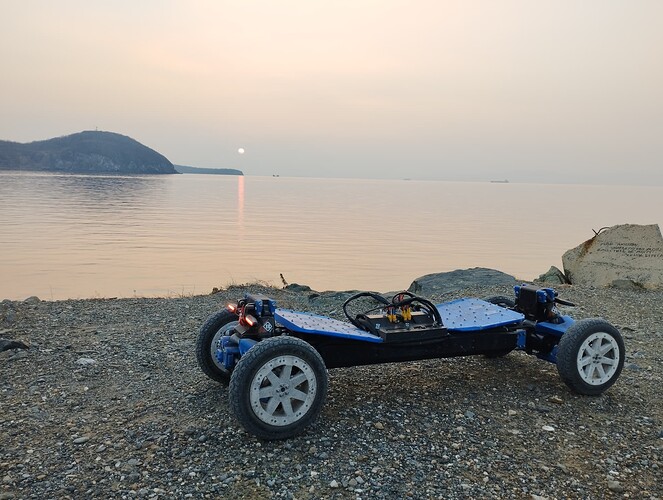

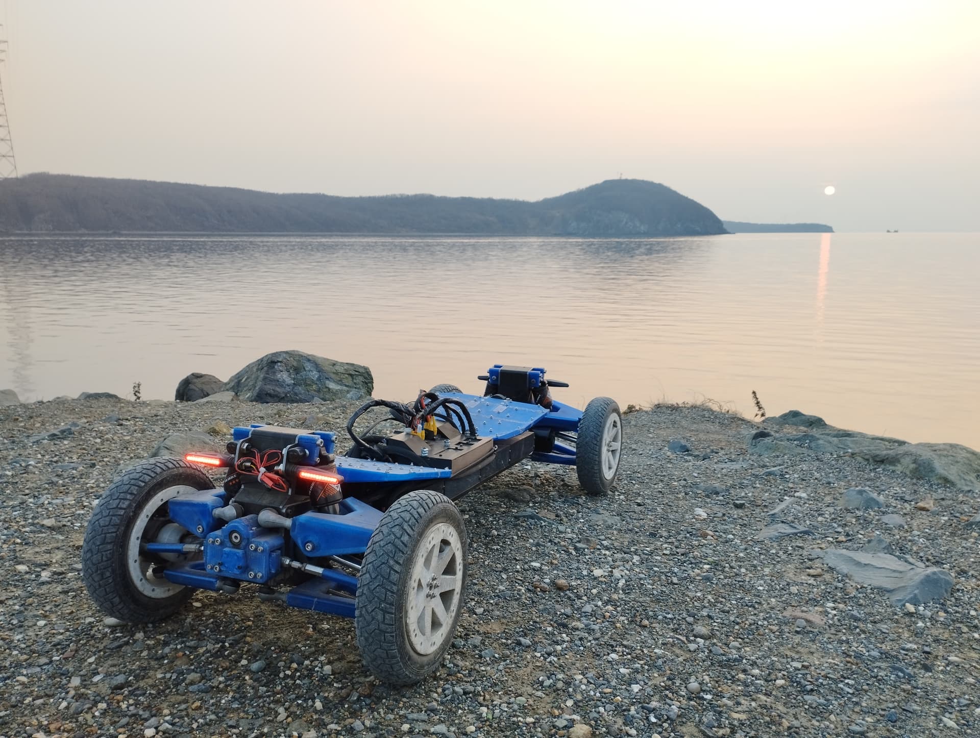

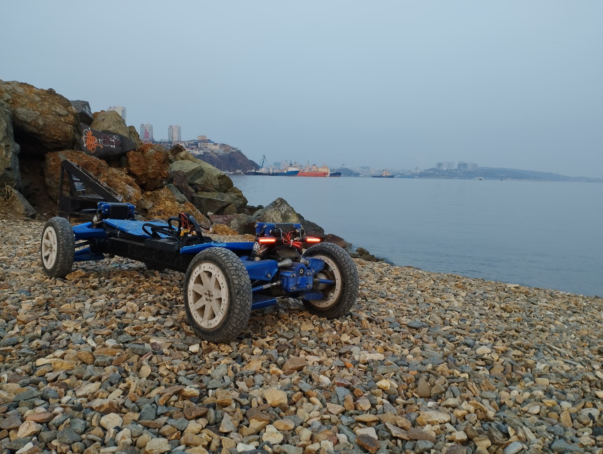

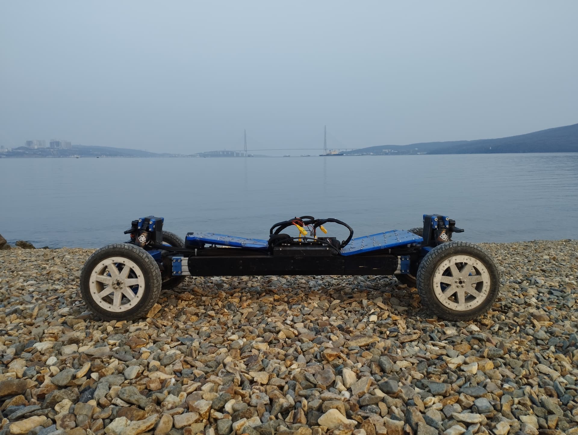

Hi there, want to show my 3D printed electro-mountain-board. Features:
  • Independent double wishbone front and rear suspension with 70 mm travel, 10 inch wheels;
  • All-wheel drive (one 6374 motor for each wheel), 50 km/h max speed;
  • Completely 3D PRINTED SUSPENSION ARMS, wheel disks, DRIVE GEARS AND SHAFTS, gearbox housings, steering racks and pinions, cases for batteries and electronics (PA-12 for pinions, PETG for everything else). Main frame is made of aluminum profile and sheet steel cut on a laser machine. Suitable for self-assembly: welding, gluing, milling and other complex operations were not used. Final cost is about $1500 and 2 months for printing and assembly.
  • Unusual steering. The deck is divided into 2 parts: rear part is rigidly connected with the main frame, and the front part can tilt and control the front wheels. Never felt any wobbling, but the load on the back leg and the turning radius seems a bit big.
  • The frame and suspension tested with 60 kg rider for 1000 km of poor quality roads and it did not break (for now). Drive gears and shafts tested for 2000 km and still looks ok.
In terms of transmission and suspension, it’s just a big 3D printed RC car with foot platforms or something like what the company BajaBoard produces, but cheaper, less quality and with different steering.
Current version is not perfect, but it WORKS! I’m going to correct some small mistakes about wiring and inconvenience during assembly and then publish the files as an open source project that everyone 3D printer owner could repeat or change a little. I’ll add details to this topic later.

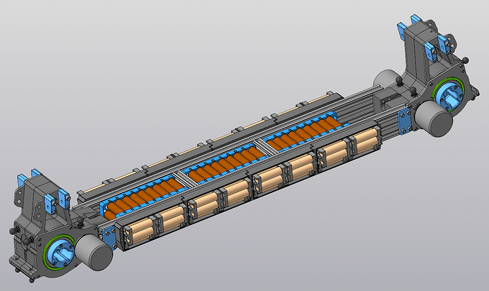

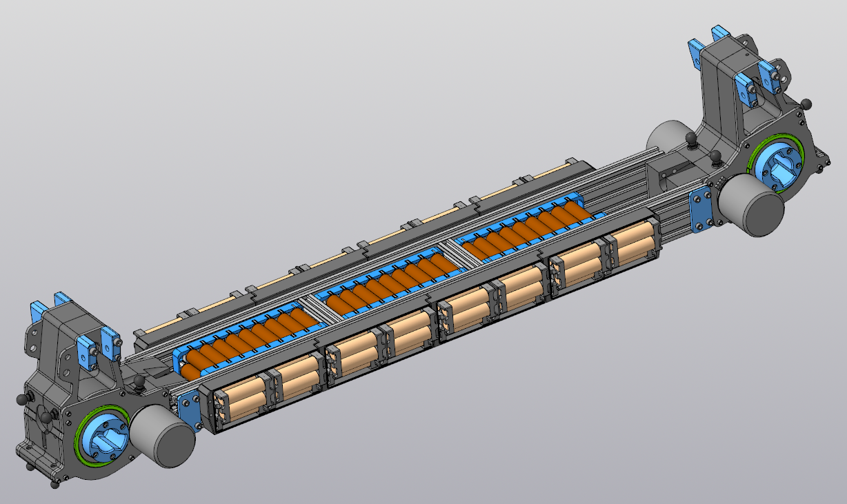

Frame with motors and 18650 cell batteries:

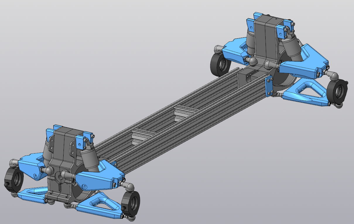

Suspension:

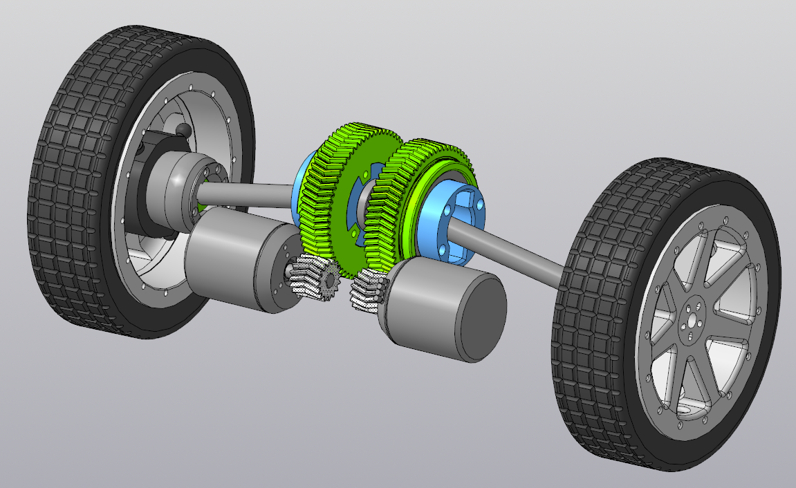

Gears and shafts:

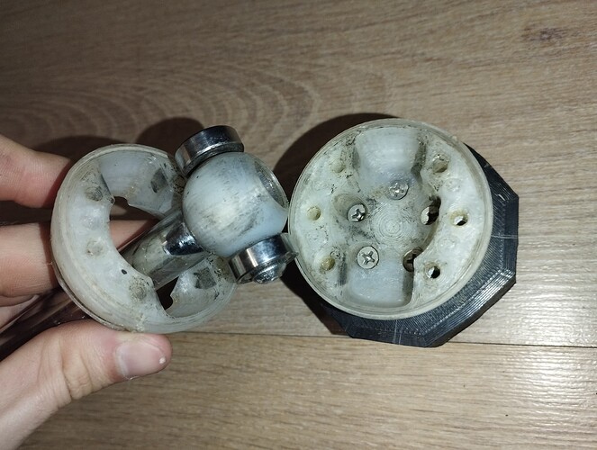

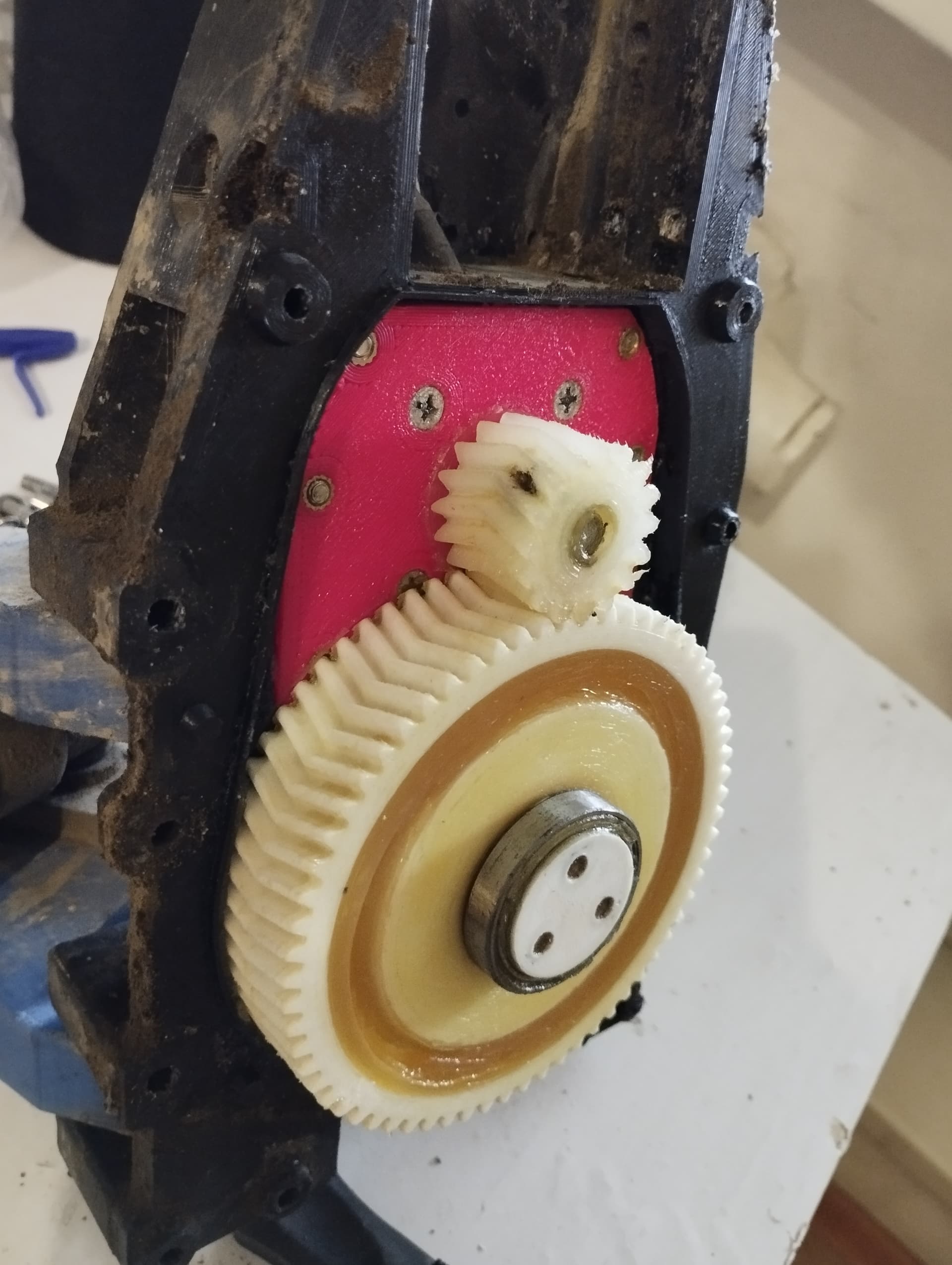

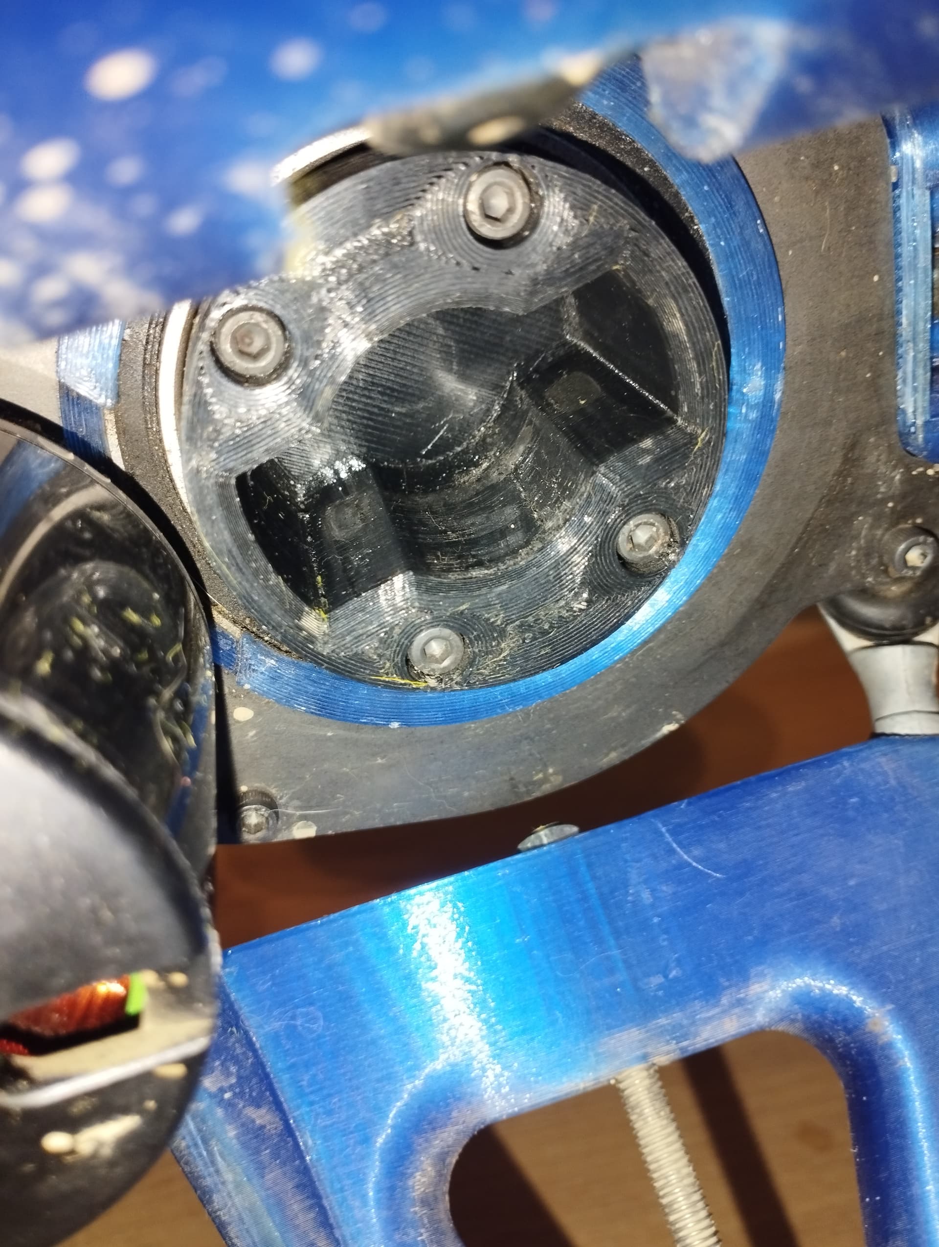

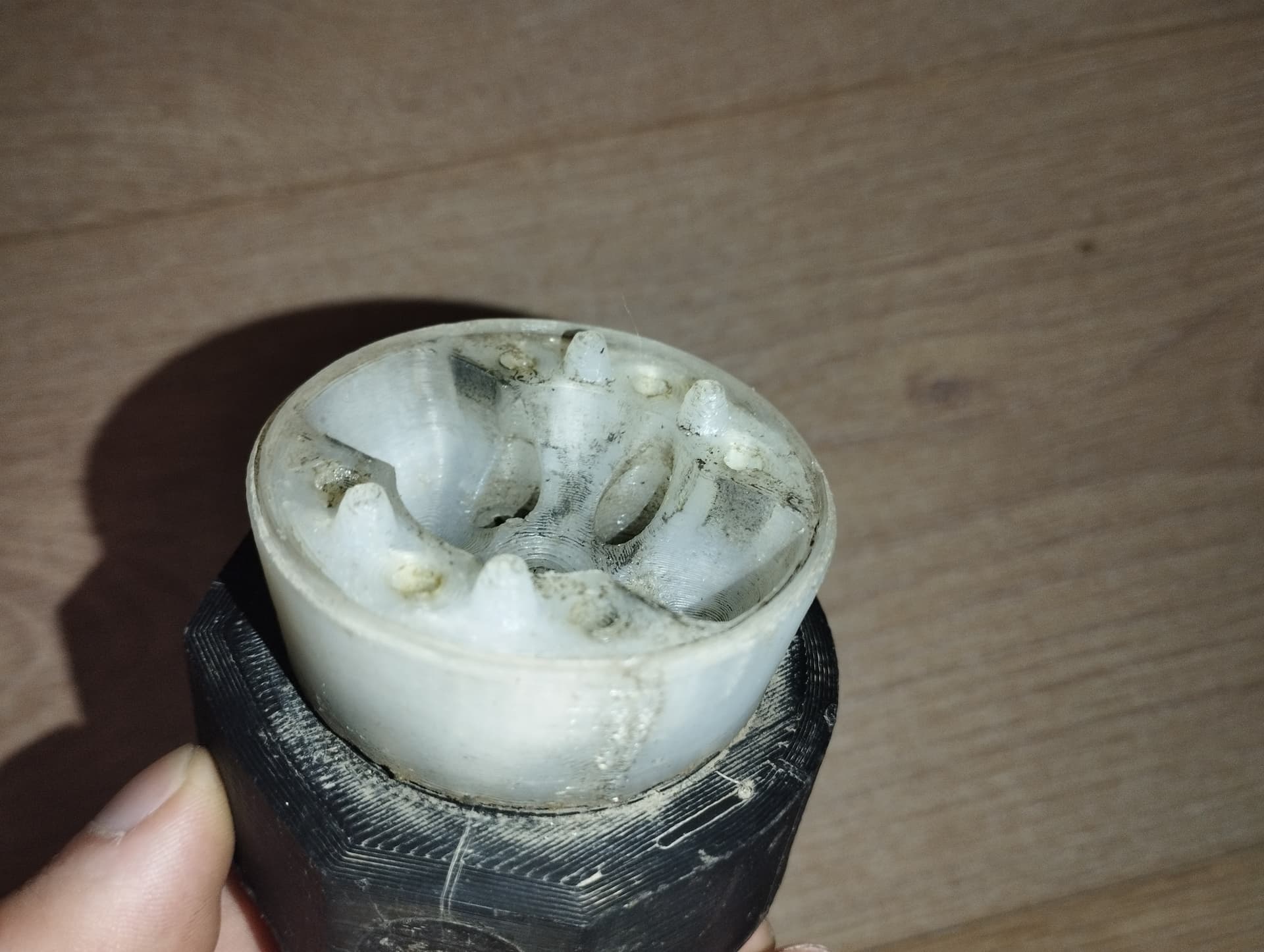

It turned out to be a very interesting story about the lubricant for polyamide. I was surprised by its friction properties. There were three places which require lubrication.
Gears in reducer (here you can see a little bit of lithol, which was squeezed out from the teeth onto the center part of the gear):
Inner constant velocity cup (I’m not sure if I’m using the right name). After about 300 km looks like:
And outer constant velocity cup after 1500 km:
I used Lithol for the gears simply because I already had it. I don’t think there are any extreme conditions in the skate gearbox (very high temperature, for example), so I didn’t bother with the choice of lubricant. The small gear in the gearbox is printed from polyamide-12, and the large one is made of PETG, which melts at 60 degrees. So far, it has not melted yet, although I have not skated in hot weather (above 25 degrees Celsius). Maybe I’ll look for another lubricant if the gearbox will melt or break.
For inner and outer CV cup I was going to use lithol too, but I couldn’t find the suitable “protective boots” (that’s what they seem to be called) to protect them from dirt sticking. So, for now, I’ve left them without any lube at all. Inner CV cup is made of PETG, outer is made completely from PA-12. PETG CV cup brokes down after 500-700 km, but PA-12 cup looks great even after 1500 km, there is no visible wear on it, just a little dirt embedded in the layers of plastic. When I disassembled it, there was quite a lot of dirt, but it continued to work perfectly. I’m going to continue to leave them without lubrication, only to reprint the inner CV cup with PA-12.
