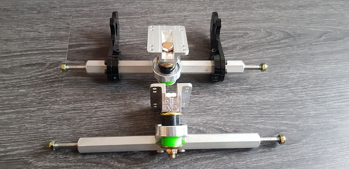

New fancy stuff for testing. We are really curious about what trucks will gonna make it to our production series. Big shout out to @Psychotiller and @klaus79856 thanks for supporting our project!
