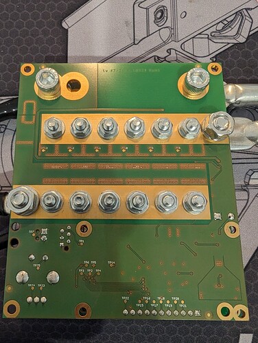

circuit board repair? Kweld to be specific.
So I made a bone head move and got distracted by something and I touched a meter probe to my kweld. I know I know, why is it not in a case, well I printed one but it was mirrored for some reason and I didn’t have any more filament so I was using it anyway, yep I’m a dummy and trashed a $250 machine.
The machine immediately turned off and will not come back on, I touched the prob somewhere in the bottom of the screen or the knob.
Is there anywhere I can send this for repair?

I cannot spot anything bad on the board, except for lots of debris. If some of that is metallic, then this can make you a bad day (or has already).
You can try to troubleshoot the board, maybe it is something simple:

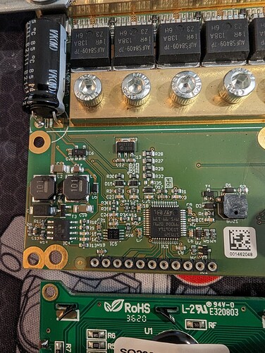

Thanks Frank, I really appreciate the tips on where to look, definitely my dumb ass that caused the bad day not the debris, I know for sure I touched the probe of my meter to somewhere in the area of the pins for the screen or the pins of the potentiometer, my son asked me for a screwdriver for his toy and I was careless with my hand when I was paying attention to him. Live and learn, expensive lesson though haha.
I have 10v across the capacitor
I do not have voltage across the left two pins on the lcd
The ic3 regulator does get warm
I did not find any other warm components

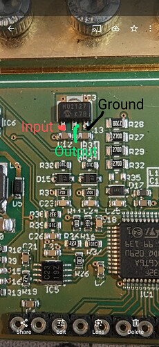

Am I correct in assuming that the pin on ic3 read as follows
I have 10v between pin one and three but less then one volt between pin two and three, which I assume should read 3.3v?
This leads me to believe that the ic3 regulator is bad?
Or ground in the center and output on right pin? Either way I should have 3.3v on pins two and three… I think
Yeah I’m pretty sure ground is center pin, not only do I not have 3.3v output, I have continuity between pin two and three which I also don’t believe should be so.
For anyone following along, I’ve learned that any short on the 3.3v net could create the issues seen at ic3, it could be a symptom, not the cause.
Another assumption on my part, is that since I shorted pins on the lcd (and see no physical damage externally) that are fed from the ic1 stm32f, and I have continuity between Vss And Vdd the short could be internal to ic1 thus renders the kweld irreparable, well I assume not cost efficient since I couldn’t replace the ic1 myself and I assume it would need programming even if I could.
Again a lot of assumptions, or deductions, lol
Is there a way to check resistance to isolate the short either before or after or to the ic1 itself to rule that out or confirm without removing it?
I believe I looked at the diagram correctly, Vss and Vdd 2&3 are shorted but Vss_1 and Vdd_1 are not on my chip
Again all assumptions on my part, I have no idea what I’m doing lol
:crossed_fingers: :heart:
For anyone who’s was following along, the consensus is that I fried the chip, and even if I could replace it, wouldn’t be able to program it. The vendor, grid rewired in Canada was great and sold me just the board and saved me a good chunk of money to get up and running again.
