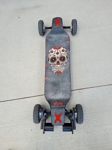

Yes yes, Y’all! I finally finished a build that I’m proud enough to post here. After the untimely death of the Namaskate Build due to dirty, rotten thievery, I quickly moved forward on this build that I’d been collecting parts for over the course of the last year.
The name “Chumbalaka” is taken from a Mexican children’s song about Dancing Skeletons and “Dia de Las Muertos” aka “Day of the Dead” that my kids were obsessed with for years. In spanish it’s actually gibberish and means nothing (kinda like supercalifragilisticexpialodocious) but it’s catchy as hell and I’ve found myself on more than one occasion singing this song under my breath.
Its a bop
💀 Las Calaveras 💀 Salen De Su Tumba, CHUMBALA CACHUMBALA - Canciones Infantiles de Halloween - YouTube
I’ve long had a fixation on Sugar Skulls and the traditions surrounding the DOTD to to point where I have artwork around my house and even some ink on my body celebrating these colourful little guys. It follows that it was a no brainer to choose this design that @Sender had on hand after getting the board and enclosure shipped to Alabama from Peru. Thx to @eBoosted for hooking me up with his always stellar work as well.
When Tim first sent me a pic of the finished product I was blown away and knew this board would be a head turner and something special.
Chumbalaka

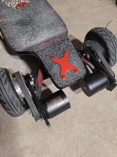

For the Drivetrain, the original plan was to keep this board in the realm of Thane as I was somewhat skeptical of Pneumatics bc of flats, balancing etc… Accordingly, I purchased a gear drive from @Boardnamics and 220s and found a set of 120mm Clouds here. About a month ago, I tried 8" knobby tires on Mountainboard setup and knew I could never go back to Thane. That and some parts issues quickly lead me to shift the drivetrain to a set of @Psychotiller hubs on Clevers that I’d acquired half a yr ago for a future build. These were paired w a set of precision pulleys made by @Savage1 for a few of us in a small batch. These things are bloody gorgeous, folks. Phil, your work is top shelf, homie. I had to throw these on some BN 270s as the axles on the 220s were too short. This is paired with Caliber base plates, Riptide bushings and pivot cups and Flipsky 170KV 6374 battle-harded motors prchased from @Anubis. Ratio is 3:1 on BN XL Mounts. I’m presently running these without idlers.
Bench Test
Constructed drivetrain

The Controller is a Xenith V2.1 from @BuildKitBoards. I extended the phase wires so that they would sit outside my enclosure right from the pcb to avoid adding any resistance in the phase circuit. In order to route these wires through the enclosure I used a gromet mounted to the enclosure. In hindsight, I grossly overestimated the needed length and the extra length is taking up valuable real estate but wtv. Will correct at a later date.
Hole was made w a step drill bit. I dropped the gromet in boiling water prior to jamming it in there (thx for the tip @glyphiks). Super glue and silicone have sealed the edges and all the cables are routed through the same hole including sensor wires. These XL mounts are hella long. Traditional motor positions would’ve def made things easier but this is what I had on hand when I decided to change directions. Work with what cha got!

Century Drop 40 skinned by @Sender
Enclosure by @eBoosted
Xenith V2.1 Controller w DIY sink
12s4p P42a pack by moi
Sixshooter hubs with Clevers on BN270 hangers and pulleys by @Savage1
Caliber baseplates with Riptide bushings and cups
Hoyt Midnight Puck

Hol up, your rear truck is on backwards! Unless its intentional…? :rofl:
Siiick. Nice and clean. So, you prefer pneumies over thane now huh? What’re your reasons?
I was wondering if anyone was gonna notice that lol. It was on the right way by the time I took it for a test drive. I’m very bad spatially and didn’t notice until I stepped on the board to tune the bushings hahahaha
