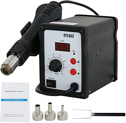

It’d still be very difficult to do, but it’d be possible to change it with just an iron.
Super-hard. But not impossible. Not with the hole there.
I had to change a blown DRV IC on a VESC recently, so I bought a hot air station from Amazon for $38. It worked great. I definitely recommend getting one.
If I had a 300$ or whatever they cost unity or whatnot with a blown drv, I’d definitely buy one for 40$. But for a cheaper vesc if I could use my iron and just pay for the chip, fantastic.
I think you’re discounting the fact that chicks really dig a guy with a hot air rework station. :grin:
