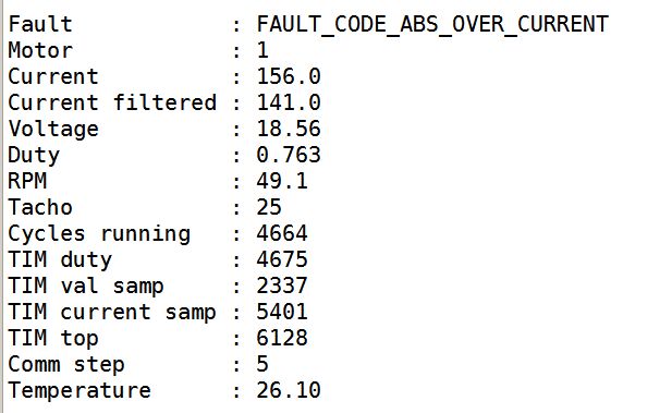

I took the mountain board back out today. I was curious to see if this problem would happen again. It did, but more so. I tried disconnecting power for about 20 seconds, and that didn’t help. So I let it sit for a bit more than 10 minutes (with it powered, but not touching the throttle). That didn’t help. So I unplugged it and gave it another 10 minutes. That got me back on the road for about 3 more minutes before it failed again. After this next failure nothing will make it go again.
A couple of weird things… I’m using 2 v0.9 CFOC2’s connected by canbus. The master is the one that fails and gives faults. The slave keeps working - kind of. I can spin the motor, but it won’t produce enough torque even to let me crawl home (I have run the board on a single motor before and it normally has plenty of torque for that - but not when this problem occurs).
So the slave wheel will turn, but not with enough torque to do anything. It also behaves weird. If I give it throttle, it will spin, but it won’t stop or brake immediately if I release the throttle or apply brake. There’s what feels like a 1 second delay. I was wondering if that’s the fail-safe timeout kicking in. I also wondered whether the slave one behaving badly was due to having traction control enabled (though I can’t recall whether I actually do). But that doesn’t seem right, because it presumably wouldn’t spin one wheel while the other isn’t turning. Dunno.
In any event here’s the current status…
  • The master controller won’t drive the motor.
  • The slave will spin the motor, but not with any torque.
  • If I power the master on and check for faults, I find none.
  • But if I power it on, hit the throttle, and then check for faults, I reliably get an over-current fault - even though the motor never even spun. I wondered if it’s possible the motor itself, or problems with the power wire connections or Hall wire connections could cause the over-current faults. I could try swapping motors and controllers, to see if that makes a difference.
But whatever it is, it’s gotten much worse, so it kind of seems like a component that’s either failing or coming unsoldered. Anyone like this theory? Any idea which component would be the most likely culprit?
Here’s one of the fault dumps…
after reset and hit throttle - bottom
Two bizarre things here…
  • It shows 156 A, but it never even spun the motor. The motor doesn’t feel as if it has a short, but I suppose it could.
  • The report indicates that this is “motor: 1”. But this is my master vesc, and I’ve specified that it’s VESC 0. Perhaps that’s different than the motor number(?)
Any insights would be greatly appreciated - even if it’s just to suggest which components I should likely replace.
Thanks!

I removed the offending CFOC2 and noticed it had a fair bit of grime on it from road and trails. Because of the bizarre nature of the problem (complaining of pulling 175A when I’m tooling along a level road), I wondered if maybe some of that grime might be partially shorting one of the sensor pins. So I gave it a good cleaning with a toothbrush and alcohol.
It’s too early to say, but so far (about 10 minutes of riding) it’s acting OK.

Further update…
I took the board around the neighborhood yesterday for about 20 mins and it worked perfectly.
I took it on the trails today and the controller died again and currently remains dead. Still don’t know why it’s getting outrageous over-current faults. :frowning:
You can easly make it up in fusion360 from files provided in github and cut it out of 1mm plastic that you can find on bookkeeping covers, wanted to get on road quicker before winter starts so I opted for fishpaper and conformal coating on top instead. Will make one eventually if youre interested.
Hard to say straight away whats the issue, but things I would check.
1.Basics, recheck vesc settings and compare it to batt ones.
1.1Did you did 10k resistor upgrade on the board to update it to 1.0
1.2Did you soldered 220n capacitor on the on/off switch?
2.Check wiering on CFOC, for any small loose wires that come from phasewires on the board (before putting it in case i managed to catch some stray ones.)
3.Before running it, did you you went over DRV solder joints on bottom and top?
4.When mounting it on heatsink was the board perfectly straight? In my instance I had to add 1mm washers on all of the bolts because my thermally conductive tape was a bit thicker than in tutorial.
If you can, post some pictures of the board, maybe there is some obviously bad solder joint
This thing has been working perfectly for a long time, so unlikely the settings.
Nope. I’m not aware of it, but I’d love to fix this thing if possible. I just now configured a couple of HW1.0 CFOC2’s for the board, but it would be great to have the HW0.9’s as backups.
Probably not. Was that an update?
Yeah - I think they’re pretty solid.
Yup.
I’ve gone over it pretty closely and haven’t seen anything, but maybe I can get a good pic and post it. Thanks.
