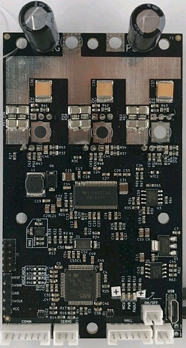

Thanks shaman for everything you did and made this open source. It is a thing of beauty :smiling_face_with_three_hearts: I have produced 5 pieces to make funwheels. Still have to receive them. This is a photo from the factory to ask everything is ok before the start post soldering. The capacitors Will be bend to save some space in the height.Hopefully everything works out with the bootloader :blush: With a fresh cashflow i will donate a small amount to you.
