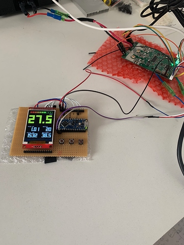

Still having trouble connecting to the uart. It would help alot if I could see some working code so I can double check what I am doing. Also if you have details of the arduino (wondering if 3.3v or 5v ttl on the serial is making a difference.). Good to know it should work if I get things right though.
Which version of firmware are you using?
My recollection is that the VESC is using 3.3V TTL, so in a perfect world you’d either use a 3.3V arduino or logic level shifters. But I think I recall that it’s actually relatively robust. I’m not talking directly to the arduino currently. I’m talking to a Bluetooth module on the board, and the paired Bluetooth module in my dashboard talks to the arduino.
I’m using slightly altered code from the davega OS and it’s working.
This is the code for it.
I’m using an arduino every so the rx/tx pins are 5V but the vesc has 5V tolerant pins on RX/TX.
