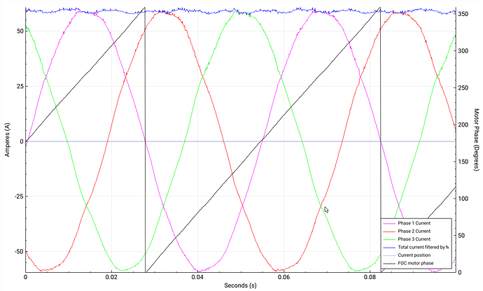

Looking pretty good so far under a locked-rotor load. I still get the OC faults when changing currents under load too quickly, I’ll try out a few other things to see if I can reduce their incidence. It does look like the DRV is losing its mind, I need to reset the CF2 when it throws the faults to get it to operate properly again. Perhaps it would be possible to retransmit the default settings whenever a fault code is sent, so even if it loses it’s settings it can return to operation properly.

I did not. I paid more attention to what shaman was saying about the DRV losing it’s memory values and reseting the CF2 every time I got a fault like the one above. Once I have a fault, the DRV will kinda-sorta operate for a little while after that, but with jerks and faults and other problems that will eventually lead to the failure of the DRV (ask me how I know). Considering this probably includes settings like gate drive current, I decided to try to test a bit more as is. That and I can’t find my 0603 passive assortment. Right now I can test up to about 70A, but I need to get these things permanently screwed down to a heatsink before I go too much farther.
I hope to have a decent oscilloscope in the near future, I’d like to know what exactly is causing the DRV to lose its mind so I can perhaps find a way to attenuate the noise somewhat. It’s clear that there’s some EMI problem - I’ve seen similar problems with micros in high dv/dt environments before, but I’m curious as to where it’s coming from.
Yes this is only happening at low rpm / high current. I found that with some motors like the KEDA 6364 the problem is much worse (low inducatance?). Other than that the Focers v2 are really running well. I did not manage to destroy a DRV chip on them so far.
