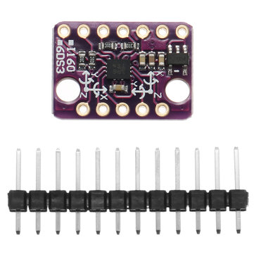

So this controller doesn’t have a built in IMU for balancing vehicles like the onewheel. However, there are GPIO pins routed to a header that you can plug a IMU eval board to. One like the BMI160 you can find cheap.

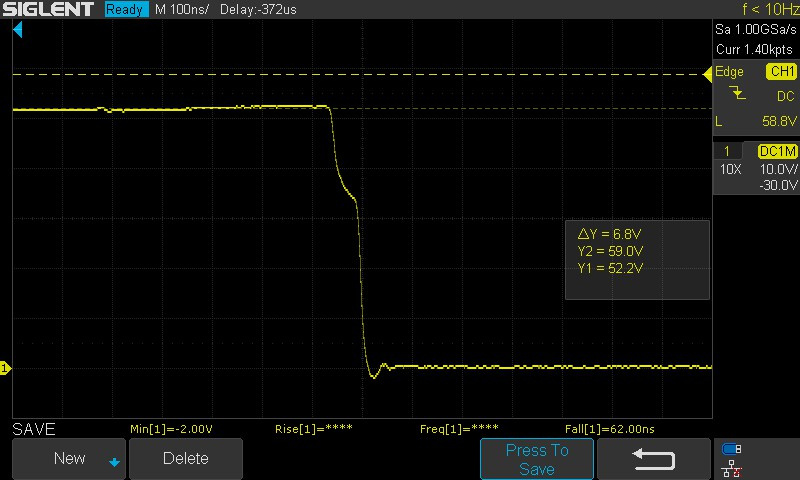

Rising edge (turn off) waveform FOC 50A at 50V

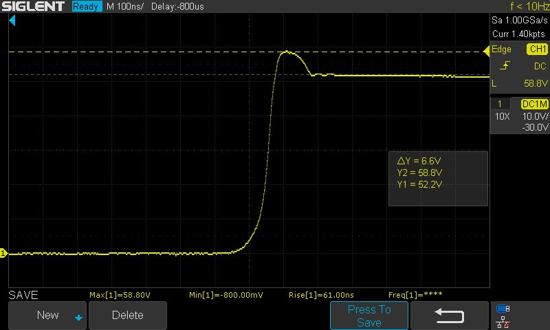

Falling edge (turn on) waveform FOC 50A at 50V
Ok so those that have been with me since the Cheap FOCer 1 has seen something like this before. These are the scope shots that show the turn on and turn off of the MOSFETs at each PWM pulse. The peak of the turn off waveform is the voltage spike that the controller experiences. You can see the spike is 58.8V when the battery voltage is about 50V(12s). This spike gets worse when current gets higher. This doesn’t leave much room at all to hit the 60V ceiling.
Now this isn’t bad in my opinion (only a 8V spike and very little oscillation) but there are some tricks I can do to calm that spike a bit. I’ll post some waveforms after I conduct said tricks to show the difference.

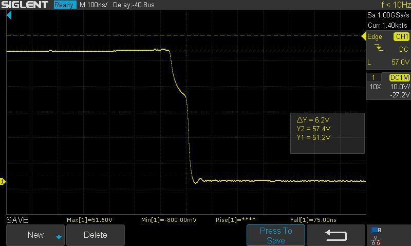

Turn off. 50A/50V FOC. Gate Resistor @ 20ohm

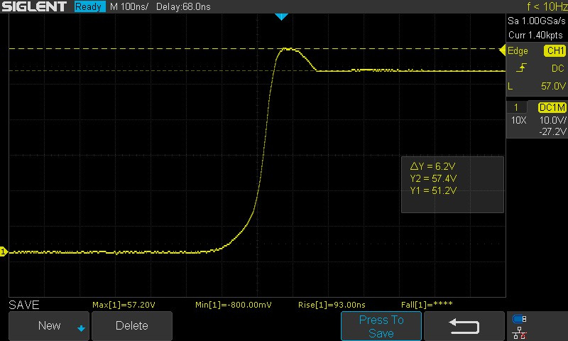

Turn on. 50A/50V FOC. Gate Resistor @ 20ohm

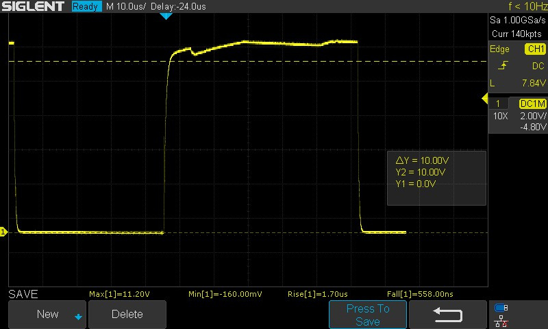

Gate waveform. Gate Resistor @ 20ohm
So I increased the gate resistor to 20ohm from 10ohm. It causes the rise time to slow down about 30ns and only slightly decrease the spike. Not the most gains in benefit but its a little bit. Still though even taking it up to 60A/50V FOC I never see spikes above what you see here. I’d say this is good enough for an open source design.
