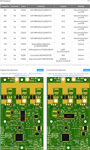

Ordered 10, they just went through DFM and the rotation for various parts was corrected as stated in the github :slight_smile: .
