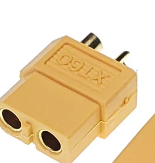

Just to make sure before you go and make any errors, the battery should probably have a male XT30 on the charge port, not a female. Are you sure you’ve got the genders correct? Male connectors have pins, and female connectors have holes.
Can you clarify this for me as well, I was under the impression that the battery charge and discharge port should be terminated with female connectors, male connectors seem much more vulnerable to shorts.
They can be done either way, but I think typically manufacturers put “pins” on the power-receiving side and “holes” on the power-providing side. Of course you would just need to look at each battery to see how it’s made as it can be either way. But it seems to be common to misgender the connectors at first. Looking at them, it’s easy to think that the nylon housing that slides into the other one is the male side, but it’s not.

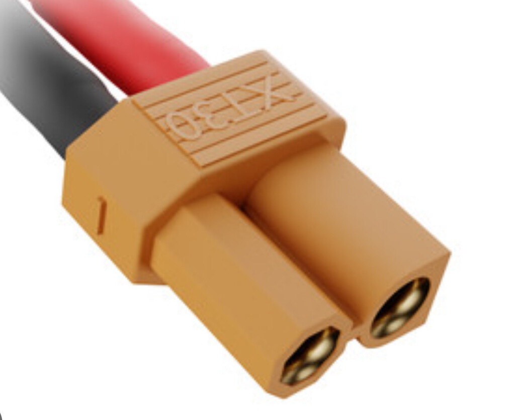

The batteries charge port is like this
The discharge port is like this
Got it, those are both female. Just checking.
