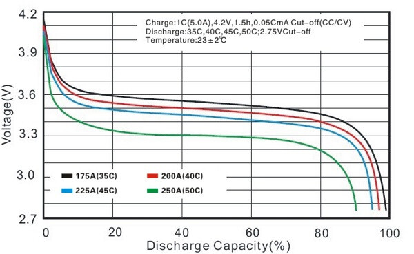

I don’t quite follow the math - why would 20% give you 40% less ride? Voltage drops very quickly from 100% to more or less steady state, where it drops relatively linearly until it falls off the cliff near the end. If anything the last 20% should give you way less than 20% since it’s nonlinear, not 40%.
Random representative lithium battery curve, but it holds mostly similar for the batteries we use

40% is just a number, it depends on too much variables and would be more or less 34%.
Cute little graph btw.
I don’t feel like doing the whole math for you but i’ll still try to explain because that graph doesn’t represent power that you need to move’‘Watts’’ and i think it’s data is way out on the 4.2v to 3.6v range. Just test the voltage on your boards after 10% of your usual riding range, it will not be 3.6 like stated in your graph. it will be more like 4v and over. Please test to see for yourself and come back with your graph.:slight_smile:
Normal operating li-ion battery voltage is 4.2v to 3v. Your ‘‘3v’’ is more or less 3.2v depending on voltage sag and if you have a bms for discharge or not (battery will cut out if it hits your desired level to protect batteries, It doesn’t apply if you bypass discharge because it will go a little lower).
So REAL life usage would be between 4.2 to 3.2v
If you charge to 80%, you would get what? 4v? 4v to 3.2v (usable range)
Let’s say you want to ride at 35mph the whole ride, you will need an equal amount of watts to keep that speed. Let’s say ‘‘42watts’’ gives you that speed, you’ll only need to draw 10a amps at the beginning (4.2v) (Voltage x amperage = Watts) and that amount of amps drawn will increase exponentially until you get to 13a at 3.2v. If your battery is not at 4.2v and is at 4, you will use 10.5a instead of 10a so 5% less right of the bat. Your graph shows a steady amount of amps, that’s not reality (unless you have a slow board and floor it the whole way).
